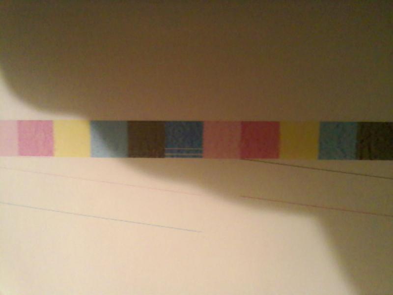

Here is the picture of the nozzle test. Any reason there is 2 lines in the cyan?
Thanks for the help everyone.
Those lines are nozzles that are not firing. This is normal, just invoke a cleaning cycle or two and the nozzles will come back.
As to your original problem, that's pretty far gone even for a profile discrepancy. Not that it couldn't be a profile issue but I'd suspect there's something else going on. What format is the image? What are your rendering intents?
There's a lot of variables for you to screw up in Production Manager, too many to list. You might consider posting screen shots of the PM Advanced and Printer Controls tab as well as any germane auxiliary dialogs in order to show just what you're doing.

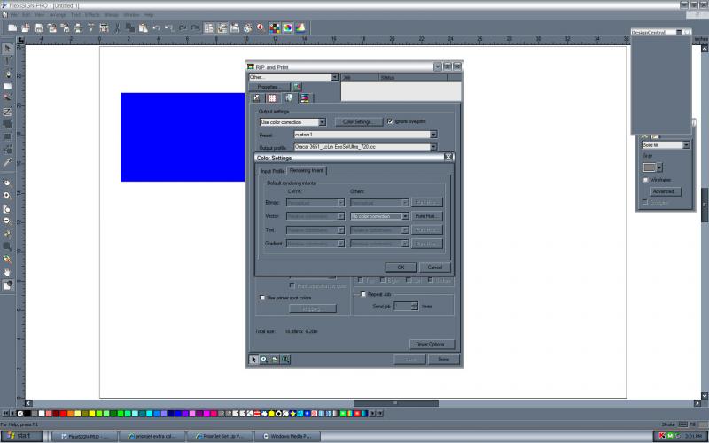

The image is jpeg made in Photoshop. Created 300 dpi.
Below is I believe what you are asking for.
I thank you for your help, it is greatly appreciated.

randya
You want to pick a Preset.
Not just a media or an icc, but a Preset, which will have all your color management info included.
bob
If you don't have color correction turned on, as in your picture, whatever profile you're using is pretty much rendered moot.
Turn on color correction and set your rendering intents to "No Color Correction" for everything except bitmaps. Set bitmaps to "Perceptual".
I'm not sure how your particular printer/Flexi combination deals with microdots, but make sure that "Microdot" is enabled.
See if that doesn't make a difference.

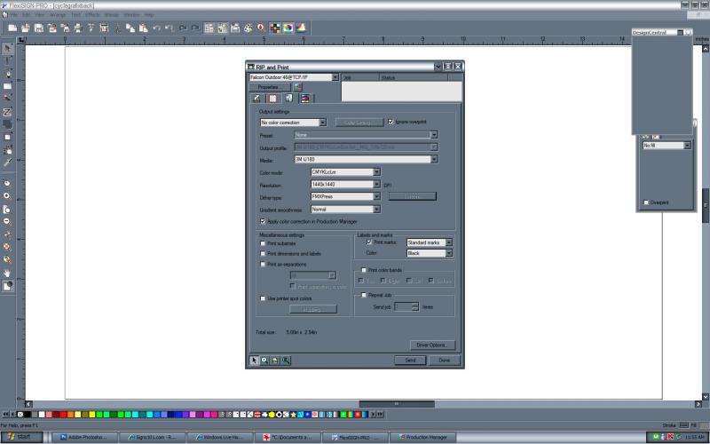

laserman70
I followed everything except the rendering. It wont let me choose any drop down boxes accept others: vector.
The video controls are different than the ones we have in flexi, that is why we are confused. sorry for making this difficult, we appreciat your help.

bob
Interesting. You should be able to change all of your rendering intents. Perhaps the preset you've chosen somehow precludes this. If so, find another preset. You really do want no color correction on everything except bitmaps. For bitmaps you really do want 'Perceptual".
Are you coming out of Flexi RIP and Print or loading your file directly into Production Manager? If you're coming out of RIP and Print, try setting the rendering intents there. What are the rendering intents on your default job settings in Production Manager?
