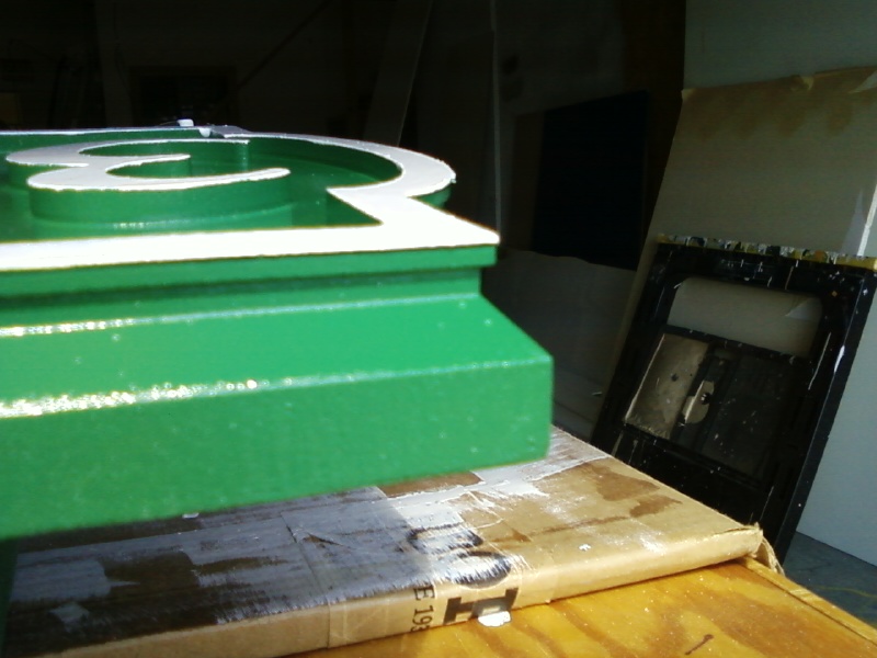

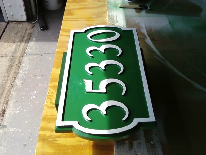

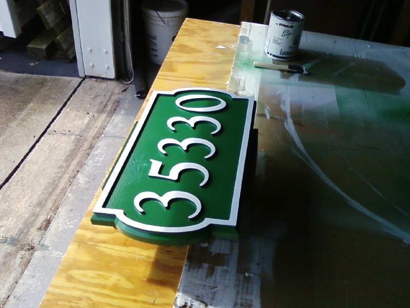

Here is a simple routed 911 sign I just finished routed on our Dimension 200.
9"hX18"w, 1" HDU, with a clean out of 1/4", bordered, with a bevel cut on the outside. Primed with Zinsser block spray primer, sprayed Rustolium gloss meadow green, and hand did the white raised lettering and border with one shot white. (I can hear the "gasps" from here)
the beveled edge, that created a shelf under the border, I did by accident...chalk it up to something new I learned to do (fine time to learn it). It was done by using a 1/2" V bit that cut to a depth of .5" into the material (I plunged it too far) and it ended up like that. Clean out and numbers done with a 1/4" bit, and same with the final cut.
Simple and quick.

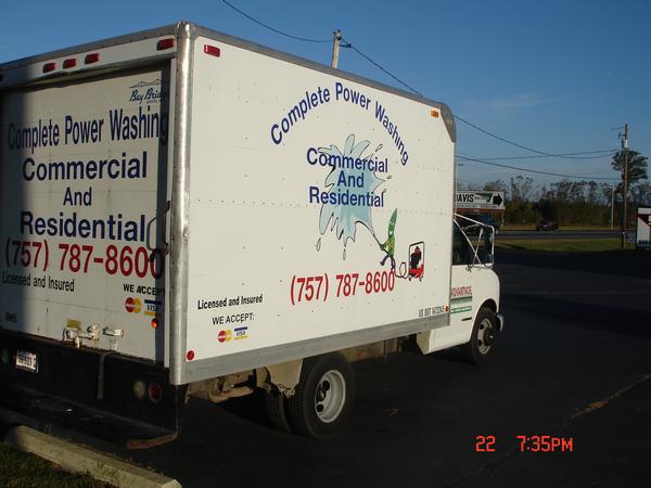

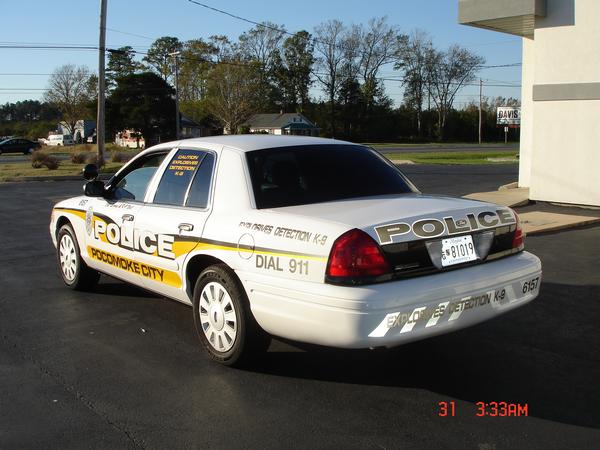

Another thing that's been hurting IMHO is our pricing has been in the low-baller territory. For example the first attachment is a 12ft box truck with Edge printed graphics and Oracal vinyl, the owner was charged $495 for (originally charged $595, but he B&M'ed over it because he thought the sides were going to be bigger even though he signed off). The second was approx $600-$800 ea. (we did 4 of them)and it's all 280i reflective, with Edge printed on 280i.
Neither had layout or design time added in the bill (since I've been here no one has paid design time). and the police car was a PIA because of all the tweaks the customer wanted to put in it (the design was originally on a Dodge Charger).
