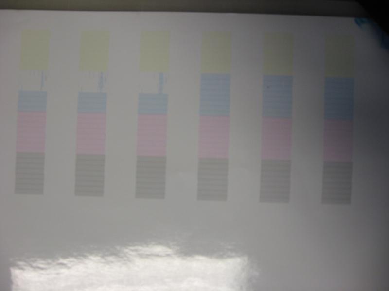

Did my morning routine this morning cleaning, nozzle wash, test draw and I got some shotty results.
1 Half of the cyan head is acting up. I have run "strong" cleaning, I have run Ink Fill Ups and I have done a "hard suction" from the back where the pump is.
After I run the hard suction, it seems like the first test draw comes out fine. A few missing nozzles. So I ran another cleaning on strong, and then I run another test draw and it gets worse from there.
The Image is after I have done hard suctions and strong cleanings. Then test draws.They are test draw one after another to see how bad it gets. And its the same thing. Hard suction, test draw comes out fine. Another test draw and it gets worse. (except in this picture I don't have one of the good ones on there.)
Any thoughts?

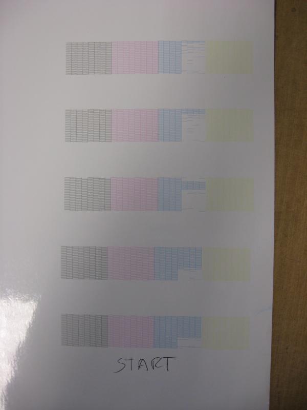

WrapperX
Ok - so I just ran another Hard Suction (from the back tubes by the pump) and then printed a test draw. Looked descent. Ran another one, still good. Ran yet a third one - still descent. Ran a NORMAL cleaning and then ran the test draw again - GARBAGE!!
Please any help would be great!

half a head is suspect. i'd pull some ink from each damper and see if there is a difference in resistance first (take note if the dampers relax after vacuum or stay concave. concave means you have too much negative pressure in the line. the lines have slight positive pressure).
after that, maybe rotate some captops. it's possible that your captop is not getting decent seal along that side.
lastly, maybe the screen in that head adapter nipple is clogged?

yeah. pull directly from the bottom of the damper. if it stays caved in over a minute, that is a bad sign. also, as far as suspect carts, i'd swap cyan carts and see if the issue switches to the other cyan line. or for that matter swap cyan damper positions and see if the issue jumps to the other side of the head.
it's most likely,
to isolate:
bad cart (swap cart positions)
leaning cap (swap or straighten cap tops)
bad damper (swap cyan damper positions)
clogged line (pull ink directly from line w/out damper installed, feel for resistance)
clogged piercing nipple (to the cart. the only way to clear this is a backwards flush)
artbot
the negative pressure is usually because of clogged line or bad cart (collapsed end seal or something). get a refillable cart, fill it with acetone or cleaning solution. pull and push the solvent back and forth between the syringe (damper off) and cart. you'll hear bubbles each time you evacuate the solvent back into the cart. upon the syringe pull that you seem to suddenly get a lot of flow, that is a sign that the line is clear. i once had a chip of a cart seal lodged in my piercing nipple and it was stuck lobster trap style. the only way i got it out was reversing the flow back into the cart. i wasted yards and yards of media (pet film) and changed everything on that stupid printer to only find out that it was some tiny little clog.

Thanks all for the advice. I think we have isolated the problem to be the Print head Manifold/adapter that acts as a secondary filter to the damper. The part has been ordered and hopefully we get it by tomorrow.
Thanks Artbot for all the help/advice/assistance in getting to the root of the problem!!

The latest update is that the Print Head Manifold replacement did not change the situation. Got a hold of our personal Tech (thank god) After telling him the issue with Nazdar/Lyson. He gave me a couple of things to try and he also suggested we talk to Nazdar and ask them what to do. After talking to them, they have agreed with us that the "bad inks" that they had go out and that we got have cause damage to our print. They have sent out a replacement head at their expense.
Yes we changed cartridges, we changed dampers, swapped dampers, just recently replaced capping station. All in all, it looks like Nazdar is taking this one. Thank goodness!

this picture look 4 head
each head for one color.
your cyan head have 2 nozle(right left)
left nozel work <== captop is good working
right nozle ink not keep through because your damper not good.
so replace right side damper or took out and clean.
dyebae ink, solvent ink printer all same. I mean epson head sucks....
but dont have choice...
ink ==> line==>damper==>head==>captop==>pump. stupid processing......
