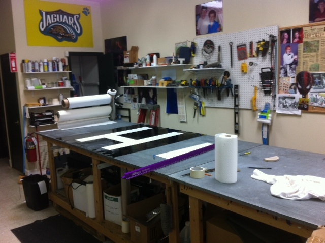

I have galvanized metal table tops broke into panfaces to cover edges of 3/4" particle board tops., you can cut, paint, saw, drill whatever. Magnets are a breeze on it. Have had them for years.
