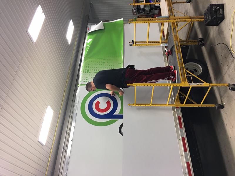

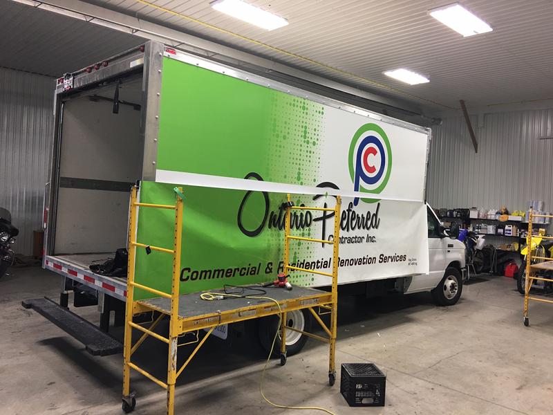

Just finished this project. Design, print (HP L330) and install.
My first full coverage boxtruck. Decided to do horizontal seem to minimize number of seems.
I know I should have done bottom one first not to have seem open on top, but I used edge seal tape (half width) to close the seam for water not to get under the vinyl.
Like the look, customer is very happy with it and how it looks.

one little thing do, you are supposed to do the lower panel first then the top panel, so water doesn't accumulate on the seam other than that it looks great

Looks good, I agree that the overlap needs to be facing down.
the OP addresses this fact in their post and what they did to fix it.

Looks good.
Horizontal seam not a real big deal when there aren't rivets to deal with.
If that truck had rivets you would find out quickly that would be a bad idea, lol.

Thanks guys.
Yes on the seam, realized that it needs to face down. I think use of the edge seal tape will take care of the issue.
For some reason it just seamed to me easier to install the top first and use the edge seal tape to cover the seam.

Reminds me of OCP logo
WOW, just searched for it. Pretty much the same idea.
Someone also told me it reminds them on Cubs logo. Which it does a bit, but not really my intention, not a baseball fan nor did I take that logo as an inspiration.
With so many logos around, there must be something similar :)
