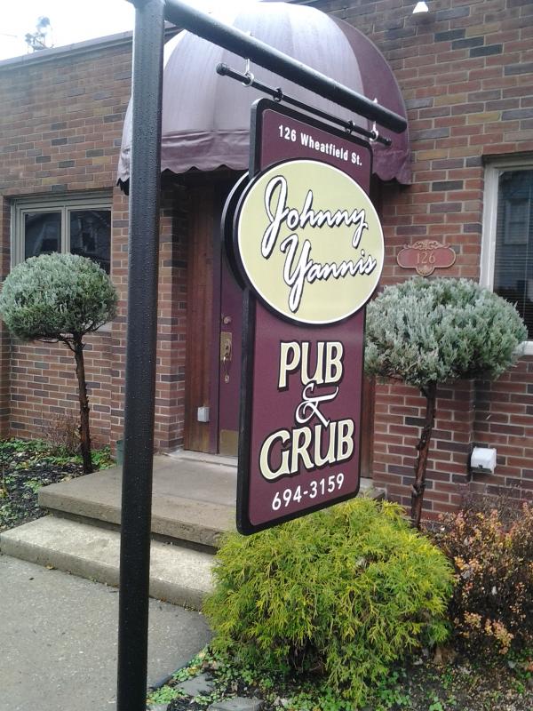

I started out hating the color scheme and design, but it grew on me. customer gave me the pub name and two colors. the black post was existing.
3/4" MDO with 1/4" value bond glued to the face of the plywood and the ovals cut out of value bond and glued/screwed.

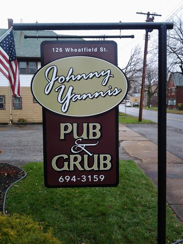

I'm thinkin if the Johnny Yanni text was the same purple color fill..it would be better...nice job!

I would disagree Ken.... I like it just the way it is.

Yeah..from ten feet away..it's OK...from across the street?
That's what I mean ...Signs That Work !

I disagree too. I think it looks great as is. Nice job!
PUB & GRUB is the important part of that sign. It is what stands out.

Value Bond? Is that like dibond? And is that layered....mdo - VB - mdo -VB?
yea, value bond is pretty much identical to dibond, but much cheaper, $50 for 1/8" 4x8 and $90 for a 1/4" 4x8.
1/4" valubond sandwiching the MDO, the ovals are double thickness, all cut at once so they match. first oval was screwed onto the sign, second one was banner-taped and PE glued. this gave the oval some thickness and nice way to hine the screws.
as far as visibility, this pub is on a small side street, the sign is an after thought, this is a true pub, anyone going here already knows the place...

Is the sign painted or digitally printed?
ddarlak
Go Bills!
burgundy is paint, the oval has oracal 751 black, then a printed 3M, i can remember the series for the green oval.
the black outline/drop shadow on the pub/grub is 751, the green/white is printed. then the ampersand is 751 over the top
