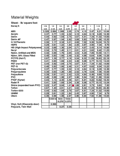

a 4' x 8' x 12mm sheet weighs about 60 pounds. I think I would use some short screws on the backside along with glue or high bond tape to make sure the cleats are secure. the screws alos might help take some of the weight
