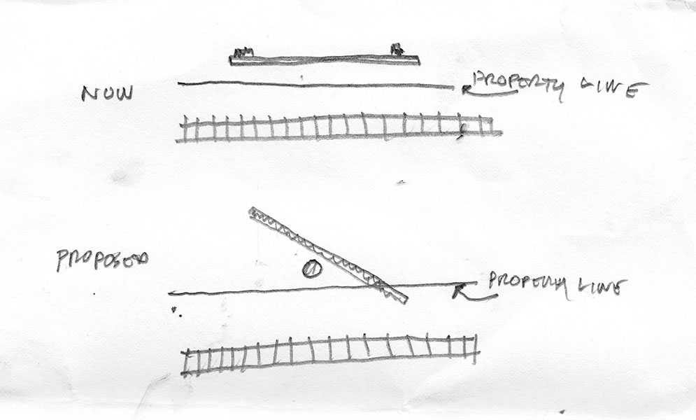

Hey everyone, not sure if this belongs here but here it goes anyway, please let me know if I should move it. I am working on quoting a job that currently has two decent size billboards in place. Both are older and need to be removed, this isn't a problem as I can rent a lull and lower them down (25' tall and one 20' tall) They are both basically two I-beams with a sign frame between them. The client wants to angle a new sign so that you can see it from the direction of traffic. My problem is I have no idea where to find basically a custom single pole pylon sign that I can install, or pay an installer to put up. They don't want to do two post because the configuration will take up to much of their parking lot. I attached pictures of the old signs for reference. Any help would be great, they are in a hurry to get this project rolling.

Right now the sign is perpendicular to the property line. You put a single pole with a cabinet on it and turn it to face traffic it will be over the property line as drawing shows. Plus the permits, plans and railway permission on their right of way, and customer does not want his parking lot used up by sign.
