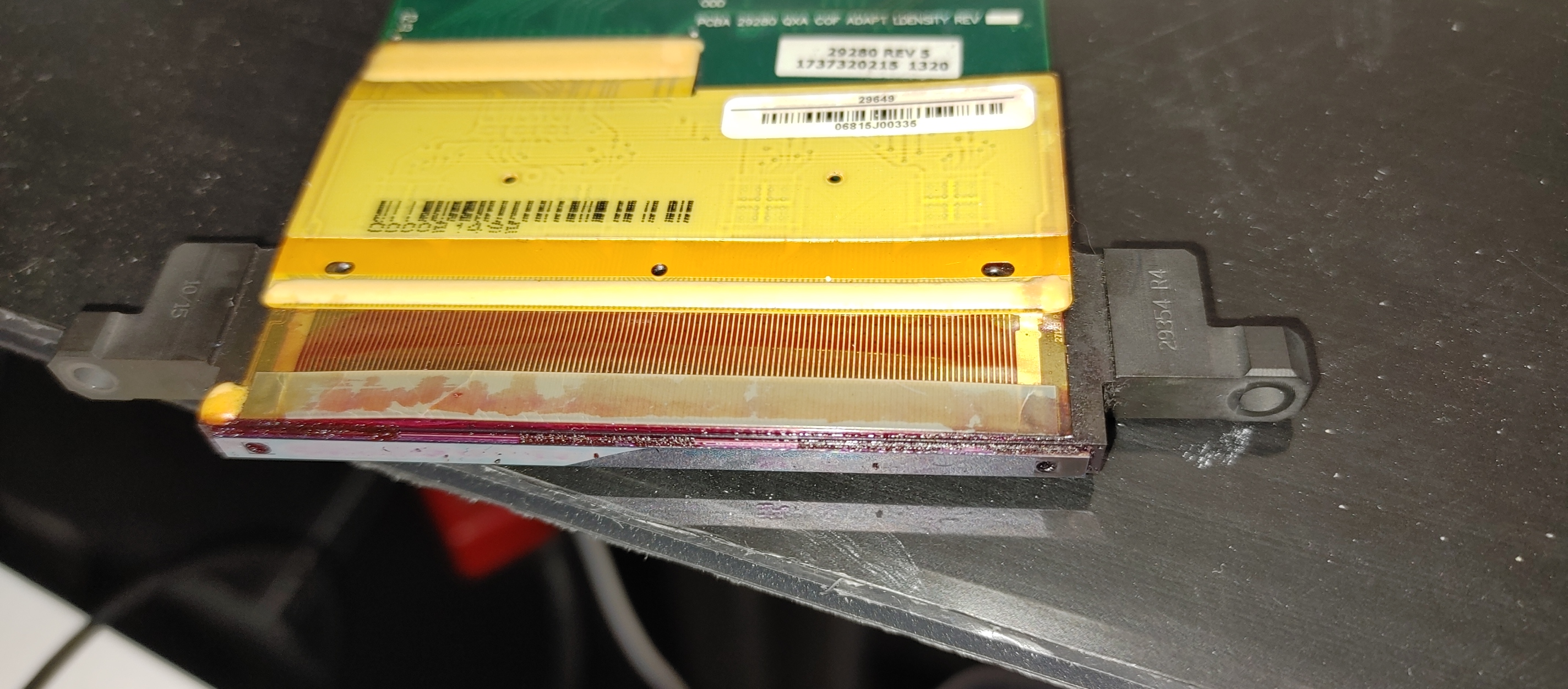

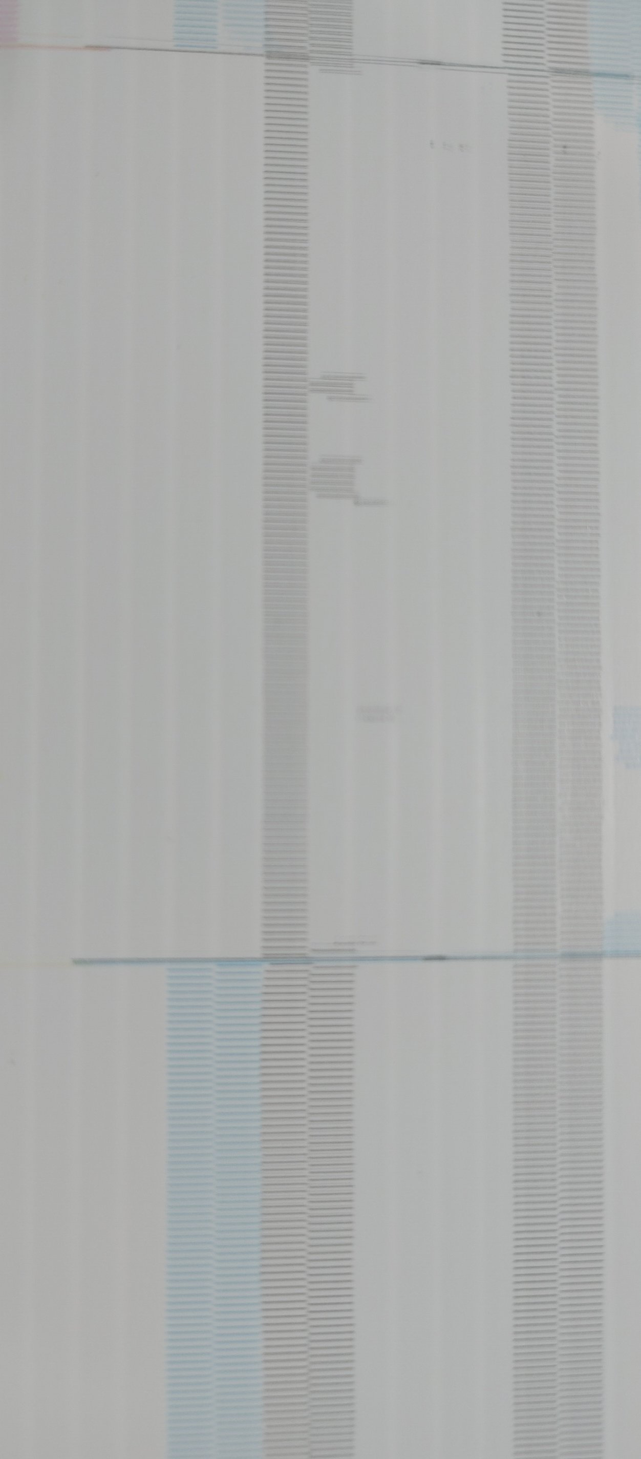

is somebody using print heads SAPPHIRE QSBP-256 ?
do you have some problems?
we have two problems one is with electronic of the head example half of the head vanishd because the electronics stop working and we dont know what is the reason.
second problem is that foil that is on side of the head it open when we do a purge so the head is not good any more.
please help we have a DURST p10-200
