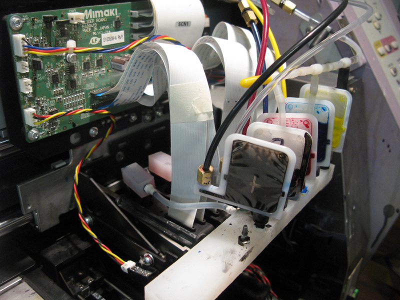

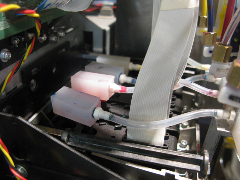

i liked the valves above the dampers. but in the end i didn't really get what i was going for with the printer. i really needed much more flexibility for what i do with the printer. i attached the most recent mod that i did to the printer. i really like it. i can do a "custody wash" of the heads in just about five minutes. since i rarely run color, i've just got filtered cleaning solution lines to the colored heads with check valves and in line filters.
my cmyk all come from the left side four carts. i built some custom f-style manifolds to split the single line color to the two head adapter nipples. leaving the right side four carts for different blends of clear varnish inks. as far as white and silver... that will be handled at the black head still but using an rc gas tank for a cartridge that will ride the carriage itself. there's really no need to fill an entire line with silver or what ever when i just need it for a small portion of a piece then back to black or clear. the left over "arm" at the left of the bulk head will hold that mini cart'.
