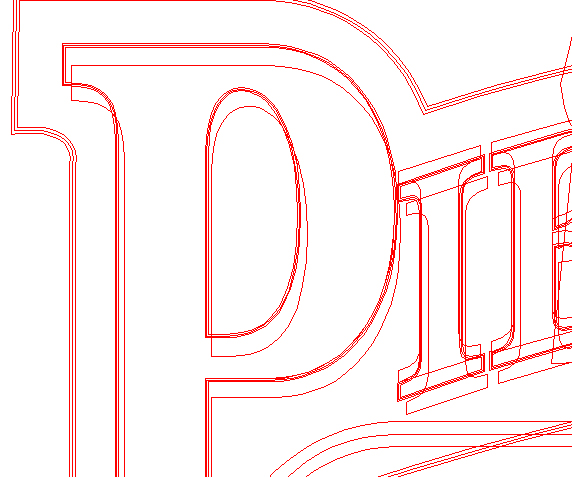

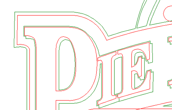

I get files from designers all the time that are just a pile of lines and a total mess to work with. in print, they may be able to hide the bones of the design but in the sign world not so much. attached is an Illy file from a customer showing a simple outline drop shadow combo. what a freaking mess. not only are there a ton of lines but also strokes all over the place. the other is from Omega where I had to make sense of the mess. my question is can the same be done in Illy? if so, what is it called? welding? connecting? when I get a file from a pro, I want to be able to request it from them as they seem never to do it.

Strokes really shouldn't be used when the wireframe of a design is important. Depending on the situation, welding, simplifying, even just offsets would be what I use, it just depends on what is trying to be accomplished in the final production. Those 3 that I mentioned work to setup a file for digitizing. All of those can be accomplished in Ai. You probably have someone that isn't used to designing for production other then digital (web etc) or print.

The STROKES have been converted to outlines before they sent it to you. It's standard procedure so that they don't get scaled or rendered incorrectly. But yes, it makes a bit of a mess to work with if you need to make adjustments later.

Everything wild west said. at our shop we used Ai, and its just a different process to designs for cut vinyl, silkscreen, or embroidery that unless someone is aware of the process and challenges, there is no way they could design for it properly. The first thing I would have done with that file is to outline the strokes, object>path>outline strokes, then used the "pathfinder" controls, window>pathfinder, to begin merging the necessary items.

thanks for the replies. I wanted to make sure that it was possible to set this up in Illy. this job will be back sprayed so it needs to be ready to have masks made and I sure couldn't do that with that mess.
