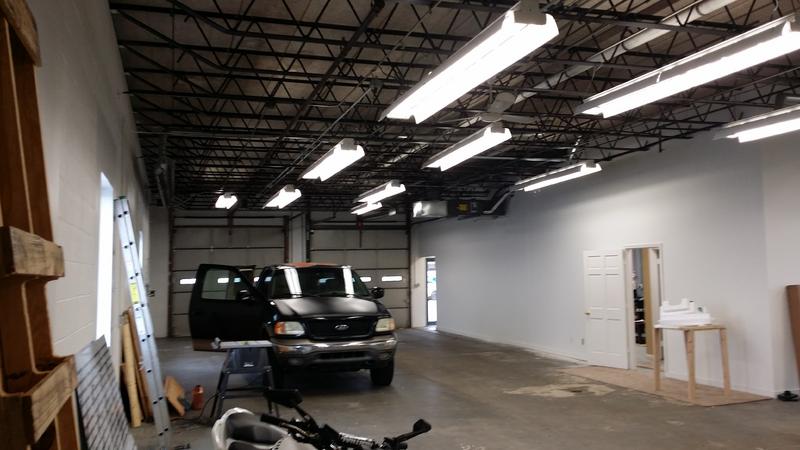

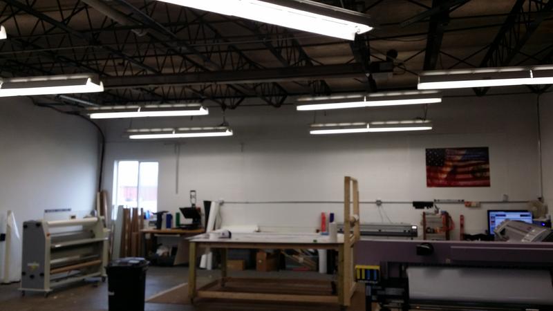

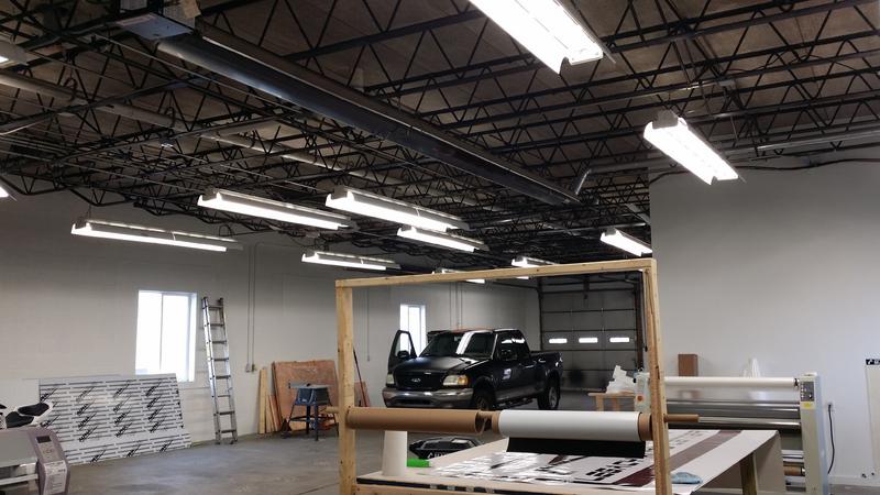

So, My shop has radiant heat, (2) heaters actually they are staggered apart to compensate for room, as you can see in the pics.. Now I have only been using (1) heater, the heater by the work area obviously. My heat bill was pretty big for keeping the thermostat at 60 degrees $325.00 thats high IMO..
In your experiences or knowledge would running them both be more cost effective or would it be the same or more.. I'm not sure I want to test the theory right now.
Or if you guys could think of an alternative way to heat of the work area that would be more affordable. I am 4 Months into the starting the company so money is tight and work is not high volume enough to compensate that much of a heating bill.. Thanks, I did think of using electric room heaters but wasn't sure that would actually help..

Heaters are generally put in with the best possible scenario when running them in tandem..... together like that. Using only one, makes the other one work much harder to get the necessary BTU's up to where you want it. Most of your heat is probably lingering at the top of your ceiling. In our shop, we have almost 18' ceilings in the front section. We've put R30 up there, netted it and installed ceiling fans for forcing the hot air back down. When we're up in our loft areas, I'll bet there's a 25º difference. After a few minutes up there, you're sweating your petunia off.
Get your gas/oil company in there to do a test. They have all kinds of neat tools to show you the efficiency of your present units. They'll try to talk you into something new, but our system in our shop is more than 60 years old and still works great. We keep our shop basically at 67º or 68º. We have zoned heating. The front office part gets around 70ish. We use a steam furnace. We heat with gas and it remains warm because long after the heat stops coming out, the pipes are still very hot giving off residual heat. Our shop is about 8,800 sq ft and last year was our coldest year ever in this shop..... and while we used it each and every day, our heating bill was still basically under $450 a month. This year is much less. Candace was in the back, usually in a tank top and not minding the cold at all. Once you go out in our garage area, then the temperature drops drastically. We have a torpedo heater for that area. 160,000 BTU kerosene cannon. You're hot within 10 minutes out there. That bay is 20' x 110'.

Like I said, your heat is coming out and going straight up. You do know..... heat rises ?? No matter how it's carried in, it goes straight up and sits up there and makes it warm for the bugs and sh!t. Are those cement blocks solid filled or basically hollow ?? Do you know how much cold comes in that way..... forcing your warm air up even faster ?? Other than our back outside wall, we have 18" thick solid brick walls around the entire building. Quite an 'R' factor right there. Our ceiling is about 14" thick. We have R30 in our entire shop except the garage bays. Putting up the R30 on the whole ceiling by a professional company was far-far cheaper than our doing it ourselves. I had a few friends who said we could knock it out in a weekend. Did the math, crunched the numbers and a professional company was about a 1/3 of what we could do it and that was not paying the four guys helping me. We put quite a bit into this place to prevent heat loss and it's paying off quite pleasantly as it's not hard to keep the place warm. We keep the heat at 55º at night. The timer comes on around 6:30 in the morning and runs pretty much all day as needed.
Again, our entire season last year was around $2,600, so some months were considerably less while I think the highest one was around $550 or almost $600., but then some were only $125. Average was $450. We start our heaters around the middle of November and turn them off around the end of April.

As mentioned several time already, the basic fact is HEAT raises and you have HIGH ceilings over your work area. The radiant heater is located up close to the ceiling, so the heat stay up there (as Gino said, nice and cozy for the bugs up there).
Have you heard the phrase "pay me now or pay me later", well you can either invest the money one time up-front to lower the ceiling and close off the work area keeping the heat in the work area, and not letting it drift out the install bay area, or just keep paying theses high heating bills that are only going to get bigger as winter is just starting, and is going to get much worse.
I believe in being PROACTIVE not REACTIVE, so if I were in your shoes, I would spend the money to install a suspended ceiling with insulation above it lowering the ceiling height to a lower height, and you should see a significant reduction in heating the work area, side note it will also be easier to cool in the summer.
You may have to lower the heater, but that kind of stuff is easy, just like installing the suspended celling, very easy DIY project and all the pieces are available at Home Depot or Lowe's. only special tool required is a laser level set up on a ladder in the center of the work area, about $50-$75.
