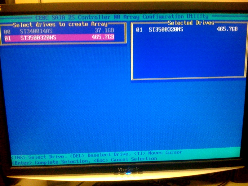

So I tried and I get this message:
"No Array can be created with the number of drives selected
Please review your drive selection."
I have the new drive selected when I choose create new array, I just don't think it'll let me create a one disk array.

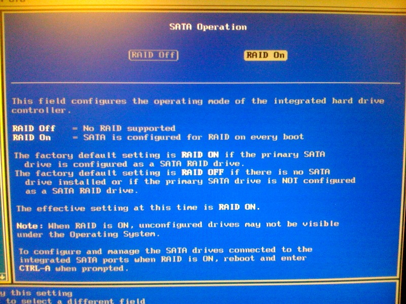

Just incase someone may have an idea I posted a photo of the BIOS screen that controls if RAID is on or off as well as a photo of the RAID control program.

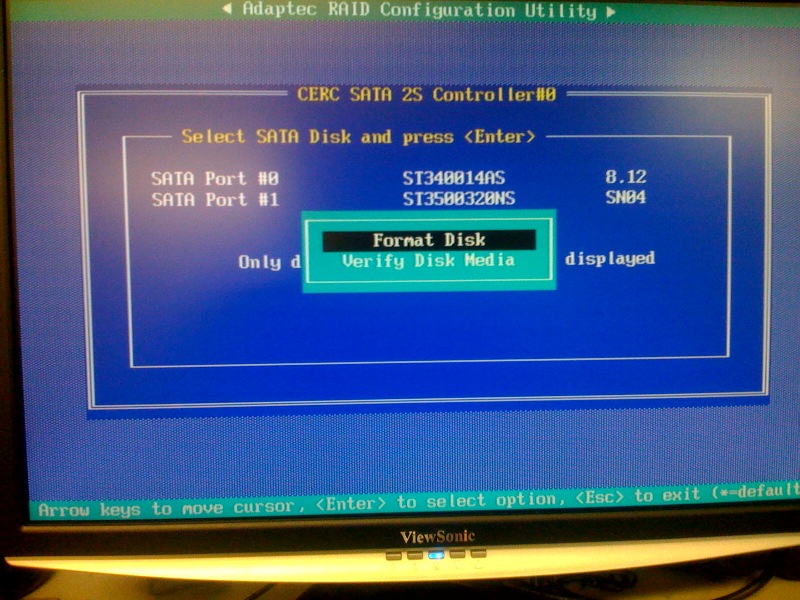

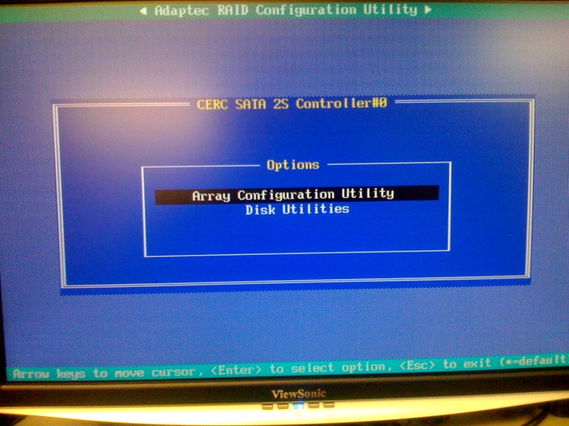

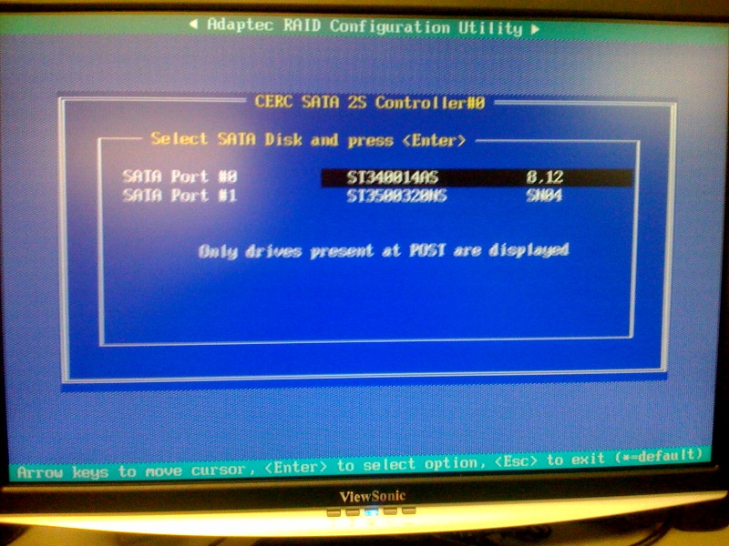

Casey... Attached is a photo of the first screen for the RAID controller. The second photo shows the first screen under disk utilities. The third photo shows my options in the disk utilities.

SignBurst PCs
Well there ya go. It would seem to me that you have to format that disk from the disk utilities page. Then it will show up in the OS.
Make sure that you format the right disk. SATA Port #1 (not #0).
The RAID screen told you that the disk wouldn't show up in the OS unless it was configured. Format it and it should be configured. It is a new drive right? No data yet. If so, then format it from the disk utilities screen.
