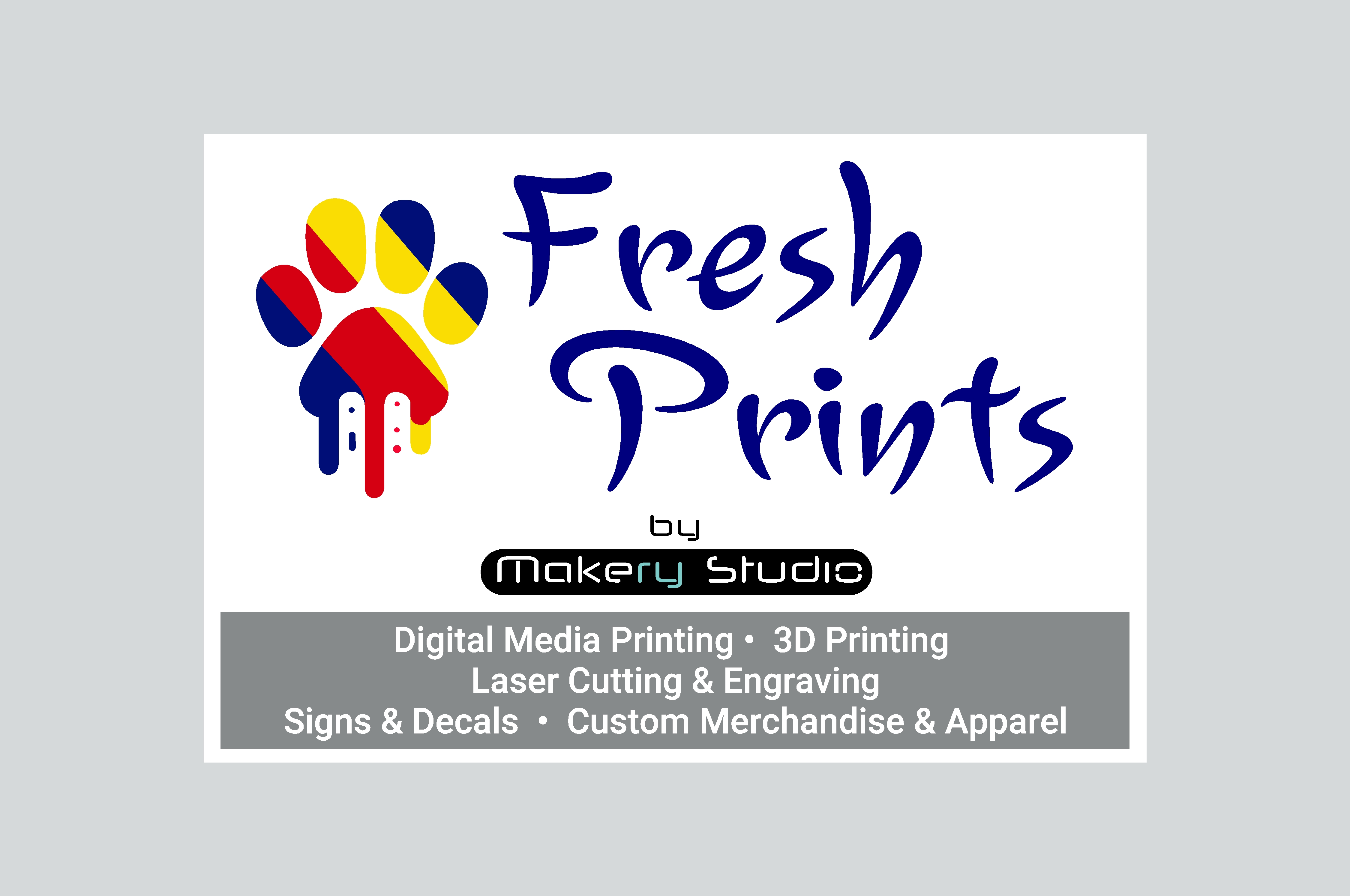

Since you want to learn:
First thing I see is a sign laid out like a business card with very little hierarchy. All the stuff in the teal section is the same height. When making a sign it must be set up to convey at a glance - too much info and that will not be successful. So you must have in mind what you want the viewer to see and what they will need - usually a phone number is more important than a wen address.
Second thing is the teal section has a lot of bubbles and and tunnels (almost wrinkles). This is likely because of squeegee technique - 3M calls for an advancement of 1/3 of the width of the squeegee per stroke. In reality 1/2 is plenty fine, but if you shoot for 1/3 you are more likely to lay the vinyl better and end up at a 1/2 anyway. The unlaid portion should be held such that it curves gently just ahead of touching the substrate and so that the squeegee applies it to the substrate - do not let it touch before the squeegee presses it down (wet application need not have this caution). Pay attention to how the vinyl feels in your hands as you lay it. After a bit of experience, you can ignore everything else and rely on the feel.
Lastly, remember that when a tunnel appears that can lead to wrinkles, and that what you are really doing is moving the air out from under it. The air needs somewhere to go! Tunnels can often be worked out by following them, but never by going across them as that causes adhesive to touch adhesive (once that happens you are done).
You asked, so we all responded. Keep in mind, the harsher comments likely were only given because you asked for comments. I think if you ignore the negative aspect of those you will see that even those contain advice from an experienced point of view.

Here's my take on it.
"Fresh Prints" should be all one color so it looks like it goes togeater. You need an entry point.. something that will grab the eye first. That's why I put Fresh Prints in a dark color and large. The bottom text is in a grey box (I know... another color) but any of the other colors were too bright and competed with the "fresh prints". They way I think it should go is "Fresh Prints", then makery studio draws you down to the finial element, the details. Don't want to overload a sign with phone numbers and websites.. put that on your front door in vinyl, along w/ business hours. If there is too much info on a sign, it becomes completely unreadable. You need an entry point and flow so the eye has somewhere to go. With the competing colors in the initial drawing, it's hard to figure out what to look at and it becomes chaotic.
I'm sure there are design snobs on here that can complain about what I drew.. but I spent 15 mins on it and maybe someone else will pitch in. The paw print looks like the head of a penis, but that's a bonus.

I totally dig the arrangement, and I appreciate talking me through the philosophy behind the design, how the principles were used and why. I understood the principle of flow before, but now understand how to actually utilize it through an entry point. Totally makes sense, and I can get behind the reduction in colors for that reasoning... though I battle with the desire to retain the vibrancy and "freshness" that came with the green and orange, so I'm going to have to think about that one a bit.
Not sure I'm willing to completely not have any contact info on there. I'm currently operating out of space in my home, so putting the info up on my doorway would not provide enough visibility. I'd be willing to sacrifice the wording "Custom Merchandise & Apparel" to be able to fit everything else on the first two lines, and then have the web address, shortened to freshprintsofbellecote.com on the final line.
I also REALLY like teal/cyan, hence why the ry part of Makery is that (my name is Ryan, aka Ry, and, well yeah, 2 + 2 = 4), so would it be blasphemy to use that instead of the grey?
BTW, I'm not requesting that YOU make those changes, just getting opinion on if I were to adapt it in these ways.

Tex's update looks a lot cleaner and balanced. Honestly, I'd drop Fresh Prints and the 'penis logo' all together and just use Makery Studio, making it bigger, of course. I think the colored "ry" part is clever.
Sometimes simple is better. Or maybe all the time.

I'm kinda on board with dropping fresh prints for the parent name. To be fair, making signs is still makery. But fresh prints is a potentially more memoral name.
Ok, so the story behind why my name is what it is is that I originally just wanted it to be Makery Studio, or Makery Print Studio, and my initial research told me that should have been fine, so I went ahead and got my domain set up as makerystudio.ca, but then that name got rejected by the Canadian gov't as "not being distinct enough", which resulted in a 2 month back and forth appeal, where I tried different variations and they kept rejecting it. Then I realized the meme potential behind calling myself Fresh Prints since I live in a township called Belle Cote, and if it's not completely obvious "Fresh Prints" sounds similarly to "Fresh Prince" and Belle Cote is close to Bel Air, and well, now you have me mansplaining what I'm sure was obvious to most of you. Now, I didn't want to go all in on the meme, and I still wanted to salvage my makerystudio.ca domain that I was already setting things up under, so I figured the perfect stopgap was to call my business what it is, purchase the domain freshprintsofbellecote.com and then redirect that to my domain makerystudio.ca. And low and behold, Canadian gov't approved that name and now here we are.
tl;dr: I wanted to just be Makery Studio all along but couldn't due to some desk jockey
