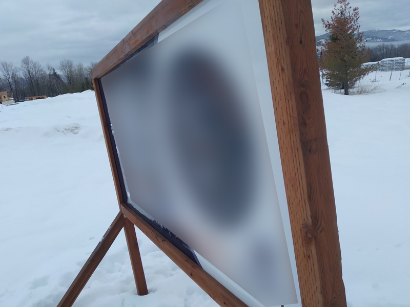

Are there different types of PT lumber depending on which part of the country? The stock at my local HD is much darker. Here's a shot of one of mine that's been outside for about a year.

The HD PT lumber is crap. We buy our lumber from a dock supply company and it is better but still treated with the same cheap chemical. It used to be creosote treaded like telephone poles and railroad ties, it'd last a lifetime. Pretty much every place that did that treatment in the past is now a superfund site. It's some coal tar derivative which is something that we still use in industrial painting, it is nasty but you can not beat the weathering durability. Eventually it will be banned all together like chromate.
As far as signs, paint it. Sorry Tex, luv ya, but raw wood looks cheap. And pull the tags off..... and the backing off the ACM for Christ's sake. I dunno about you Texans.

I would bet its a different species of lumber since it is generally regional. Down here its white pine and SYP. SYP is denser and stronger.

That wood is a lot darker than here. Notareal is a sign snob with his painting posts. Yes, I like to paint them, but that was a construction site in the desert... their guys probably ran over them with a bulldozer before I made it back home.

I use Fir Posts. They're decently affordable in my neck of the woods and they don't warp like pressure treated. Skids, or in the ground. I paint them and a bit extra paint on the ends as it soaks up. Fir has treated me well for at least 15 years, probably more like 18.
