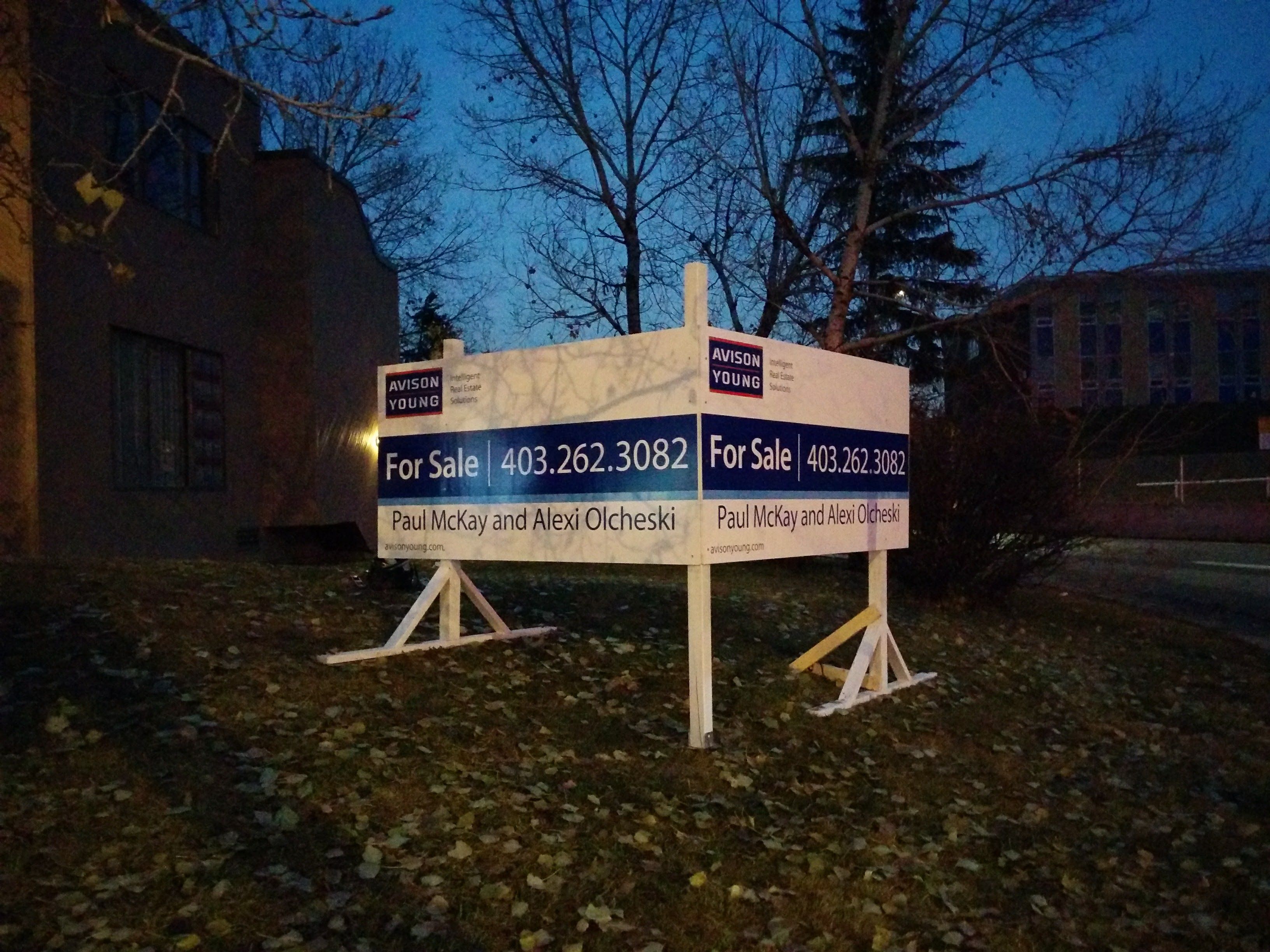

Received a RFQ for an 8x4ft corner skid sign for a national corp. Anyone done anything like this, or does it need to be posts in the ground? Found this example online, it looks pretty sketchy and tacky as well.
chester215
Just call me Chester.
That is bad on so many levels.
Posts in the ground.
We also support the back of the sign with an X made of 2x4's to add stability..
Johnny Best
Looks good to me but less complicated to just dig in other posts, less wood also.
Could be some pipes in the way underground, so made adjustments.
JBurton
Signtologist
Just make sure to calculate where the third leg goes with Pythagoras, don't want to redig the third hole wider just because you didn't get a true measurement from the corner post.
