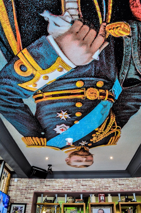

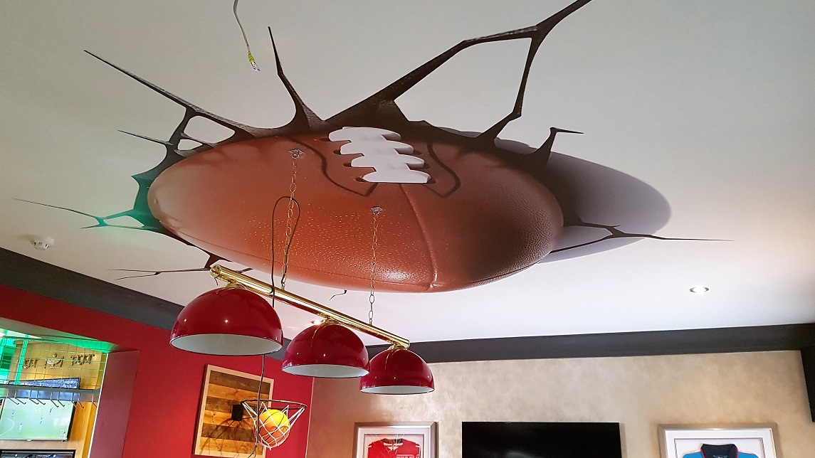

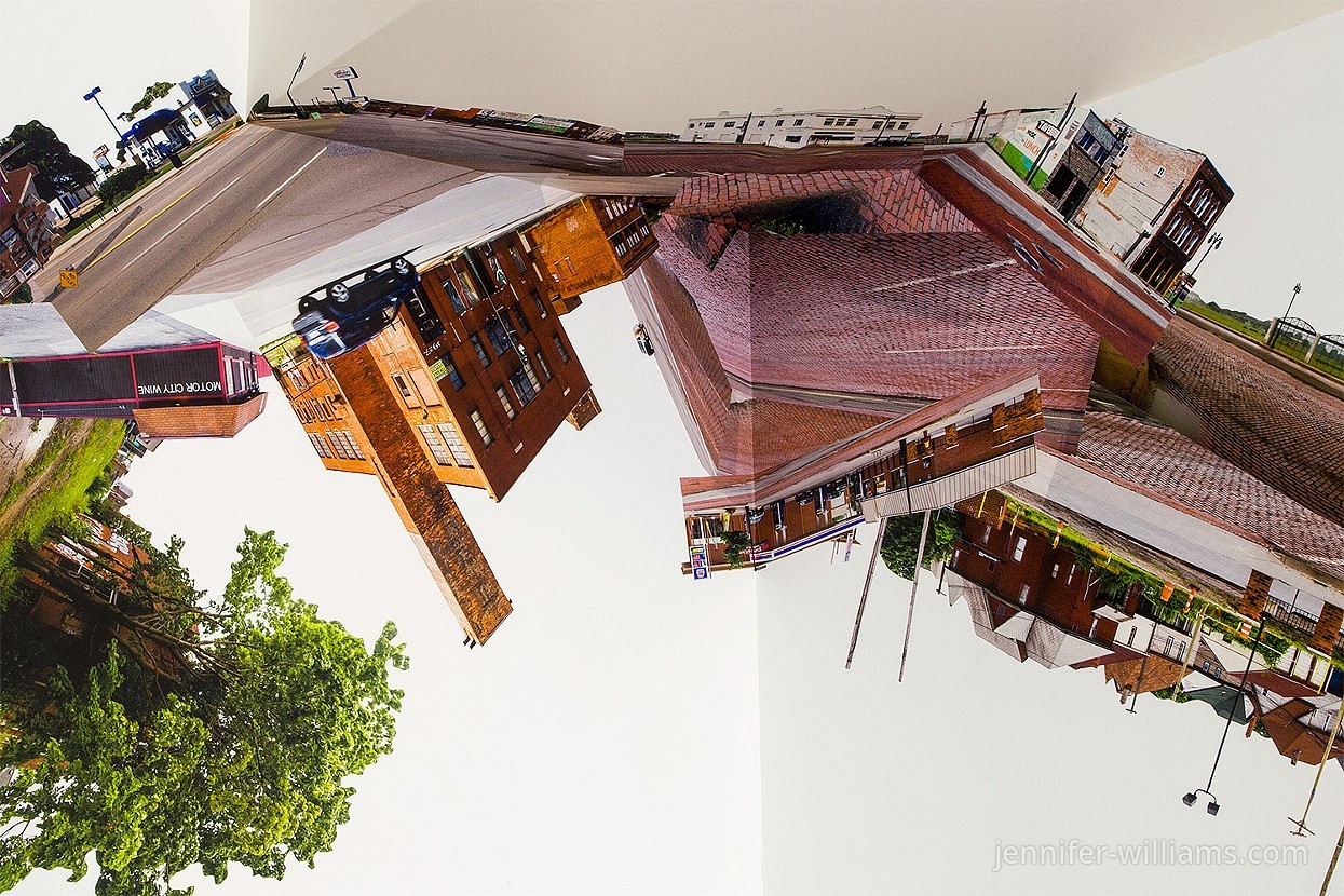

There is nothing wrong with using Photo Tex - It has been used in many ceiling installs. Happy to send sample walterjr@phototexgroup.com
