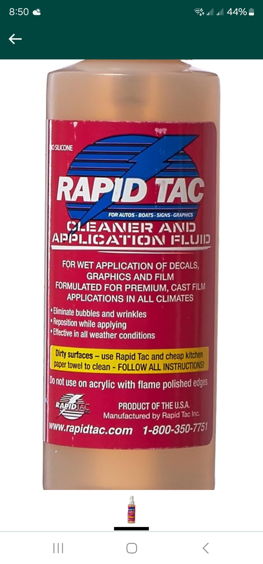

ikarasu
Here's a conversation within
RapidTac vs. soapy water.
Is there alcohol within rapidtac? If so, enough to be concerned with crazing on a flame-polished panel?
Rapidtac says not to use it on flame polished acyrlic.... Big warning on the bottle. Whether it's because of alcohol or not... No idea. But usually if a manufacturer warns you not to use it on a certain product, I follow their directions!
I guess it could be a warning so you don't blame them if something happens.... But I bet it's more likely enough people used it and ruined their acyrlic that they had to put a warning on the bottle.

signbrad
Yes, Rapid Tac contains alcohol. Its SDS data sheet says it is 10-20% ethanol.
Ethanol is the alcohol in whisky, drinkable in its natural state. It's what makes Rapid Tac "rapid." Rapid Tac's main function is to accelerate the initial tack of the adhesive on the vinyl. Water with detergent does not do this, but is a wetting solution only.
Rapid Tac II contains a solvent that works faster than regular Rapid Tac.
Propylene glycol methyl ether is one of its names, "an organic solvent with a wide variety of industrial and commercial uses. Similar to other glycol ethers, it is used as a carrier/solvent in printing/writing inks and paints/coatings. It also finds use as an industrial and commercial paint stripper. It is used as an antifreeze in diesel engines." (from Wikipedia).
