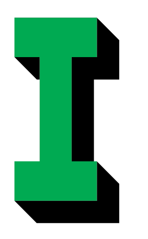

I would like to see Adobe or some other 3rd party produce a function that produces this kind of extrude/shadow that is VINYL FRIENDLY. Yes there is a 3d tool in Illustrator but the results produce too many extra shapes and when applied to detailed graphics or complex serifed fonts they have too many anomalies
I want something similar to what some of the sign software programs can do.

Yeah I did that I in less than 20 seconds. However, that is not the case when there a dozens of letters or worse, when a serifed and rounded font is used. It requires extensive work and a script/effect could do any amount of letters in a fraction of time.
Eric are you sure there's nothing in Illustrator to give you that type of shadow? Couple of years ago I was adding a drop shadow in illy and it gave me that shadow instead of regular shadow it gives you. I don't remember what I clicked on though.
The Vector Doctor
Chief Bezier Manipulator
Not that I am aware of. 3d extrude that I spoke of will do this but it is NOT vinyl friendly

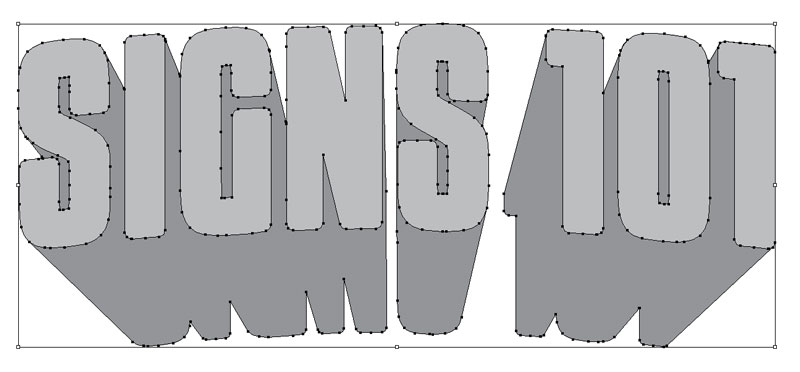

But, How are you creating that?
I'm still old school on those
Set Type>
Copy > Paste in Back > (move to desired location) > Paste in Back (Pasting a another copy of the original - Keep selected > Select the moved copy > Blend (144 Steps) > Expand > Unite > Delete Anchor Points created by the blend > Adjust colors --- (Hopefully that makes sense.)
For example, this one took about 4 minutes (+-)
