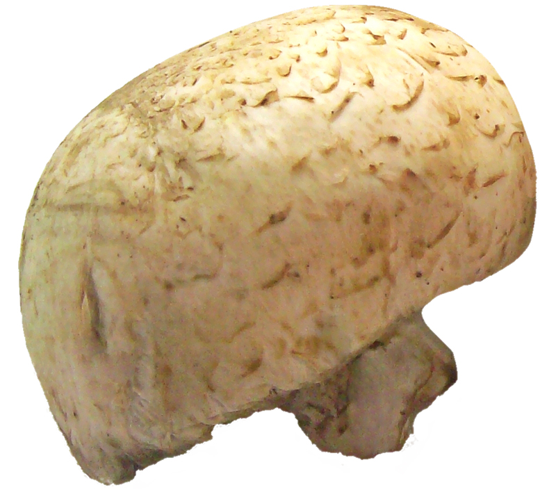

I'm looking for the best way to reduce highlights and shadows in an existing image using Photoshop CS2. To put in another way, to equalize or linearize the effect of light on a given image reducing the bright spots and shadows while still retaining a reasonably vibrant and realistic look to the image.
I've been trying different tools for several hours and am not getting what I want which would be as if the image was photographed in a global light.
Is it doable? If so, what approach would you take?

Fred,
Try the shadow/highlight adjustment, you have two sliders, on for the shadows and one for the highlights, it works great. Most of the time I have to lower the default shadow.
In CS3, it's under IMAGE, ADJUSTMENTS, SHADOW/HIGHLIGHT, not sure where it is located in CS2?

i'd burn and dodge it. if the image falls apart,
i might do a photocopy of the image to save the structural mushroom, then color range the highlights so that you can dodge them to perfection. it does have a good bit of flatness and highlight.

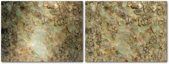

Let me try and explain it differently. In one of the applications I use for tile creation, there is a two command process to
1. Equalize brightness and
2. Set the brightness strength
It works extremely well but is a global command. here is an example of the before and after:
Left: Camera flash will often make photographs darker around the edges.
Right: Equalizing brightness can even out lighting.
But if I have a number of different objects, be they mushrooms or whatever, I would prefer to adjust these individually. so I am looking for a way in Photoshop to accomplish the same result.

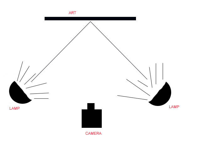

Fred,
Sometimes it's better to start out with a good photo, than to spend many, many hours trying to fix one. That being said, whenever photographing a flat art object, a on-camera flash will cause the lighting effect you show in your before photo. To get good even illumination you need to NOT use on-camera flash, USE a two light source positioned at 45° to the subject, this will give uniform light distribution.
This is how I photograph artwork for duplication and NOT get glare or the center HOT spot like in your before example. Another thing that helps is to have large light reflectors or soft boxes for even illumination.
Here is a short video explaining the lighting setup:
http://www.youtube.com/watch?v=dCdGACI-THU&feature=related
