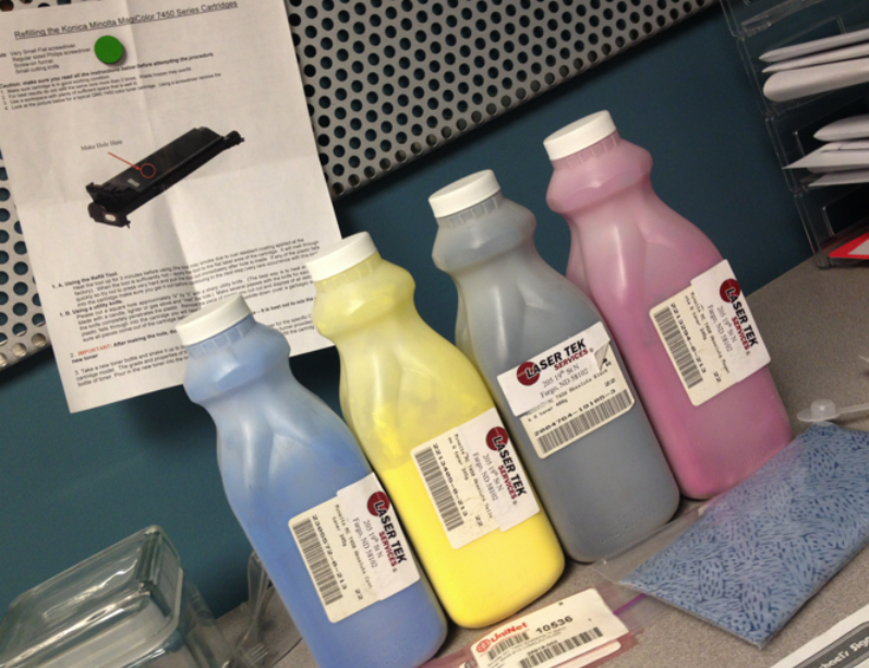

anywho, the process was really simple. the only thing that bothered me about it all was that I had to cut holes into the toner cartridges... BUT a torch-heated Xacto blade carved through these puppies like butter! In the end, $185 refill kit beat the heck out of $700 in new toner cartridges hands-down!
pic 1: refill kit

apologies for lack of process pictures, but I went all OCD on filling-up my toner cartridges once they came in the mail. Total time to fill 4 cartridges, approx. 1 hr.
But really, all it took was to cut a 3/4" hole into the top of the toner cartridge (melted-cut with a hot blade to avoid plastic particles falling into the toner chamber), filling with toner, covering the hole with masking tape, and swapping the chips that came with the kit.
