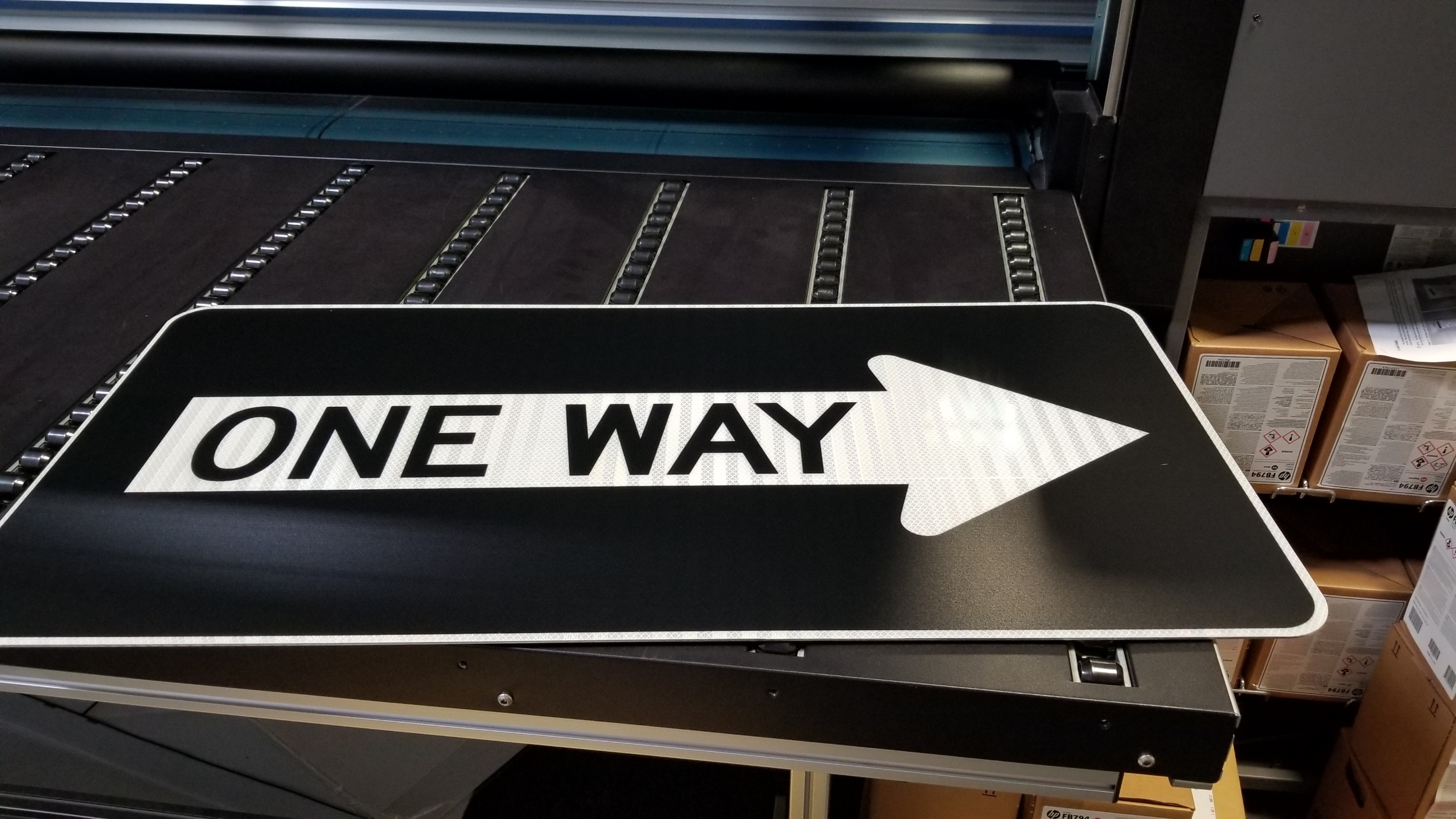

For what you are trying to do, it sounds like traffic safety / direction, you need to make sure if it has to comply with MUTCD standards. If it doesn't, applying a transparent traffic vinyl will be the best option so all colors (besides Black) reflect, if you don't want to do that direct printing on your UV will work but you should consider reversing the image so the text reflects white and the color blocks out the background.
The attached pic is UV printed.
