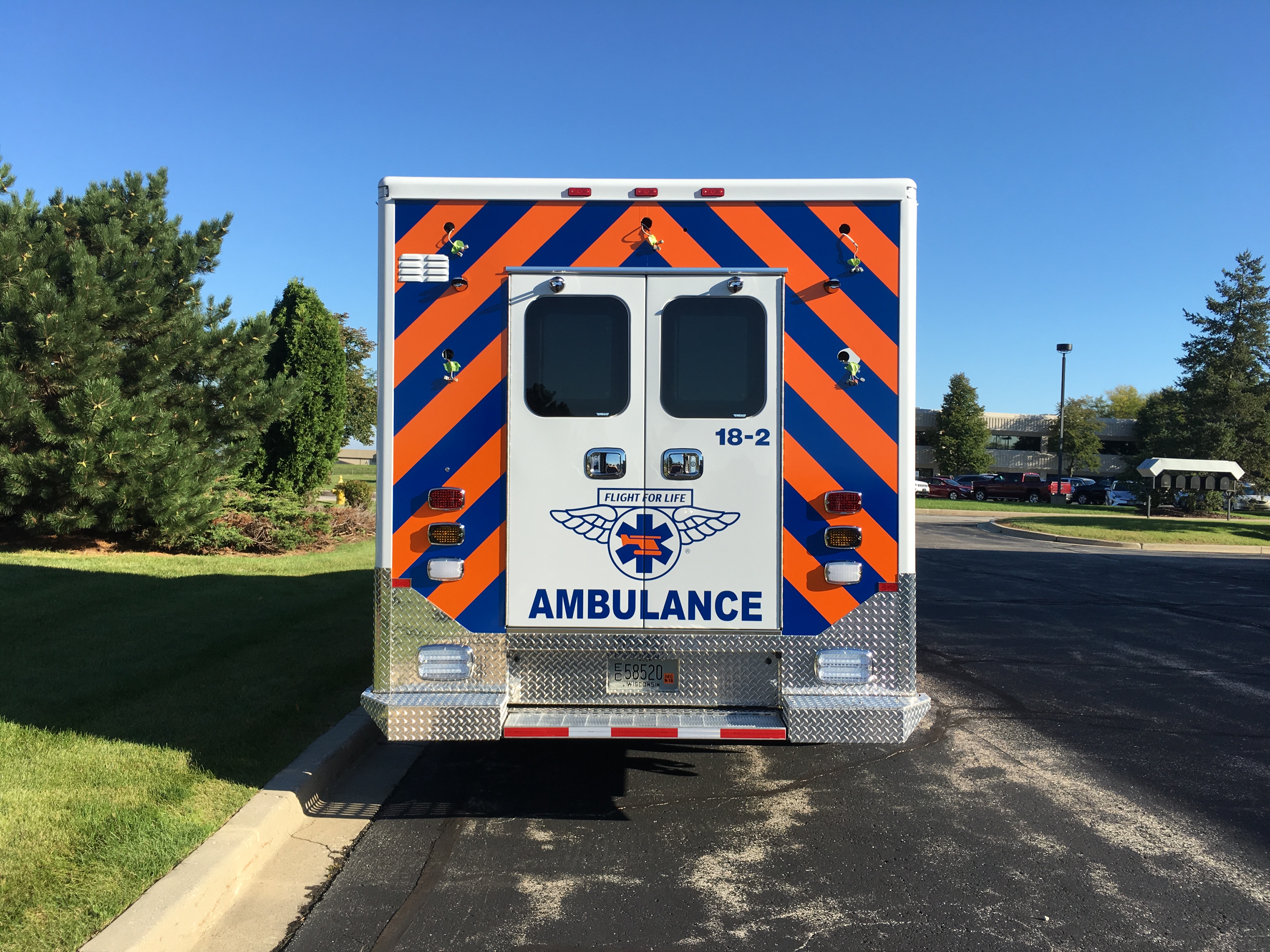

We just did this not too long ago
Laid down the blue then the orange over the top of that. Only seam is at the top in the blue. Orange was cut a “v” and stripes
Not sure where you can get sheet(s) of chevrons. Just an idea for you
