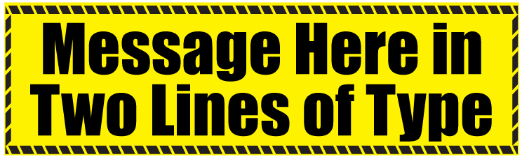

I am making a sign 24"h x 10'w. Background will be reflective (yellow). If I make the letters(black) and also reflective...will it read clearly? OR....do you think that if it were just black regular 2 mil vinyl black, it will still read correctly (at night of course).

oh...and I've attached sketch because it will be as simple as you see...two lines of type...bold. That's it.

I'd use a regular yellow background and black reflective for letters. Why do you want to make a background light up and overpower your important words ?? Using reflective for the letters makes them quickly become the focal point at night time and much easier to read at the same time.

Doesn't matter really, you can just do black vinyl on reflective yellow or Reflective black on reflective yellow, give the customer options with prices.
Use Oralite Engineer grade on flat signs

I'd use regular black.
Black reflective isn't a nice pure black, kinda has a greyish look.
As long as the yellow part is reflective I think you're good to go.

I would print black to reflective yellow as well... if you are able. I have never had an issue printing to reflective but we run thermal transfer. Otherwise I would say regular black cut on reflective yellow.

I do have the capability but I didn't think that colored reflective was printable. Also wanted a nice solid black punch to it, I feel like when I've printed on reflective before it isn't quite as solid as I'd like it. Perhaps it was the profile used, not sure.

I vote for opaque black.
... and much easier to read at the same time.
:help Yellow and White? That isn't going to offer much contrast. Likewise, the funkiness of the reflective black as it transitions from black to white is going to mess with the eyes depending on the angle of light as one passes. I'd think this would make it more difficult to focus on the message.

I've done more 4x4 highway signs than I care to remember. Uneven Pavement, Flagman ahead, etc. All done with background reflective and black cut vinyl letters and graphic. With the exception of the many I have screen printed when the run was large enough to call for it.
