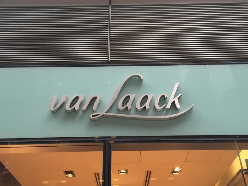

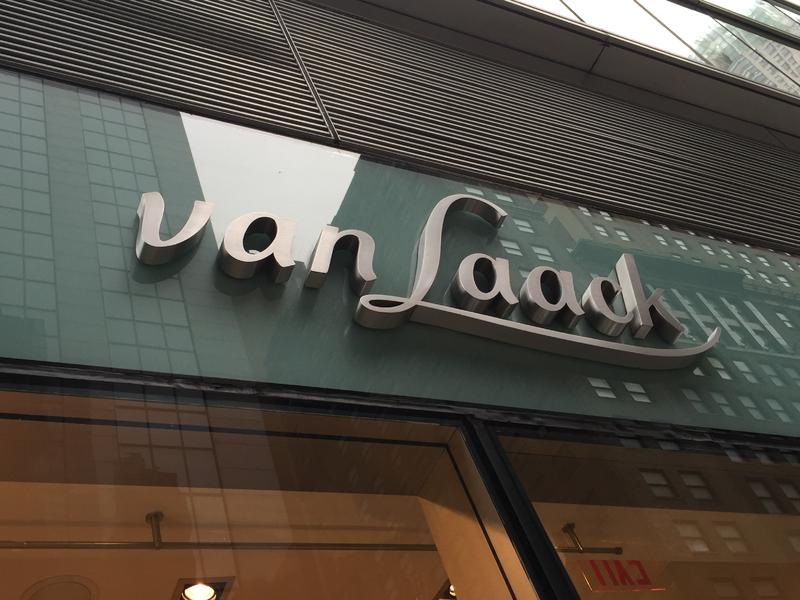

customer wants a quote to remove some old letters that are glued to glass and install new letters. (i have not seen it yet just going by customer and pics)
what do you think is the best way to remove the letters with out damaging the glass?
what are the chances i can clean off the old glue?
could i use 3M pressure sensitive adhesive and silicone to re-glue the new letters on?

d fleming
I'm thinking the new blade for an olfa knife night be long and skinny enough to go under letter without trashing the glass. Maybe even a guitar string. Cleaning with rapid remover and a sheetrock knife then apply new letters using a few small pieces of double sided tape to hold while silicone cures.

that's what i was thinking. i have removed some auto logos and lettering with a piece of wire or fishing line. my main concern would be breaking the glass. i really have to go look at it and see the condition and thickness...and so on
also it's outside Gino

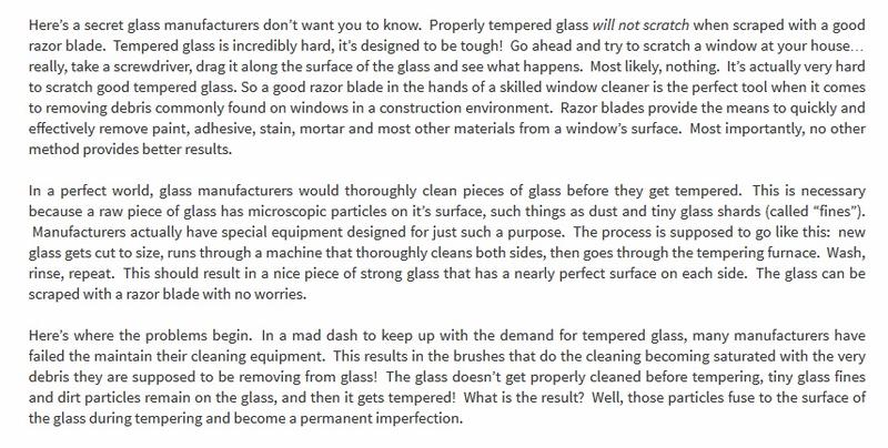

ams
If it's VHB taped, use a guitar string and file it down behind the letter. Glass doesn't scratch (providing it isn't sandblasted, have any films on it, etc) so you can take a razor blade and scrape the glue off.
I bet the glass is 1/4" thick so it's not super breakable anyways. Just be careful and take your time, even a retractable knife can cut it off.
If it's flush on the glass with super glue or a vinyl backer, try twisting the letters by rotating them until they snap off, don't pull them out or at an angle, twisting won't hurt the glass.

I am so confused, in my 9 1/2 years in the sign business I've never scratched glass with a knife or razor blade.
Did a little digging, here is what I found.

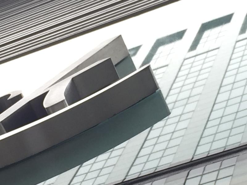

they are slightly raised off the glass so maybe double faced tape mount probably with silicone. if you can get the letters off with piano wire or a wire saw or any other method, use a large scaper and get a box of new blades which you should change often. I only use on of those on glass and never have ruined a piece of glass yet but you'll want to do a test to make sure it works OK on that tinted glass. how is that glass mounted? is it an add on to the stucture or part of it?
