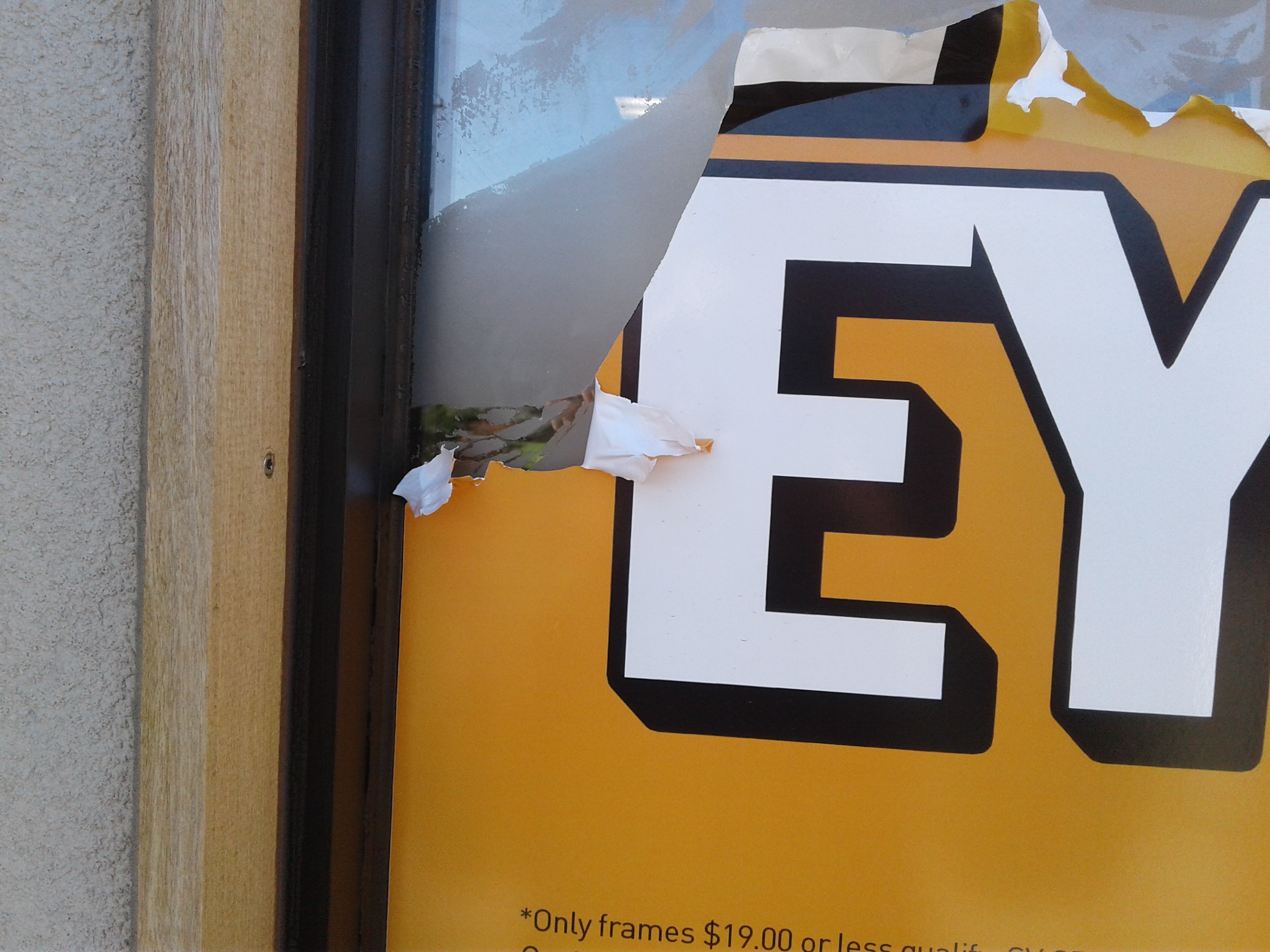

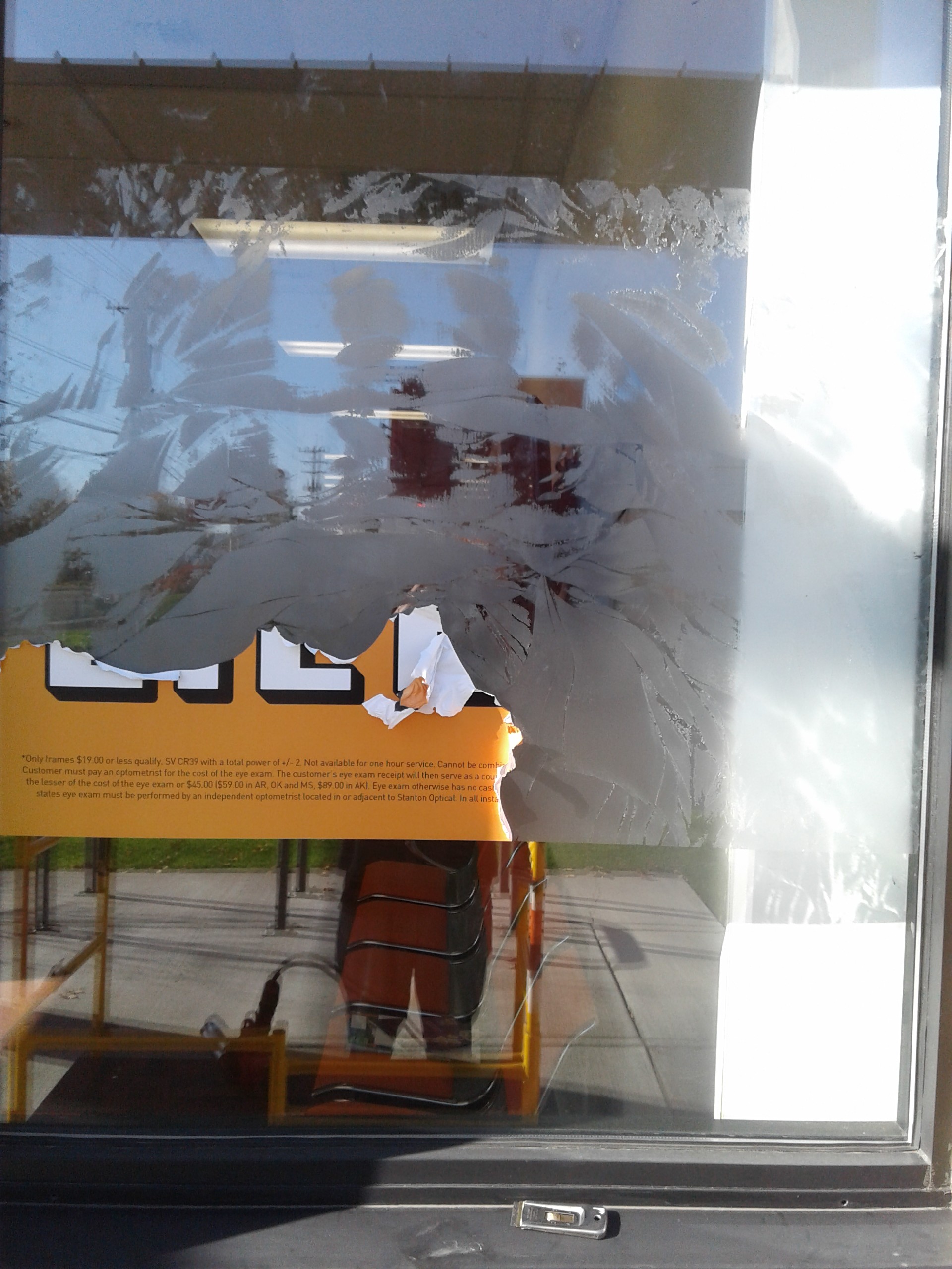

Its just shredding and brittle (chilly outside, but sunny) and he has to take 30 of them off. HELP - any suggestions? He's using a heat gun and it isn't helping.
is it old vinyl? that would be why it is cracking in little bits, probably the cooler temp doesn't help... what about getting it really hot?

Not enough info. What is the surface vinyl is being removed from?
It’s on glass windows. I’m in the Pacific Northwest and this has been the first cold of the season. It was around 55° for a high.
I think the cold is a big part of it.

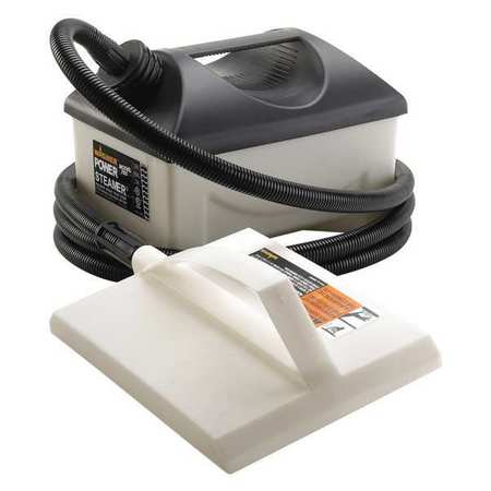

On glass I recommend a steamer. You can pick it up at the hardware store for around $150.
Use the wide attachment. It's like 6" x 10" and that will heat up that area and then you can start to peel
the vinyl off, while you're peeling move the steamer down a little bit and that will start to heat that area.
Try to get it the right temperature and most of the glue will come off with the vinyl.
Any remaining glue use rapid remover. Then clean the glass as you would clean glass. LOL that sounds funny.
JR's
This is the one you want to get.
It seems to be higher-quality than the newer model. It's going for 80 bucks
When you get to the job site plug that in first and then start to get everything ready it takes a couple minutes to start steaming.
This^^^^
Steam works a treat. I bought the same steamer from Menard's and it was less than 50 bucks. I had a job like the OP's where the vinyl was welded to the glass. Steam took it and the glue right off.
