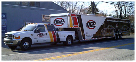

I put stripes on this trailer about 6 or 7 years ago, I know I used some cheap avery vinyl, and now my friend wants to change the color of his logos and the stripes. Can I just apply new vinyl right over top or would it be best to tackle the task of removing it all then applying. That of course is if the vinyl is not really damaged that I would have to take it off, I haven't seen the trailer up close yet.

You could apply over,make sure area is clean, no lifting has occurred in recessed areas, whatever is under will show over. removal is best, lots of heat

if the customer expects the new stripes to last the 6-7 years, strip and remove the old stuff....if you dont, as soon as the material underneath begins to fail, the new stuff you put on top will fail...
personally, just because it's an avery vinyl underneath i wouldn't risk NOT stripping it off...
Exactly what fenris said.
That old stuff is about on it's last leg for holding and gripping power. It's going to start letting go and it will take the new stuff with it. The new vinyl is only going to hold onto the old stuff, so how could you justify giving this customer a professional job, if you didn't do it correctly ??
Remove all the old, clean well and re-apply.
Another thing..... consider using a different manufacturer for your vinyl. That is the longest last vinyl story I've ever heard of for A V E R Y . You're one lucky person in that department.

Thanks for your help, I will be using 180cv3, thats all I really use now, and I would feel better about the job I do if I do remove the old stuff, I like to go the extra step for this guy though, he helps me out on my cars, I wouldnt want him to go cheap when working on my car
