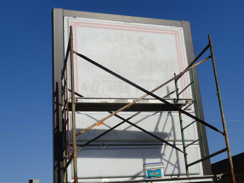

Craig Sjoquist
Here you see the distance shot of dirty acrylic face, ( this side was cleaner ) after vinyl was removed ...Rapid Remover was used to remove glue works like a suppose to & better.
The next is a close up of the face / border / wallpaper steamer.
Removal of that border about a 2 hours per side
Then a close up of how clean it looks.
After Rapid Remover final clean
..A dish soap & water clean. oh with cloth rags.
