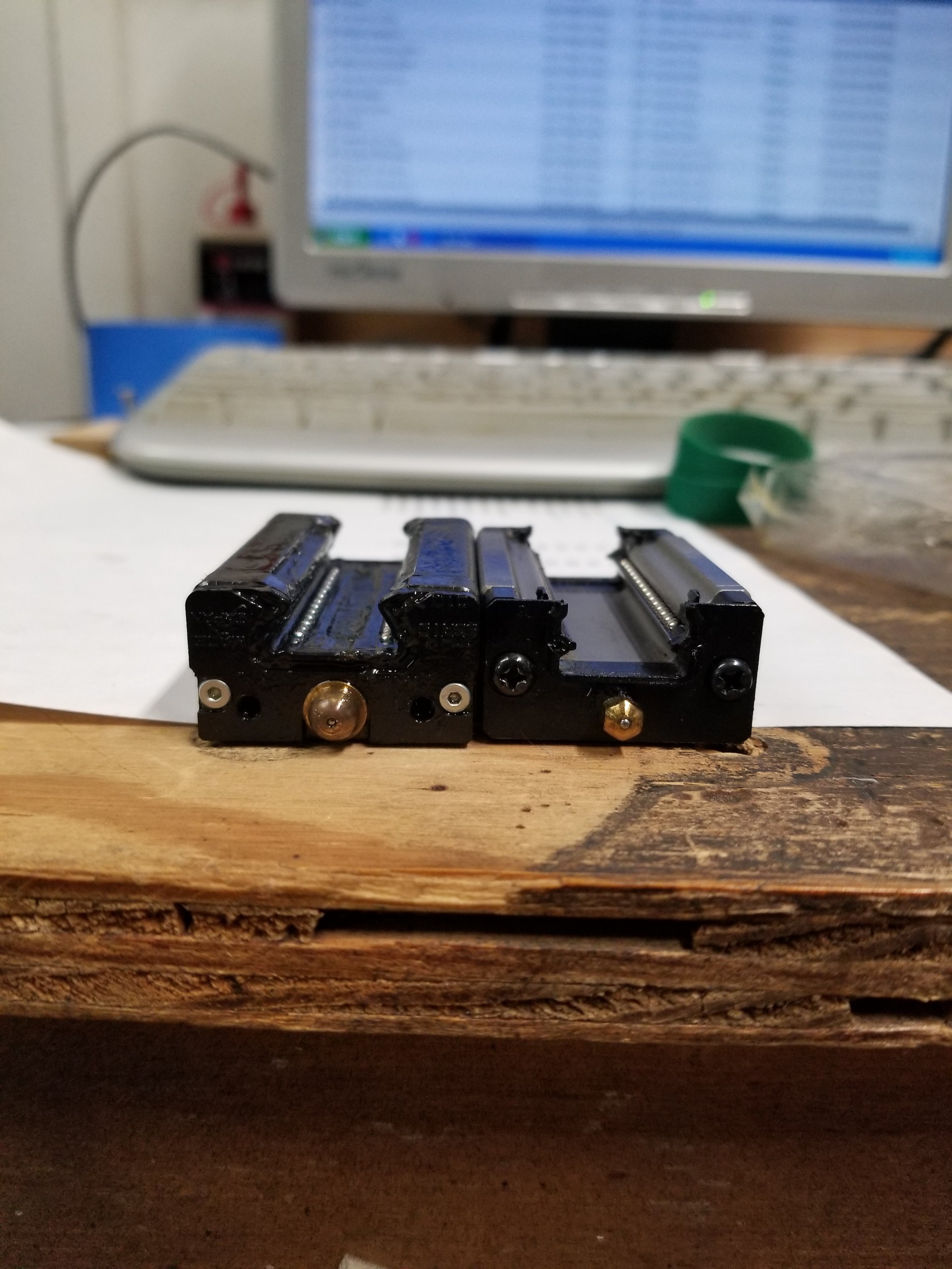

Have just been out and checked on 4 printers including rails and bearing on an sc545 and they all run 15mm bearings
Get one from here then https://www.sign-in-china.com/produ...ng_rail_block_ssr15xw1uu_2560ly_21895161.html

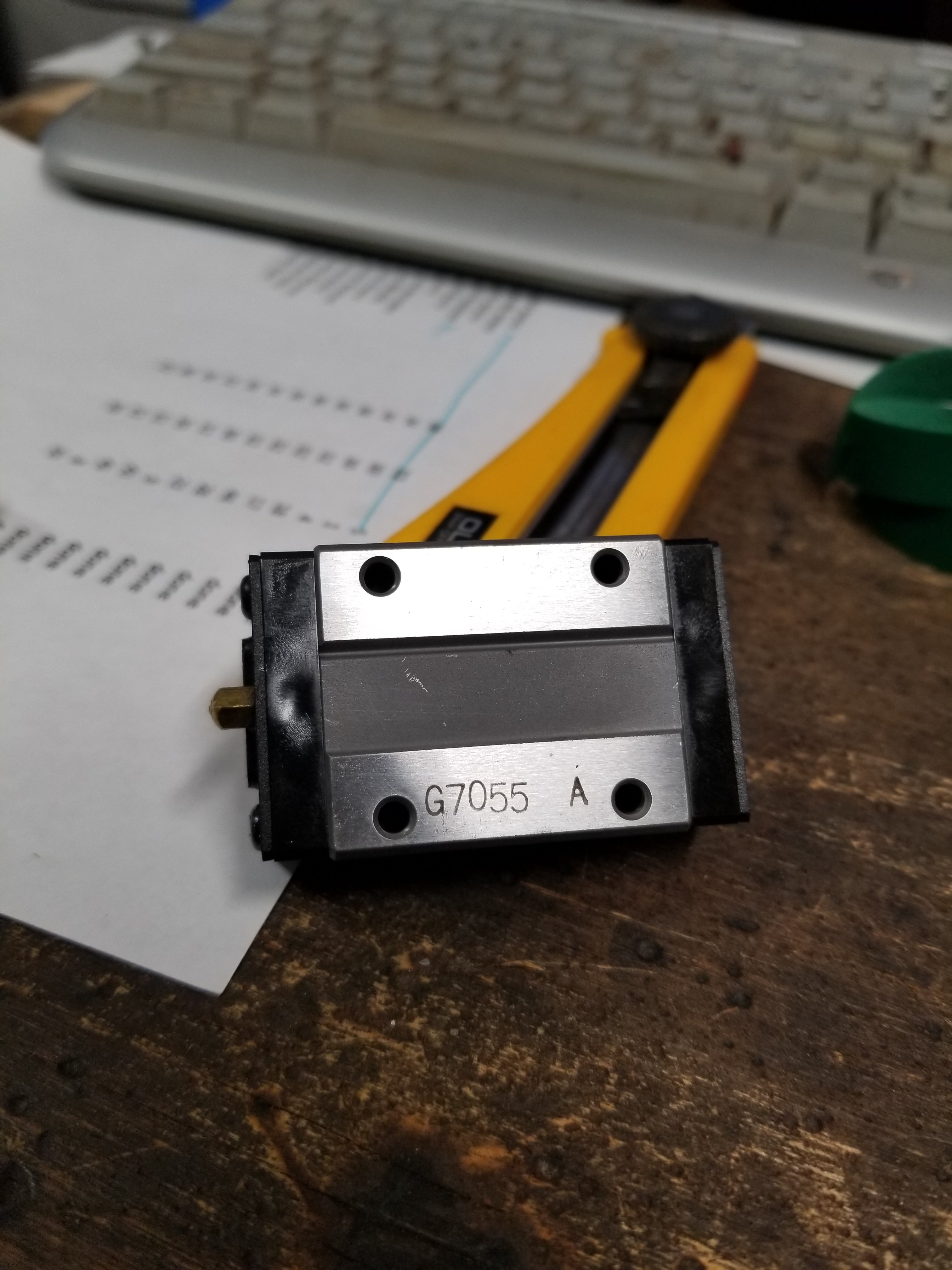

the pic of the bearing by itself is the one from my machine
the one that both are together the one on the right is from my machine the left is the one that I received.
the only difference is on the shape of the plastic guide at the front of the bearing
I'll try to swap them out to see if it fits.

If no one replies back there should be a part number on the bearing. Since it’s the cutter bearing you might be able to disassemble the left side of the machine and slide off the cutting module to look at the bearing part number. Try not to remove the bearing from the rail unless the you have to as the balls may fall out and then you’re down until you get a new bearing. You’ll need to measure the dimensions of the bearing but searching thk linear bearings, the part number and the dims should find it for you online. You do not need to replace the whole set. You can just replace the one bearing

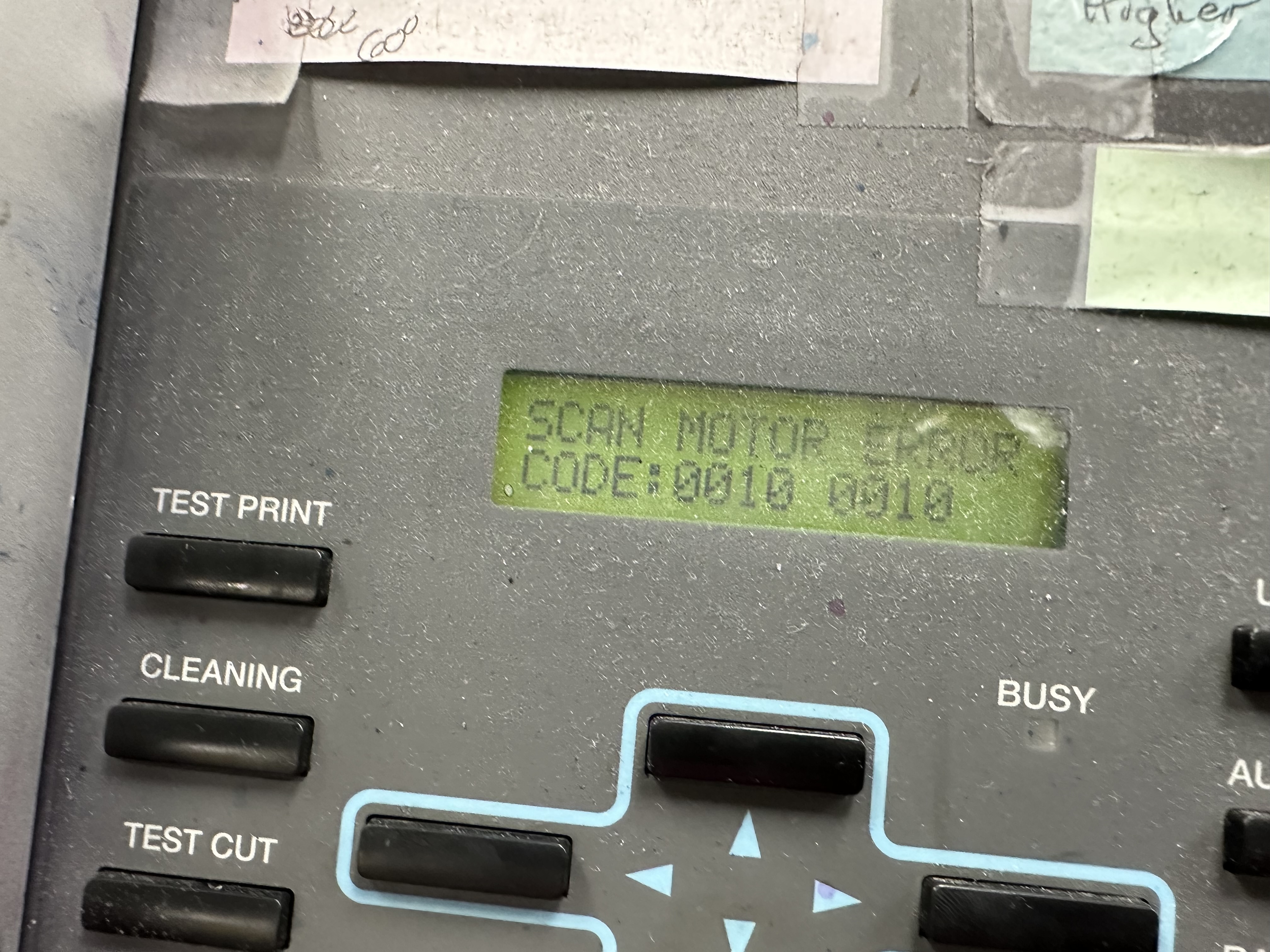

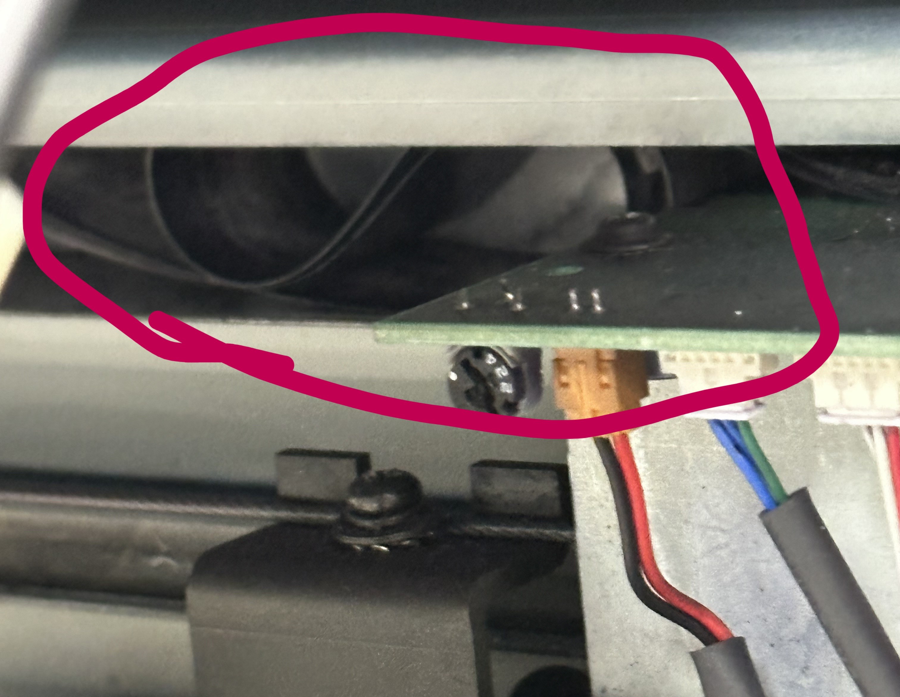

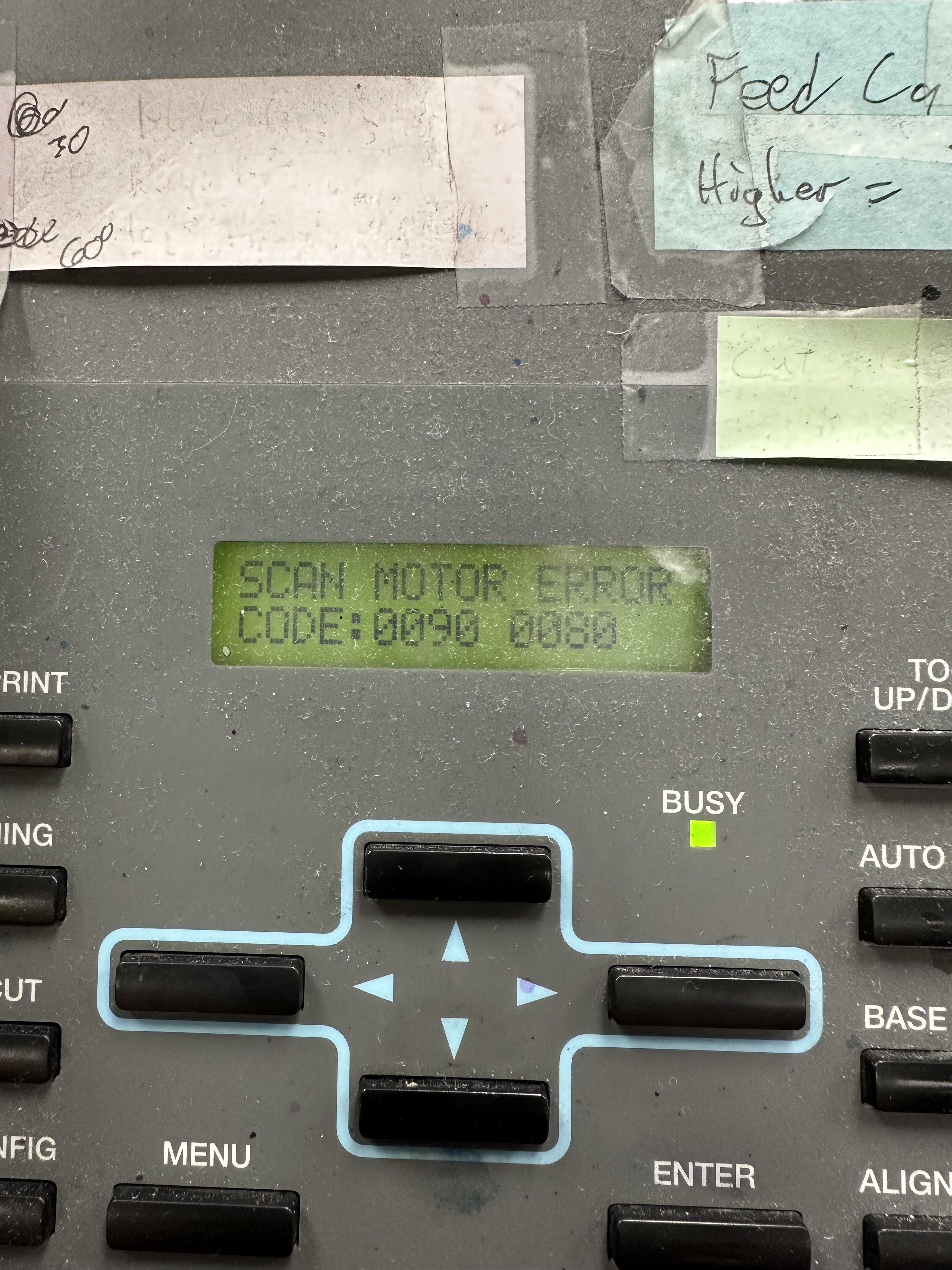

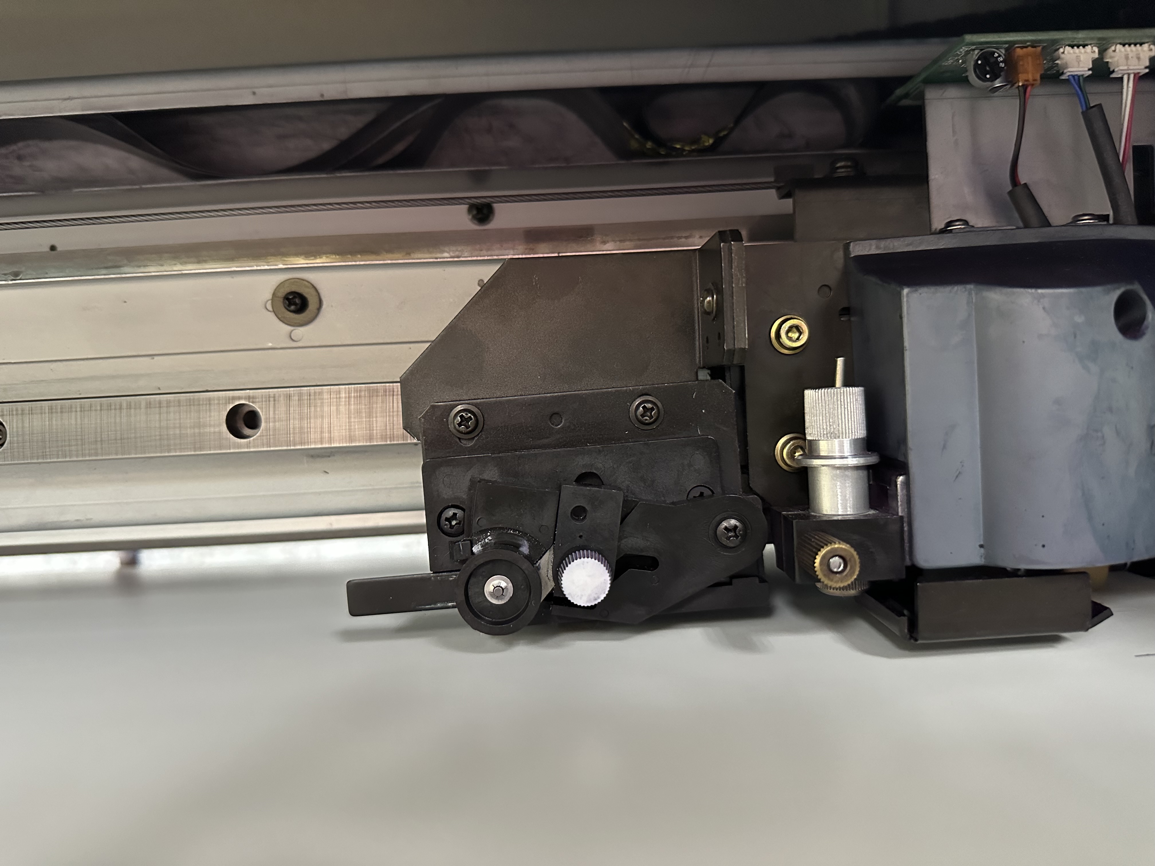

Anyone here know how to fix this problem? My Roland SC545-EX keeps jamming on the 12 pin cable card and I cant find a tech anywhere that either knows what to do or even look at it. The parts are all discontinued so I'm hoping for any recommendations.

Replace the scan motor you might not see it but it is probably starting to stick a little.
Jim Hancock
Old School Technician
The scan motor error is result of the cut carriage ribbon folding up and causing an abnormal load on the scan motor. The motor itself is almost certainly OK. The guide channel the cut carriage runs in is likely dirty and somewhat sticky. First, remove the encoder strip so you don't damage it, then remove the cut carriage ribbon (you do not need to take the cut carriage ribbon out of the printer, just clean what's accessible from the front of the printer) and the 2 cable guides and clean them thoroughly with alcohol. Clean the metal track, top and bottom, also. With any luck, the plastic cable guides do not have any kinks in them. If they do, you will probably have the problem occur again. The ribbon cable is readily available, but new cable guides are very difficult to find. There is a thread somewhere on this forum where one of the users can make new guides, but I can't seem to find it. Assemble everything and see if it works. Everytime I've encountered this, it's been ink mist and dust buildup. The ribbon has to slide freely where the top of the ribbon set hits the bottom of the upper part of the guide channel. If it sticks, it folds up, like what you have. You can spray some dry lube on the plastic cable guides and the metal guide channel after cleaning to help reduce the friction. Good luck!
