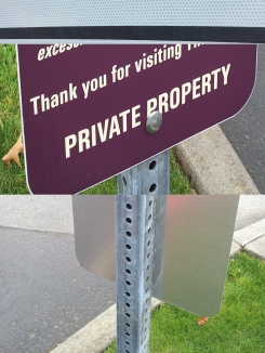

I'm trying to replace some signs that are attached to square channel posts using anti-theft bolts.
There's nothing to access from the outside, other than a pretty smooth top of the bolt. It looks like there's some sort of wingnut on the inside, I'm guess it works similar to a toggle bolt? There's no way to access it inside the square channel.
I thought I might be able to get a screwdriver in the square channel and see if I could remove the bolts with a vise grip and try to keep the wingnut(?) from moving with the screwdriver.
How do most people handle this sort of situation?

I meant to attach this image as well

I'm sure there's a better way and I've only done a few of them but I used a battery powered Dremel tool with a cutting wheel in it to cut a slot in the bolt head. Then it was a simple matter of jamming a screwdriver in the back of the post to hold the nut and using another screwdriver to unscrew the bolt.
Could probably do the same thing with a file.
Now that I think about it since you're replacing the signs anyway just cut the dang bolt head off or grind it off with an angle grinder.
If all that fails just go by one night and run them over in your truck so they have to replace the poles and all.

Drill out the back side of the post with a step bit large enough to access the nut.

I think getting a step bit and making a hole big enough to work with makes a lot of sense. I was wondering how well a screwdriver would work to access the nut through that small opening.

It's called a 'Liner Rivet' or 'Jumbo Head Drive Rivet' ....much the same as a Hammer Set Anchor...with a wider & flatter head. It is a Lead/Tin composition with a steel center pin. If you don't care about the existing sign faces, you can break the head with a hammer and chisel. If the signs are to be removed without damage to the faces, you can use a hammer and punch or screw driver to break off the ears on the inside of the post and punch the center pin back out. You may need to exert a little force.

On a drive rivet, the center pin can just be punched through and then the rivet can be pried out.

Punch the center pin through and out the back then pry the sign off. Sometimes you can also drill through the front of it after you punch the pin out with a 1/4" bit.
