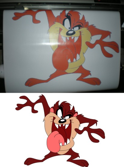

the pictures attached are one of the examples. top is the printer,lower part is the original file. i am using mutoh falcon outdoor 6 colour with flexi 8.1 as rip.

...so, that looks like a 3 foot, or 4 foot wide Taz print... are you telling us you printed that just to show us the problem?
how about printing 3 INCH wide prints when you have a problem, and then try some of the suggestions and print another 3 INCH test

its a rool of two feet banner cost like 15 dollars. printed at 360 dpi by 360 dpi,its a rgb file i took off the internet.all of my files are either vector or eps. i created every thing eps. but i get the same problem espically when a client wants a picture that they took with a digital camera.
