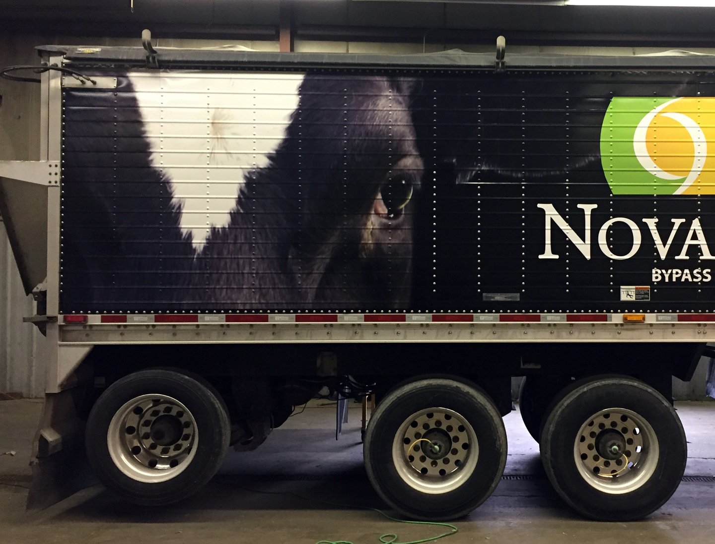

We wrapped a ribbed semi trailer back in March. We used 3M IJ40c w/ a gloss over laminate as the customer said this would be a 3yr contract at most. My initial look at the trailer made me hesitant due to all the "ribbed and riveted" metal...but they had some cut vinyl lettering that appeared to be holding up fine.
So...we proceeded to print and install a 70"H x 16'W image. We heated, rolled and tucked EVERY rivet. Took us 1.5 days, but looked great when done (see pic).
Now 3mos later the customer sent me pics of the graphics and EVERY rib is tunneled and rivets letting loose!?
I realize a little of this tunneling etc. would happen...but I didn't envision the ENTIRE image to do so! This isn't our 1st rodeo either...been in the sign business for 25yrs. So, I don't consider ourselves to be rookie installers.
IS it just the nature of all the ribs / rivets? Black trailer / hot sun? Wrong media to begin with? Hoping someone else has done one of these style trailers before and will have some insight. TIA
Attached pic is right after installation...looks GREAT! After pics are in the next response post

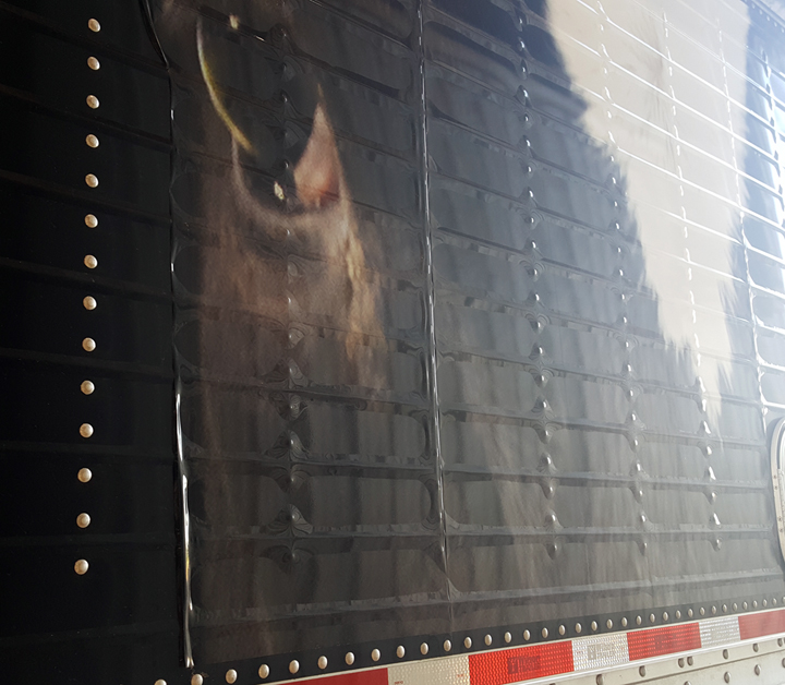

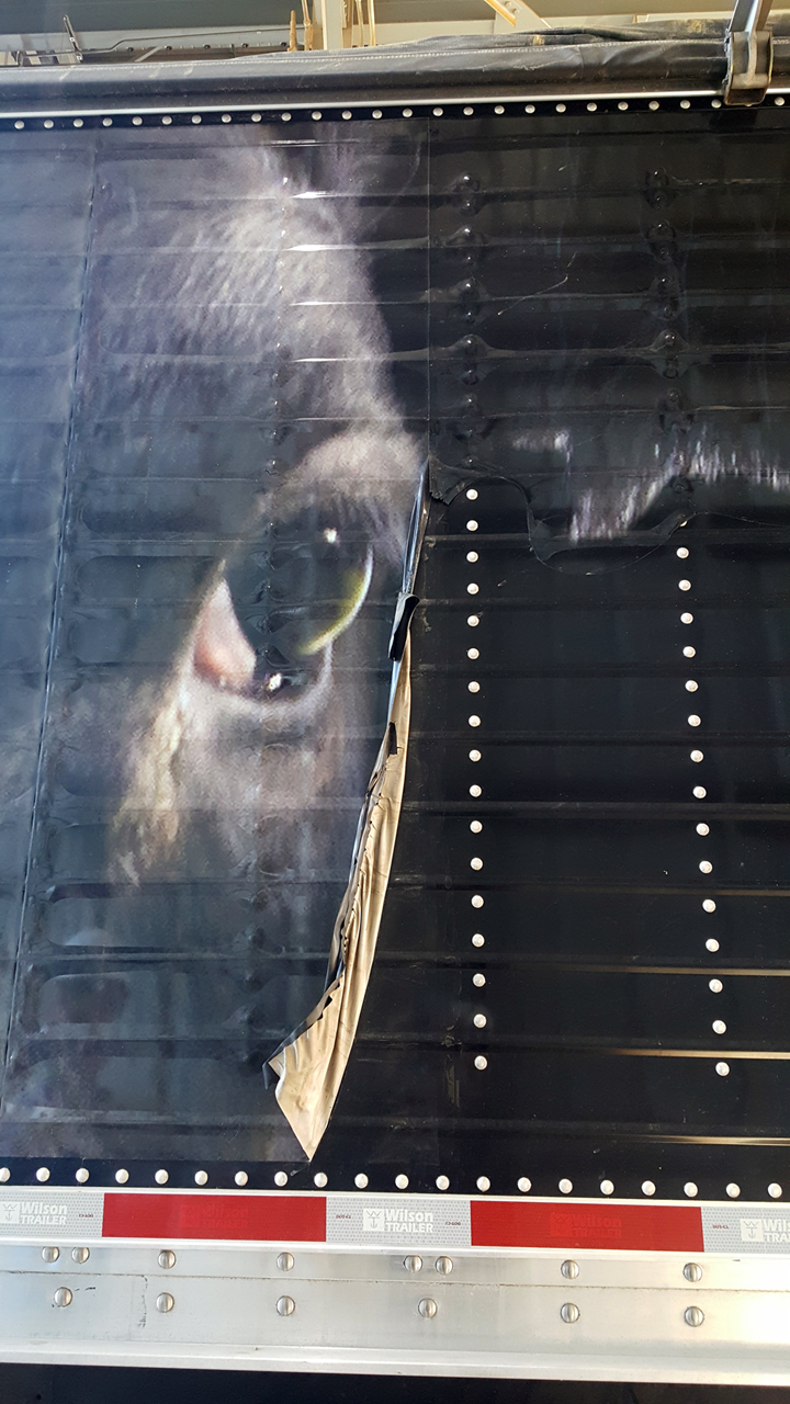

Here's the "After" pics of the tunneling

CanuckSigns
You used the wrong media, IJ40 is listed as flat surfaces or simple curves only, a ribbed trailer would be considered more than a simple curve.
Redo with a decent cast vinyl and cast laminate and chalk it up to a lesson learned.

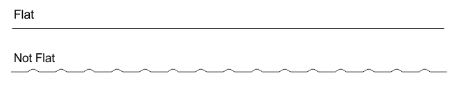

flat, In this case, means no ridges or bumps (ribs, rivets)

You definitely needed a cast vinyl for this job. I use IJ40C myself for flat panel van graphics. As a rule of thumb, anything with ANY rivets or ridges needs to be cast. Calendared vinyl will always want to go back to flat, and will not conform to a rounded rivet without "tenting". I have recently been using cast on any vehicle application, due to the fact that even on a flat van side, the calendared vinyl will shrink after a little sun exposure.
The application looks great. I'm sure it was a handful, and hate that the vinyl failed on you after all the hard work. Application with a cast vinyl will be easier than with the 40C, and you shouldn't have any issues as long as it is properly post heated.

I agree with the others. I would have gone cast. I understand it is "short term graphics" but those ridges and with the rivets i wouldn't even bother with cal.
Also without knowing how you installed it i would say that could be part of the issue, but without seeing your install method i would point at the material.

Sorry to hear of a problem like that, but as others said, cast, and even go with a 1mil overlam like Oraguard 293 to give you more flexability on those numerous amount of bends and post heat.

While I agree with the "use cast" posters, 3M's literature might lead one to believe that IJ40 is not necessarily the wrong material. It mentions rivets twice, but does not mention it's not really suited for the job. (But yeah- it's not the right stuff to use)

rivets and ribs is not the same, could get away if there was only rivets but with those rib channels there i don't think you can use any calendared, i would no use it even if it's only for a month.

As far as application, I'm curious if the material was bridged across the rivers or fed up and down the ridges. Calendared vinyl "could" have worked possibly if it wasn't stretched into the valleys though there would likely still be some tenting with the rivets. I don't know that the material would have pulled so hard if it was fed instead of stretched. I attempted to use the General Formulations Automark material on my trailblazer when a sales Rep told me it really could be used for full wraps. I didn't believe him so I wrapped my own car. It works great on the simple curves but when I pushed it into the space where the curve of the door meets the base of the window frames, they pulled out in less than 2 years and that was with primer. I don't believe there is any calendared material that should be used on on a surface that can pull away from something.

Definitely a job for cast.
Unless you make it clear it won't stay down around the rivets/ridges and they are desperate to save money.

Looks like you had 3 strikes against you from the start.
1.Calendared material
2. Heavy saturated ink load
3. Rivets holding down ribs
This would be a tough install even with cast material.
Put it down in your "Things not to do next time" notebook.
