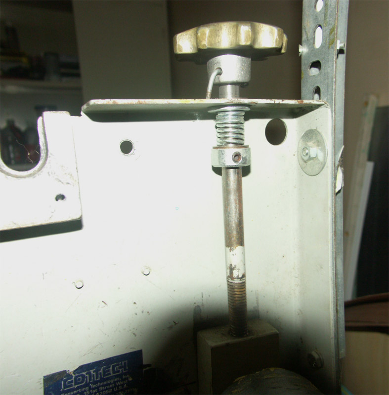

it really doesn't matter if the table is level. it only matters if the roller is level to the table. and truly, there are so many variables that can decide just how that table ends up, if you do pour it. i'd think that it would be easier to set the table level, pour it. then shem the gantry to the the table. that is a single axis entity compared to plane. and i'd still go with some springs. they are just too easy to add to the build and will distribute your pressure much more evenly. you'd just need two springs, some washers and a stop collar.
SqueeGee
I'm not following you on the springs.
Imagine dropping a rolling pin on a counter and pushing it across. Irregularities in the counter top would not be compensated for by having springs under the roller handles.
Does that make sense or am I completely misunderstanding how you would use the springs?

i have a crappy contech premasking machine. it used to have some really beefy springs. i've since swapped them for lighter springs. usually i just use the weight of the roller but with some substrates with a warp or sometimes laying up veneer and such, i need a bit of pressure. you know way more about the operation of your roller. i just figured if it's not heavy enough to hug the table a few more pounds of downforce might be good.

I thought the puenamic cylinders were meant to give you the down force? Won't the rubber in the roller give enough give to compensate for slight irregularities?
SqueeGee
I didn't think that this was accurate. I thought that dropping the roller did only that but I checked it today and yes, the cylinders do add additional down force. I got it operational at about 4:00 today and I shot a quick video with my phone. I'll try to get it uploaded tonight.
jasonx
Awesome. If you up the air pressure in the cylinders that might give you the needed down force to sort through small irregularities in the work surface.
