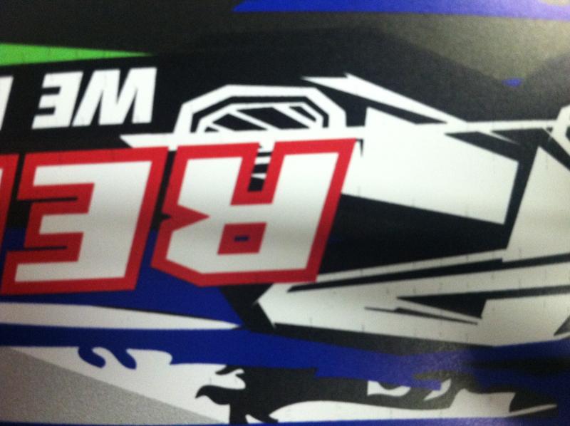

Hey guys got a problem with the black only, it is like overspray (but not) its not ink drip, the test print is perfect. It prints perfect for about a foot and a half then black lines start showing up. Anyone know whats up?
Offsite pic replaced. Please read our rules and instructions on photo posting.

Try cleaning the linear encoder strip - use a damp (not wet) shammy/lint free cloth.
you will probably find the strip/encoding is dirty causing the laser to missread it's position and fire/mist. We have this problem once in a while and generally that sorts it, alternatively give your black head a manual clean and if problem persist do a powerfull clean. (as per our AJ1000)

Cleaning the encoder strip should NOT be done with a water damp cloth. The strip is a precision piece of film and water can actually cause problems. The best solution for cleaning it is a microfiber cloth and pure acetone. Acetone does not effect the emulsion on the encoder strip (water will!) and it will clean ink and other stuff off much better than alcohol. I've cleaned several hundred encoder strips this way and never damaged one. Please do not use water.

That's what mine looked like before I changed the head. It was getting lots of deflections.
I just had something similar happen to me yesterday. The problem was a piece of fluff being dragged back and forth by the print head causing intermittent black lines like the photo shows.

I was kind of thinking debre dragging as well. Is it only black that you notice or is it because the black lays a bit thicker and it is just enough to make it catch the fuzz or hair being dragged. Check the cutter blade if its a print and cut as that seems to catch a lot of stuff. I remove the cutter when just printing. Look for a hair and remove the cutter and see if it goes away before you clean the strip.
If the lines show up in a total non printed area (not just edges of the print) that might be the strip being dirty.

Dirty nozzles with a dragging debris.
Manually clean the heads, do a light head soak.
Then an auto clean and you should be alright.
It looks like you may have a humidity thing going on too. If you are in a low humidity enviro you should look into a humidifier.
