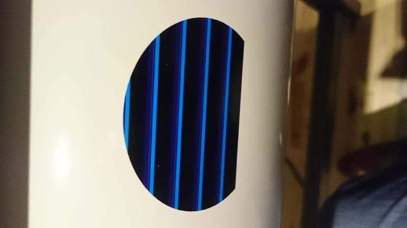

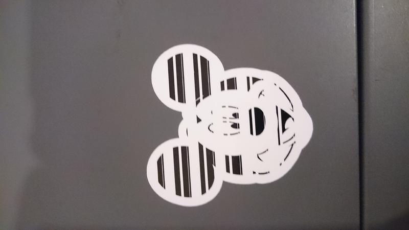

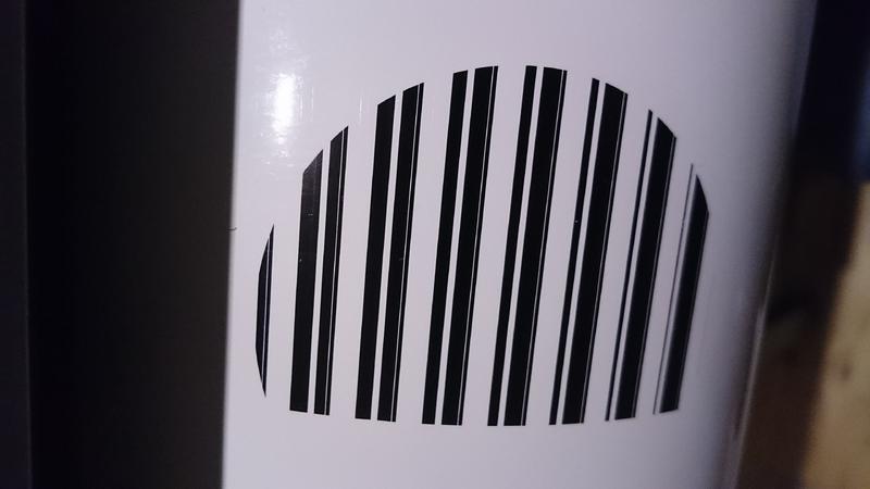

When I throw an impression I have white line on my image know how how to solve you the problem please thank you very much
rookay
I send you a picture as possible of the fact I was an example

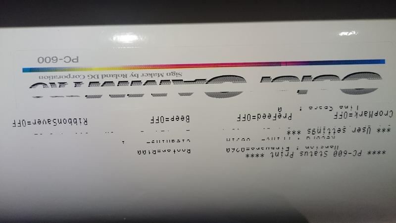

Head bathroom cleaner.
You can try and lightly sand the printhead with 1200 grit sandpaper. Sometimes crap gets melted to the head. Those heads get hot and melt the foil to the vinyl thus melting lint and dust to the head.
It wont hurt the head any more than it is now. But yes that head is probably trashed.
