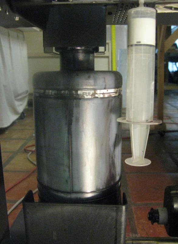

i got your white recycler right here.... :]
that is quite a list of thing. i can't believe that the white shares a cap with anything. that would be a disaster.
also, i was kinda jealous that my jv3 160sp didn't have a recycling system. then i thought..."wait a minute". this is a no brainer.
so i cut the white head line going to the waste bottle, and put a syringe with a tiny vent hole at the top. every four or five days i empty it back into the white cartridge (which is a clear refillable, don't keep your white in the factory cart!). a white ink printer, at my estimate, throws away about $200 worth of white ink a month. mine... $0 a month.
tada!

Your a clever one might have to do that to my printer :p

@jasonx
you might have to save up for the white ink recycle conversion. one thing... this should be obvious. the first time i went back to my white ink cart to replace the ink, i didn't cover the little vent hole with my finger and the ink squirted about 10 feet across the room. so not that clever.
