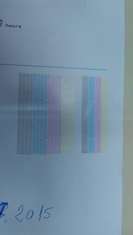

please upload your nozzle test to check so that we can help.
Bogdaniel
i will do everything i can to upload today a nozzle test but from start on black the lines some of them overlap and they are miss aligned cyan it's same.. magenta and yellow are perfect.

here is my nozzle check
