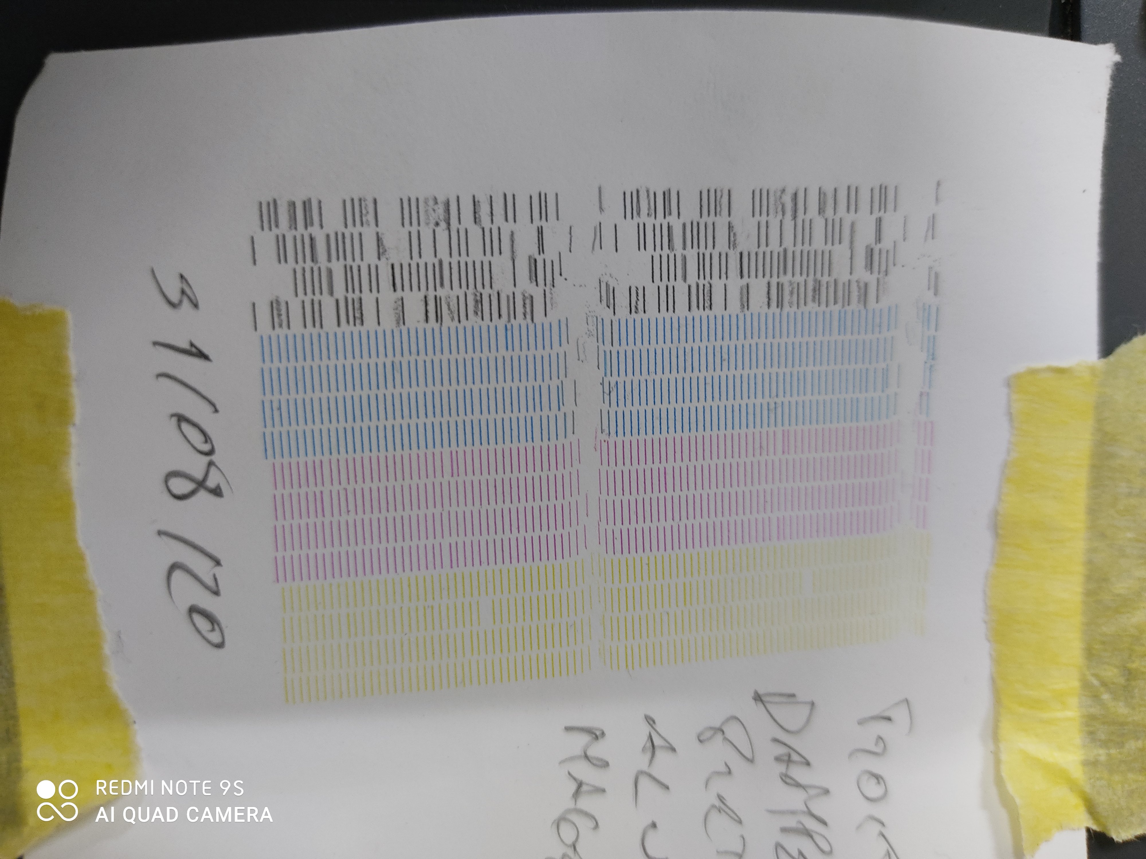

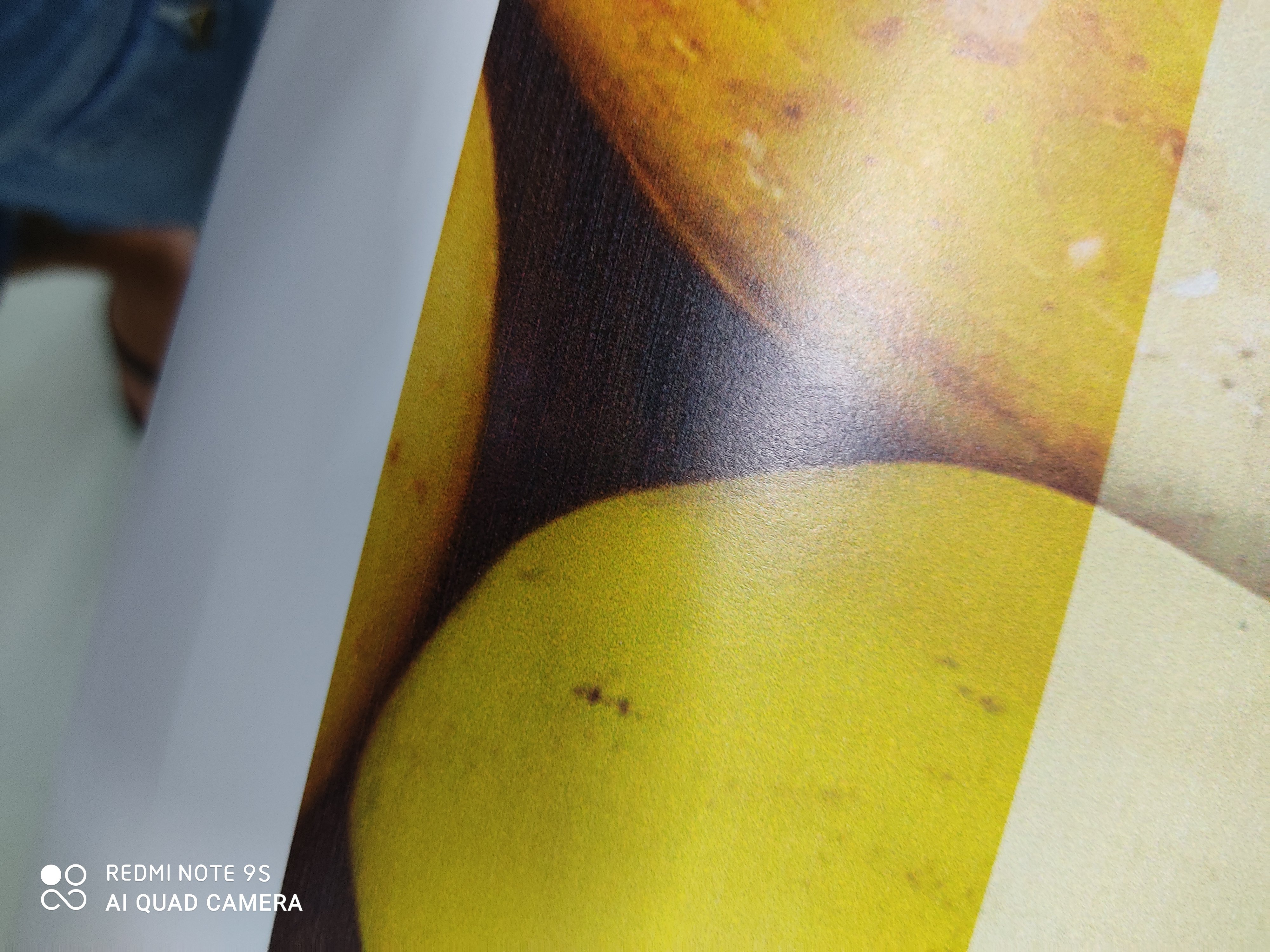

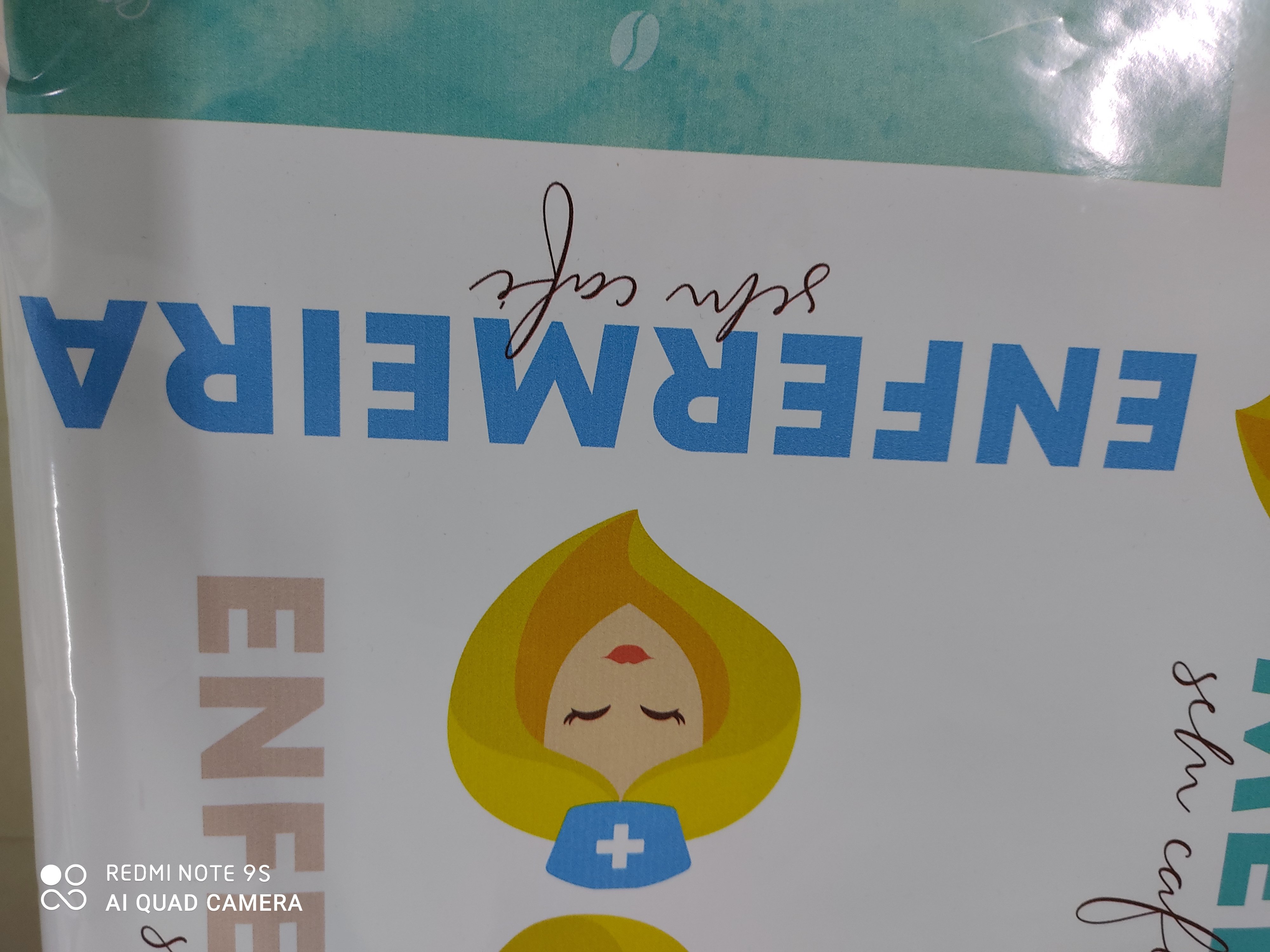

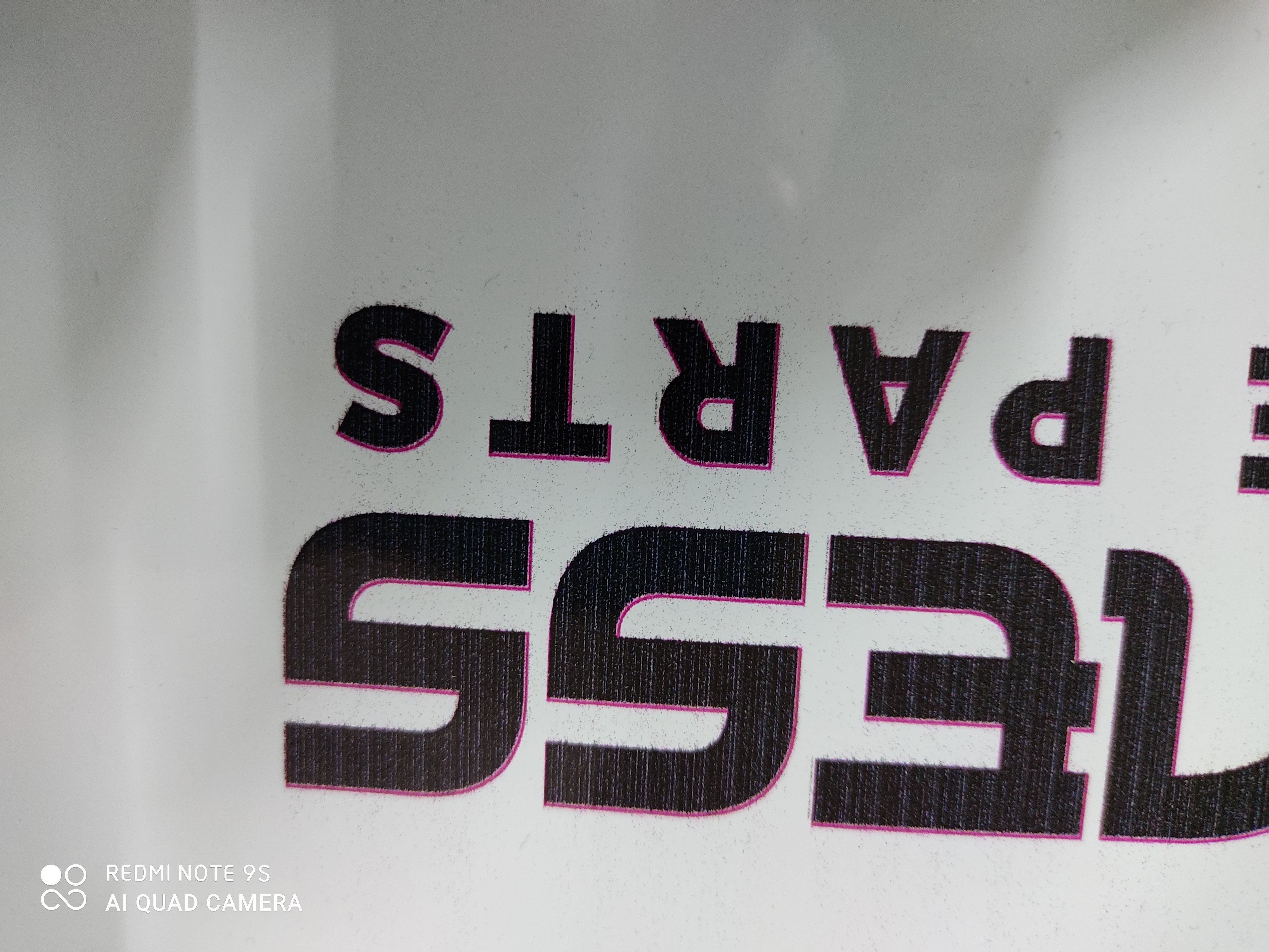

Hello Guys,
I have bought a roland sp540i that was stored almost 2 years.
It didn't fired anything, and with some cleanings I got something.
The black isn't good enough.
I have banding and fumes.
I changed, dampers, wipers, manifold.
I didn't try to adjust nothing in the setup.
I will leave some photos, and if you can give me your opinion to the next step.
I am a newbie, and I am sorry if my English isn't the best, I'm from Portugal.
Thanks in advance.

Hey,
Yes I didn't anything that indicates damage.
And the yellow and magenta print doesn't show printing any banding or other problems.
I think I have to replace the black / blue head and go from there.
What do you think?

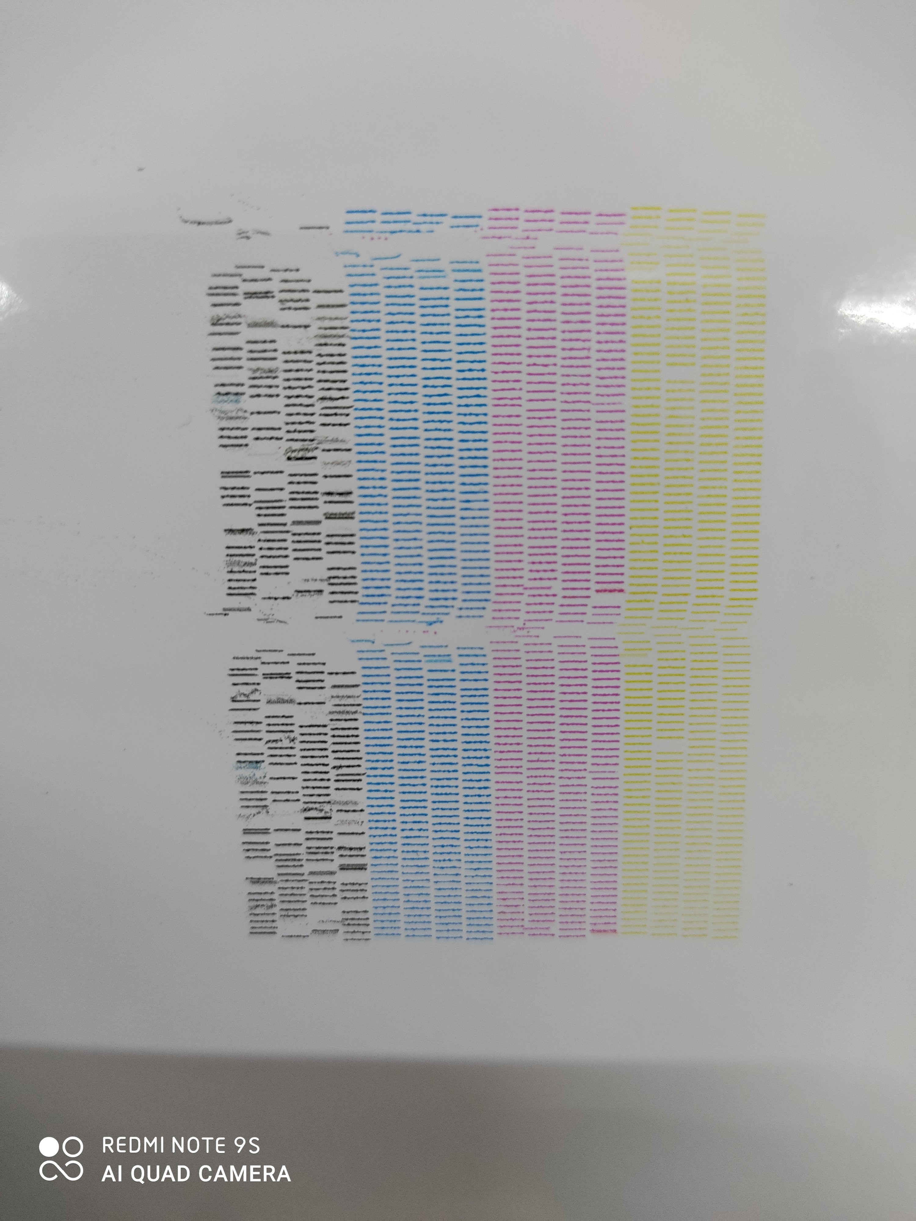

Definitely need to change the C/K head. Can you post a pic of the latest test print to show what the M/Y head looks like?
HI Jim,
Here is the last test print.
I will change the B/C head.
Is it simple?
Do I need to calibrate or update some data?
I am interest in order from digiprint for 428€, do you have any feedback?
They stated that is a original Epson part.
Thanks for the help

If the last posted pic is the most recent, I'm still concerned about head damage. Can you take a clear well light pic of the bottom of the print heads please?
You will need to do alignments with new print heads.
Which Digiprint, as there are several, some OK, others not so much. Perhaps a link to the printhead?
