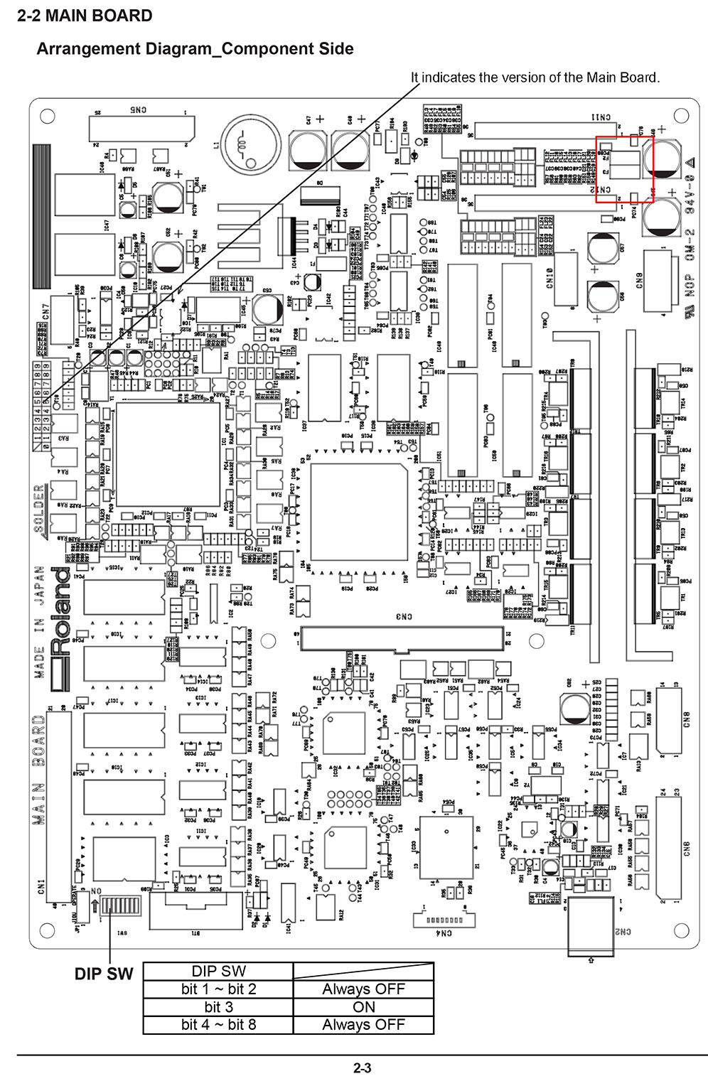

Were the fuses you tested about the size of a few grains of rice with a white center and silver or gold metal caps on each end? It's not the glass type fuses people are normally used to. When the heads don't fire it's either because there is no ink, the heads are fried, or the fuses are blown. It sounds like you got ink to the head so that can be ruled out. Heads rarely fry because the fuses protect them. So that really leaves the fuses as the issue.
Make sure the fuses you checked are those in the attached pic (look for the red outline in the pic), as these are the fuses that supply voltage to the printheads and there are only 2. If these are good, have you tried to gently pull ink through each cap individually? Depending upon that test, you might have a cap/printhead alignment issue, which is usually solved by "Initializing the limit". Let us know what you find so we can further assist you.

solvent inkjet has those tapered syringes that really make it easy to pull ink through, although when i get impatient i prefer a hand vacuum pump/break bleeder you can buy on amazon or from harbor freight or an auto parts store.
as opposed to checking continuity, i prefer to look for the 41 volts (at least in most of the models i have worked on) on both sides of the fuses
you sound experienced so i assume there is no spilled in on your ribbon cables and you were careful plugging cables in and didn't lift a trace on the cables (i have done it, more than once)

Those were the fuses I checked, but maybe I should also check for voltage on both sides, someone just suggested, I hope it is just the ink that was in the lines clogging the dampers up, because I can pull ink through the caps, but maybe it's to thick for the machine to pull it? I still haven't purchased more ink, I was looking at a bulk ink system, and even a new Roland, I got the quote yesterday for $15,500 for a SG2-540.
