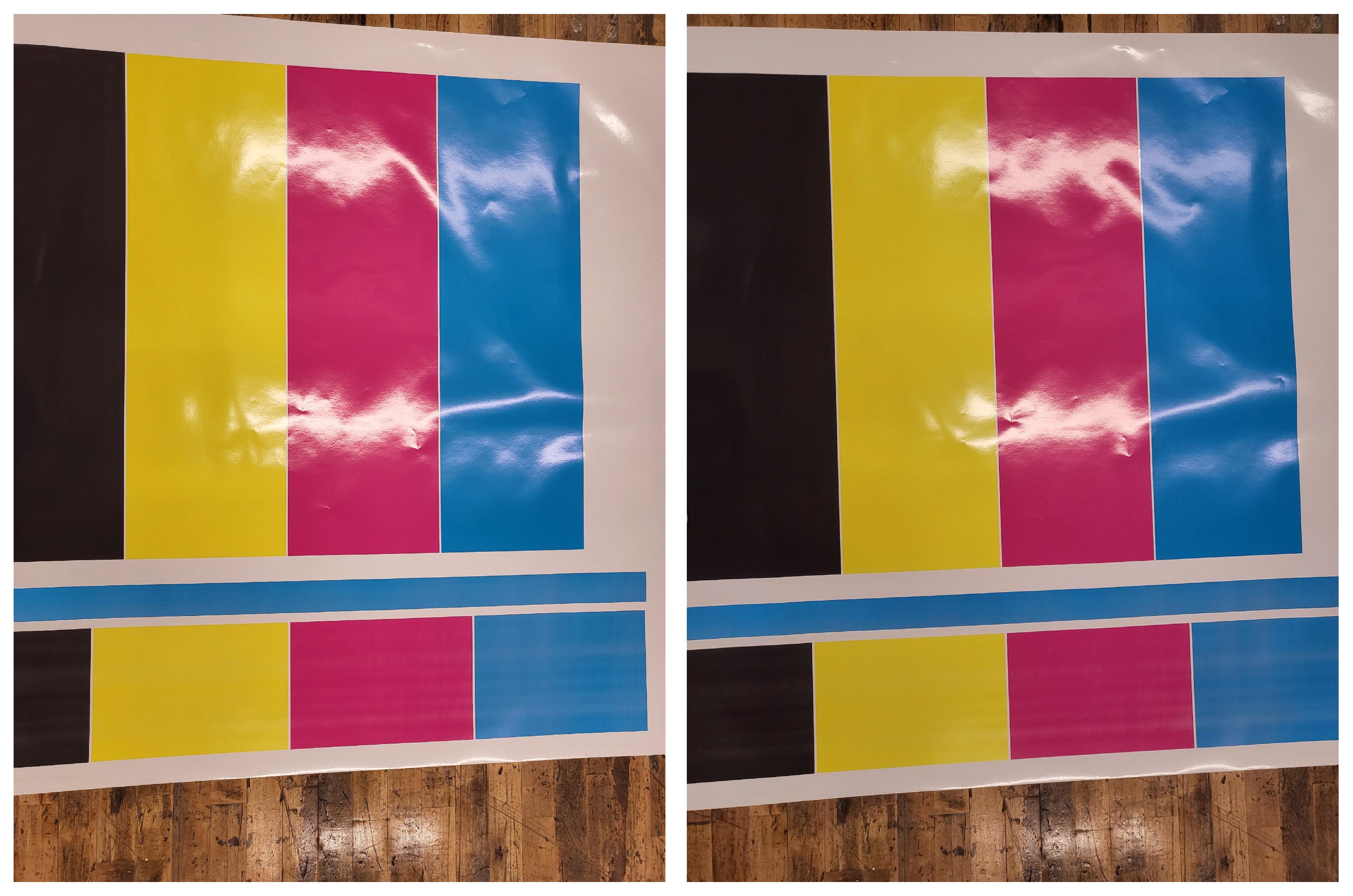

here is what I am getting... straight cmyk colors
WEC production
ok so all of a sudden I get this quality (top).. and next print looks like this (bottom) ???

whats the nozzle print look like?

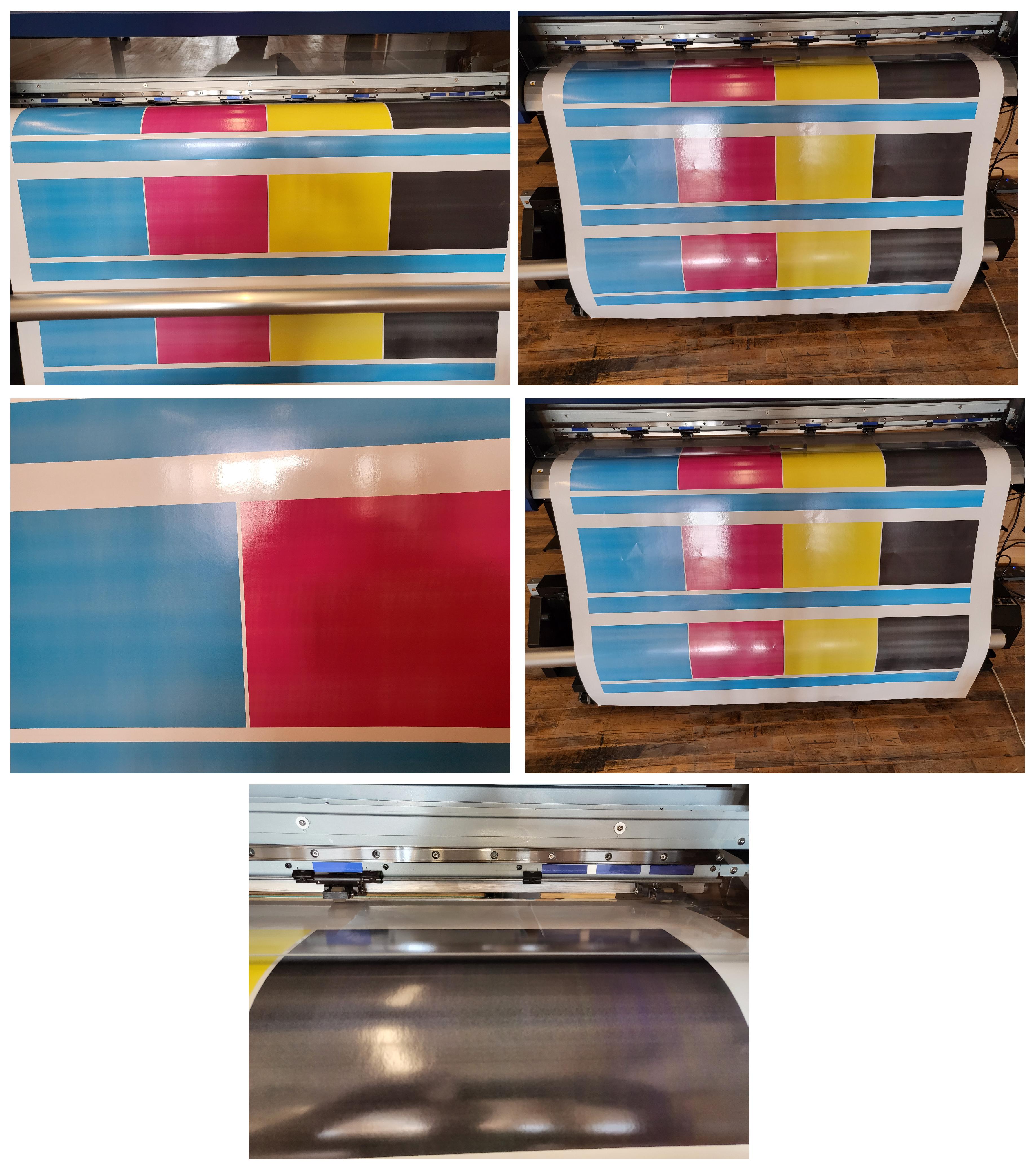

nozzle print is good as far as everything is firing. I've been running test prints for weeks trying to flush the lines/ try different settings etc. Then yesterday I got 1 good print (top) and the next run was garbage again (bottom) the bottom image is what most printing looks like
Hopefully it's humidity/static, I was having these issues and it was the profile and static that fixed my vs540 ended up printing with generic profile in my flexi and that with the static string stopped it
