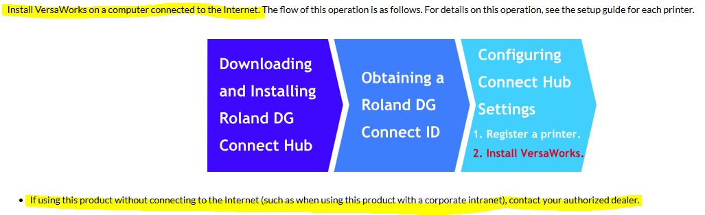

let's see cpu core usage / disk usage while ripping in 7 vs 5. It says on their website, you can contact a Roland dealer to get version 7 that does not require connecting to the internet. I'm betting it's uploading every rip job to Roland. If you're using Windows, get "NetworkTrafficView" program.

if 5 and 6 are ok than no stubbynecks on my system. Installed 7 offline from files downloaded, runs offline but requireds internet connection to connect printers for the first time I believe.
thanks, ill check on that.. ;)
