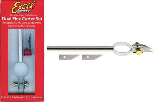

an extremely less crude example of what I was talking about

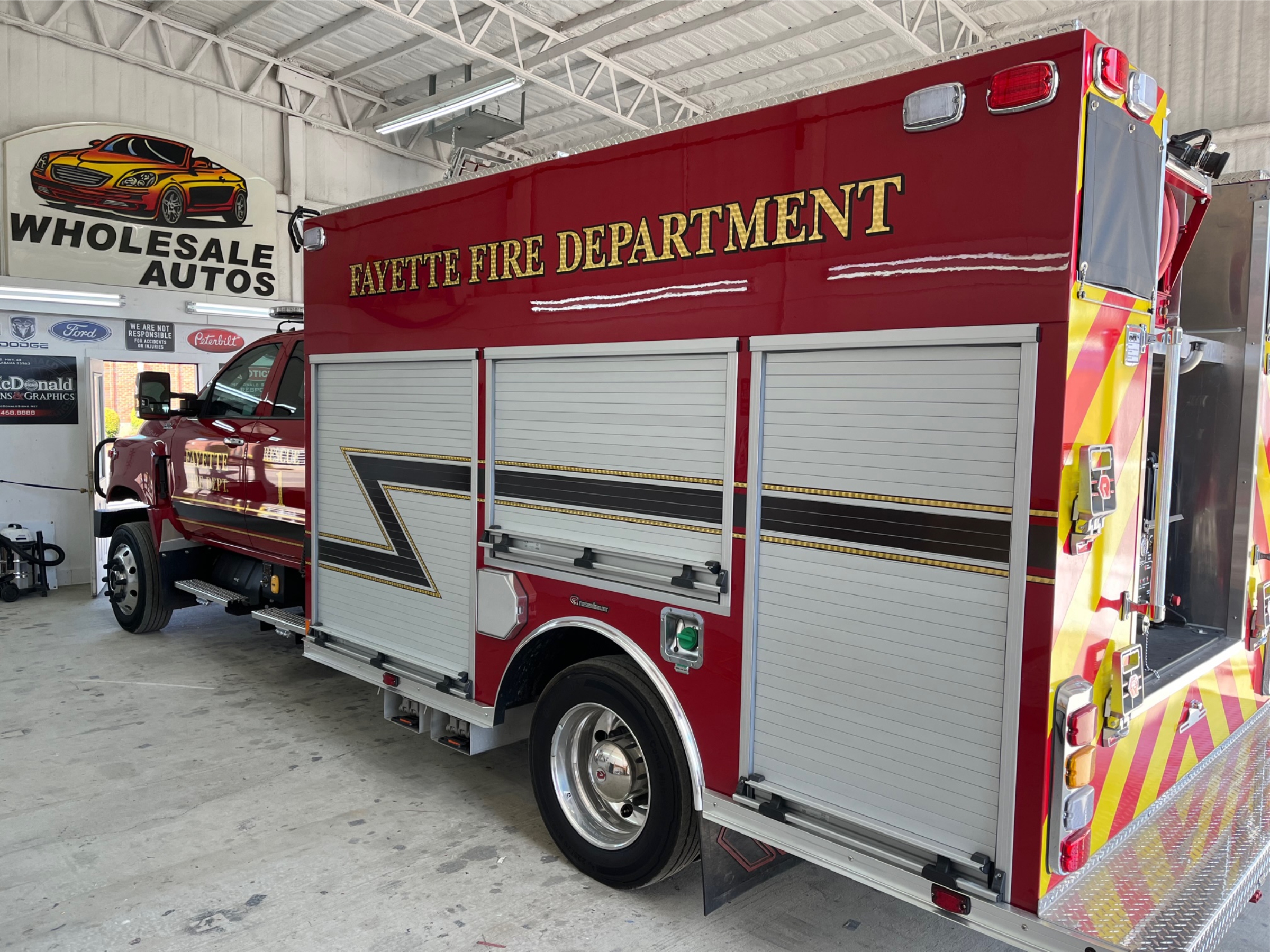

We just did this fire truck with some striping on these roll up aluminum doors. Just Applied stripe decals normally in one piece then trimmed BOTH top and bottom of each slat with a sharp exacto knife
turned slightly down on top of the slat and slightly up on the bottom of each slat so decals wouldn't peel when rolled up. Went thru alot of exacto blades and it was time consuming on this job but it worked. Slitting in between slats
and tucking would make the decals peel later on.
