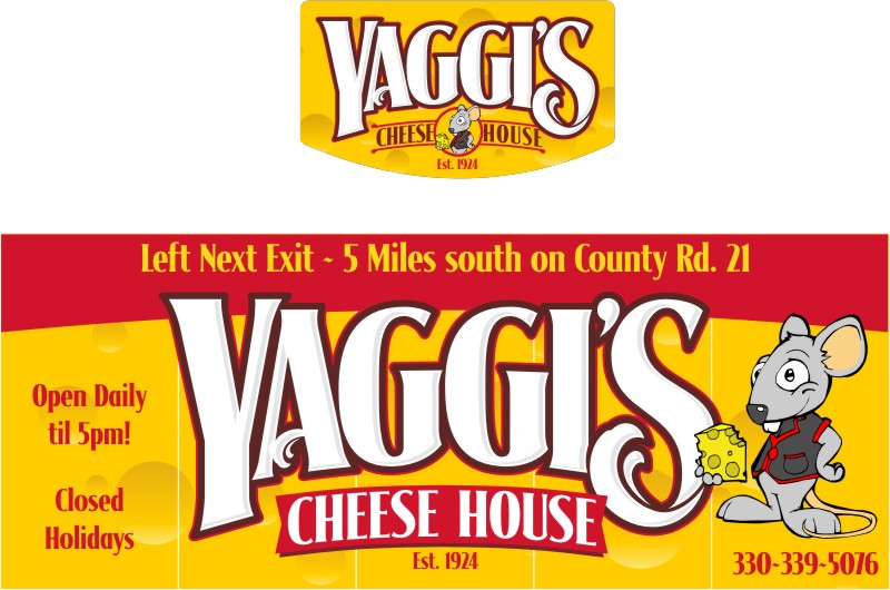

Here's the plan... The billboard is out by the highway and the smaller sign is by the main entrance road. The billboard sign is in great shape. Whoever did it the first time knew what they were doing because they painted all edges and even the backside of each panel. The paint is in excellent condition minus the fade, but will still do some light sanding over the whole panel to make sure everything is in good shape. That's a good thing because those panels would have been a mother to replace.
