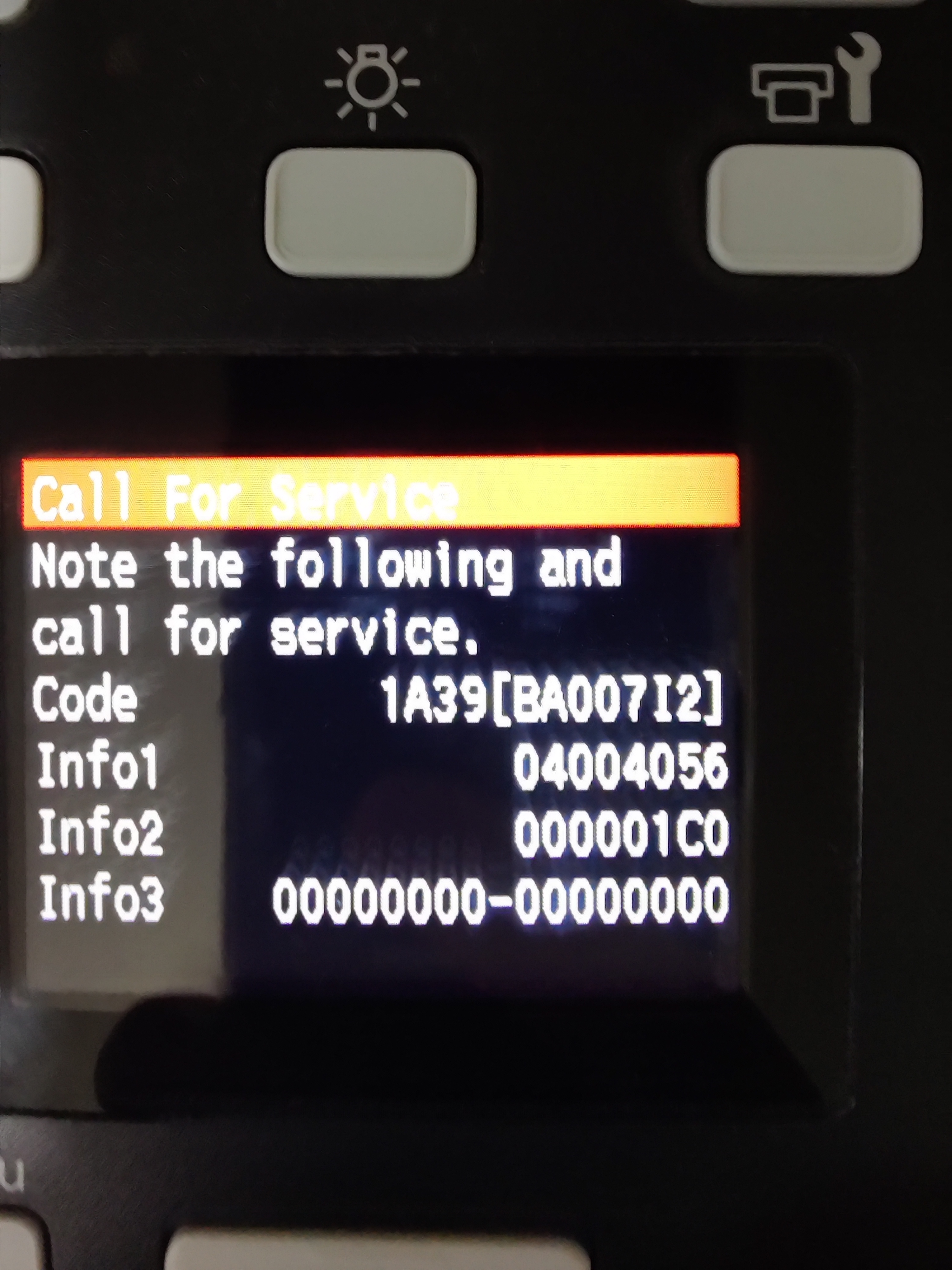

Hey guys, so yesterday I had a power outage while printing and now whenever I start a print it gets about 1 minute into the print and then gives me this error. I've tried it many times and it seems random. Sometimes it gets 5 minutes into the print and other times it stops immediately when I start the print

you hopefully blew a power supply source, as opposed to damaging the main circuit board.

See attached. I can't help you any further than this as Epson doesn't give board layouts or schematics. I would suggest you look for any fuses on the mainboard and test them. Good luck!

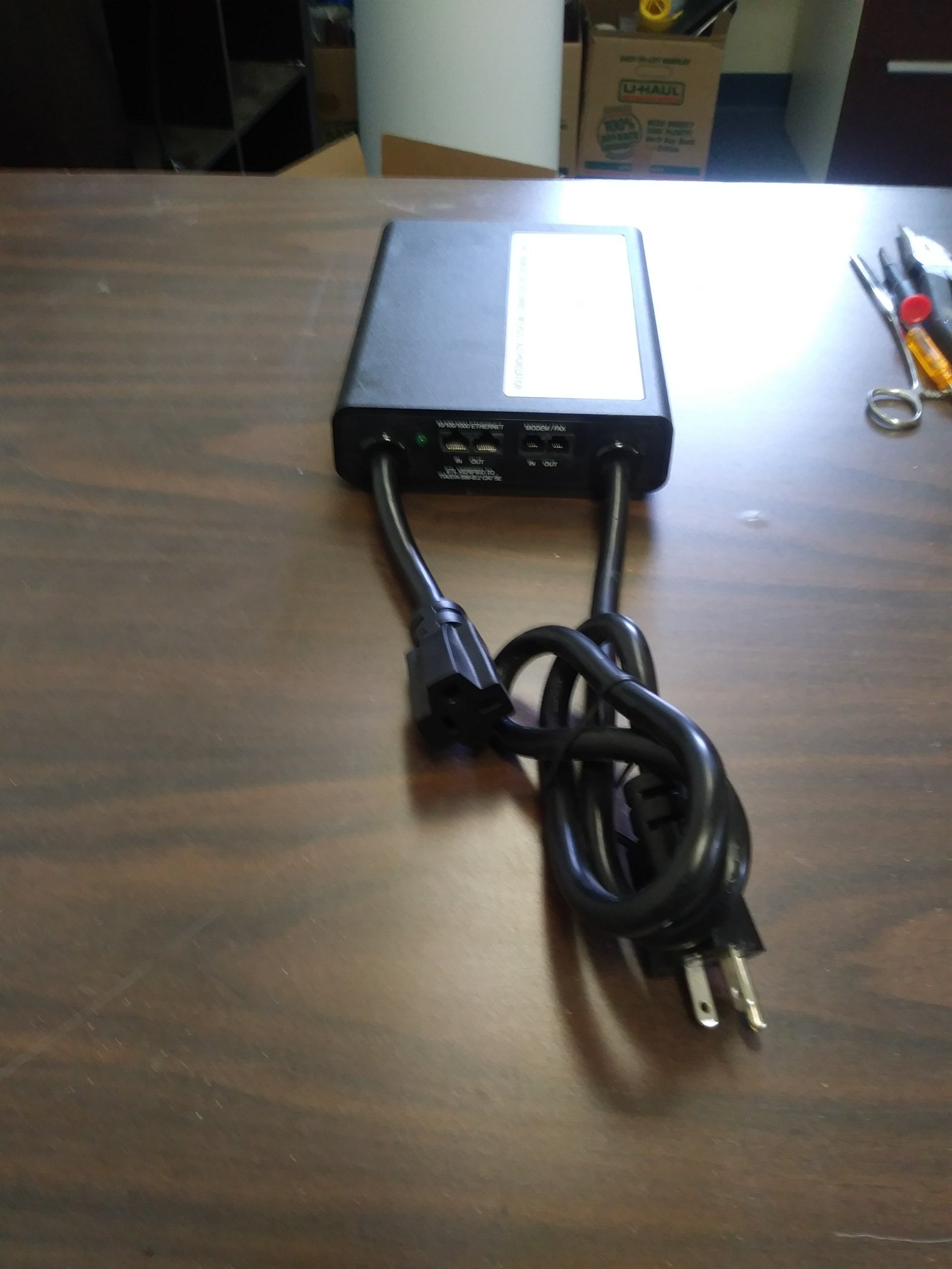

the best thing ANY OF US can do, is go on ebay and buy a commercial surge protector, the type that comes as part of the install when you lease a copier.
ricoh, for example, will not cover a copier that is not protected by one of these (see picture) they are generally ~ $50. on ebay ($200 new)
i try my best to protect all my equipment. as our country's energy policies get more wrong-headed you will have more power outages. add to that lightning storms, static discharge from walking across carpeting. these devices also protect the network interface (RJ45)
better to spend $50 now, than end up on the hook for $2000 plus the down time or increased costs of using a wholesale printer

OOPs, i went on so long i forgot the picture

Kelcy Deeds
Hey, yes, i had assumed it would be something along the lines of a power supply unit or something. Now im getting the error "Plug in #2 Power Cord" when i try to turn on the printer. I've also always done my own servicing due to living in Belize so i'm trying to pull out the second power supply now. i pulled out the one and i noticed there was a fuse on it so i took it to my local electrical guy who does circuit board work and he said the fuse was fine and the rest of the board looked good. gunna try to pull the second one out but its so dang hard to get to. Thanks for your, help, will keep you posted
Case
It's the printhead... Most of the time on these models of Epson it is the printhead and not the mainboard....

That is a print head error, very rarely can be a main board, I am an Epson tech and can get parts. That head is around $1900, not terribly hard to replace although there is are some parameters printed on the print head that is to be input from an adjustment program that is available on Ebay. Make sure to unplug the printer and hit the power button a few times to release any left over voltage before working on these printers
