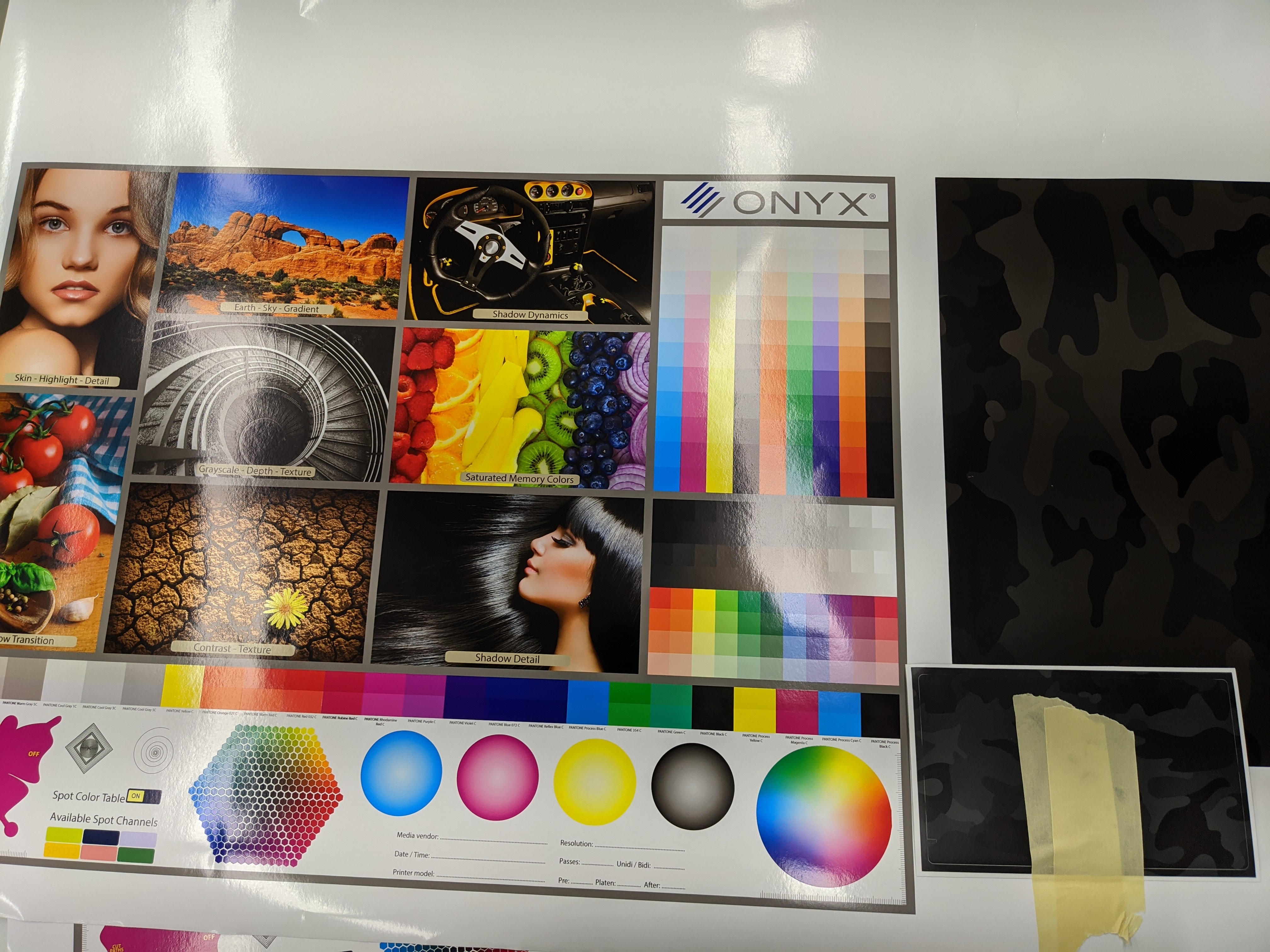

I blew up the new print. And I don't know if the photo shows it well.
Marshal,
I’ve looked at your photographs and compared the evaluation image to my copy. It appears the yellow is heavy (easy to see in the grayscale staircase and the spheres on the lower right) which explains
the warm tones in the grays.
So, properly recalibrate or properly create an ICC output profile to correct the issue after you've made sure the proper workflow setting have been made.
Know that most shops routinely image control files in order to notice quality control issues well before production volume gets delayed and cause headaches. From the first paragraph after the heading “How to do Recalibration” from the Onyx guide…
“Although Recalibration can be done in Media Manager, it’s probably more convenient for the printer operator to do this in conjunction with daily job submission work. So Onyx has added a toolbar button in Rip Queue to do recalibration right from the queue.”
