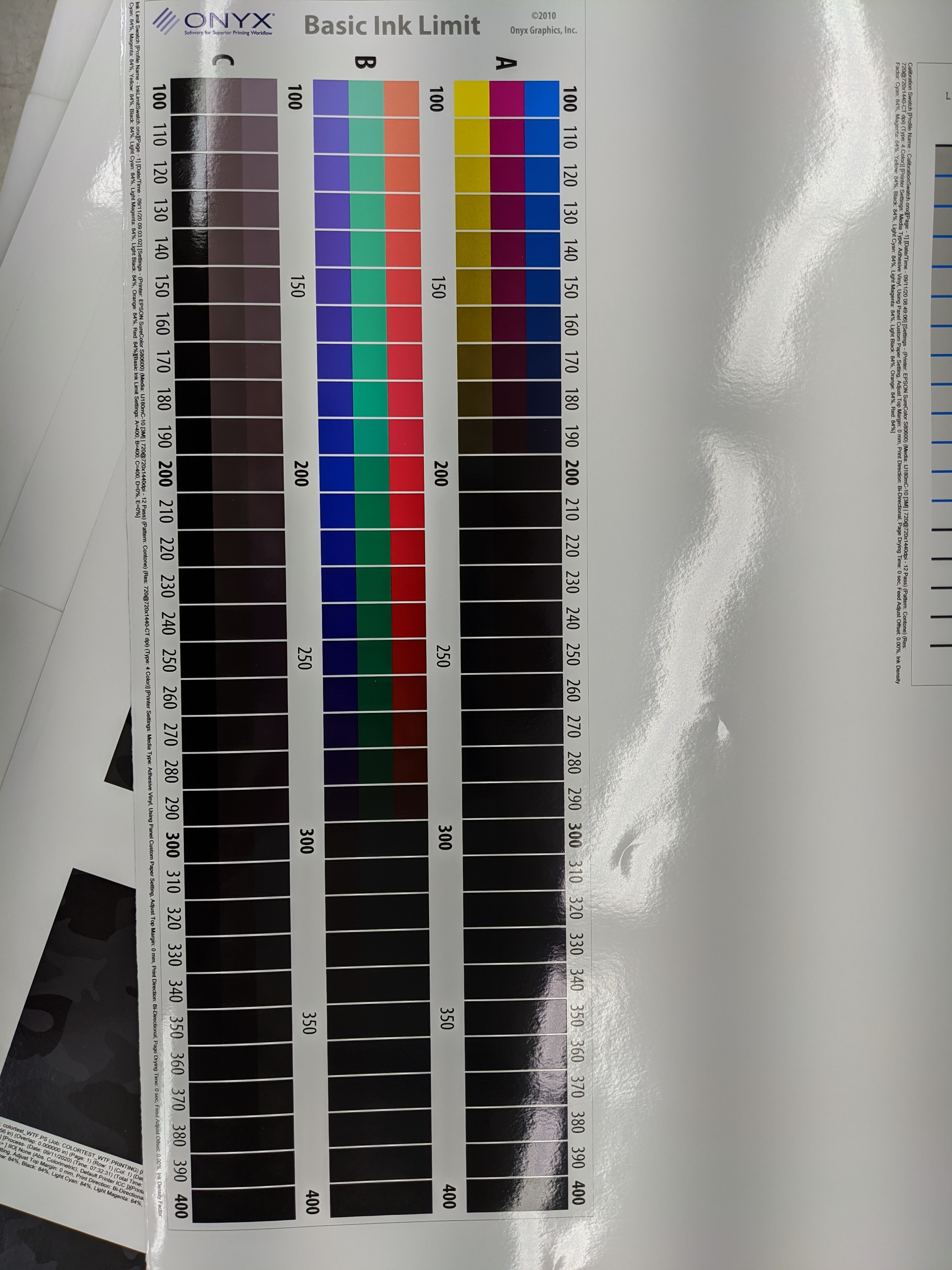

which I'm trying to do, and have tried many times before with crap results. One spot I always get confused on is ink limits, I never know what to set it at after printing. There's no artifacts or anything like the help docs talk about, it prints from solid color to black. Do I pick the highest point of each section where it turns totally black? Or the lowest?
Marshal,
Apparently you're not one for guides or manuals.
However, pick the highest before it turns to black. If you were to take the time and experiment by setting unrealistic ink limit values of both high, and low, you would discover the surprising and relatively little impact those values would affect. The ink limits step is rather forgiving and that's why a hardware device is not necessary.
The basic goal here is to not waste ink where the color does not resolve and to not flood the media to cause puddles.

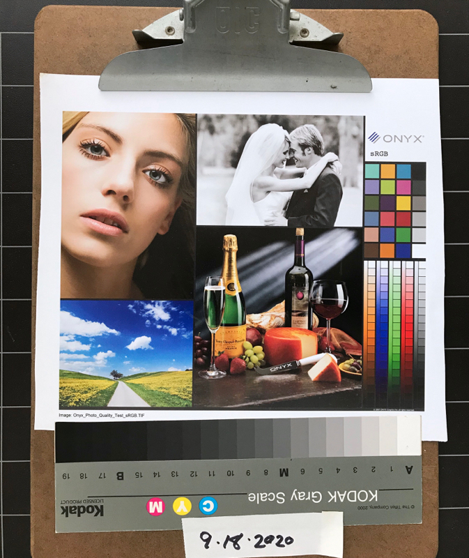

Can you mimic this test on your end and upload a photo without glare? You should find the file somewhere in the Onyx folders. If you don't have a gray scale, use Cool Gray swatches from Pantone.

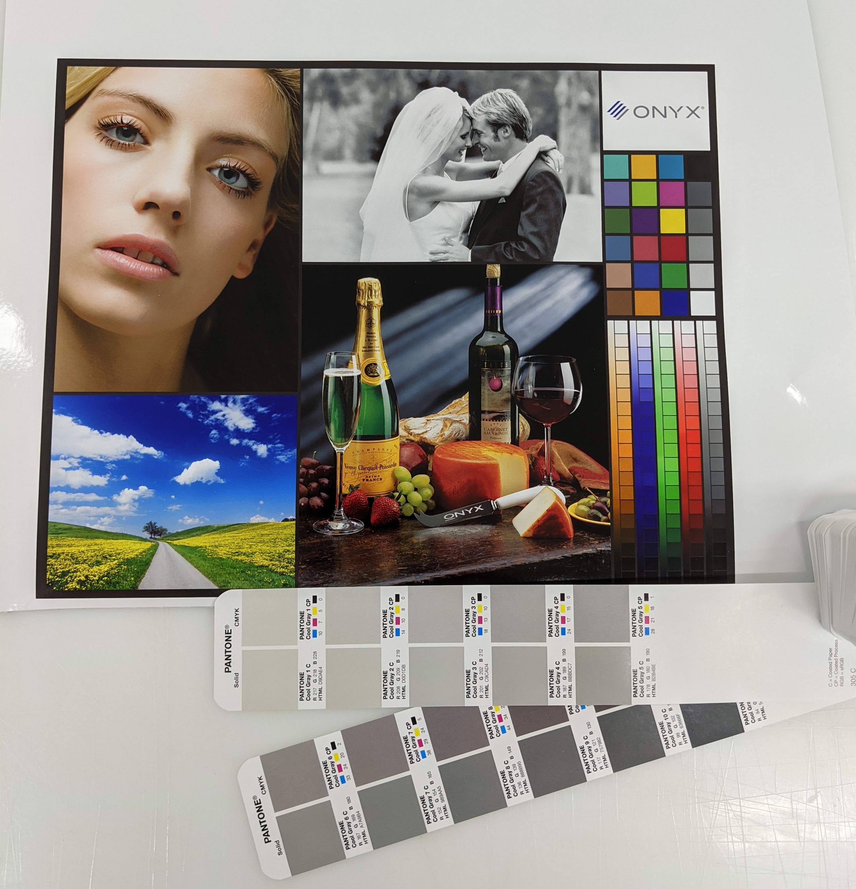

Much if the image looks better in that picture than it does to the eye. The colors are muted compared to what I know this printer is capable of.
Your thread title is "S80600 grey turning brown"
Do you consider these grays to be brown?
