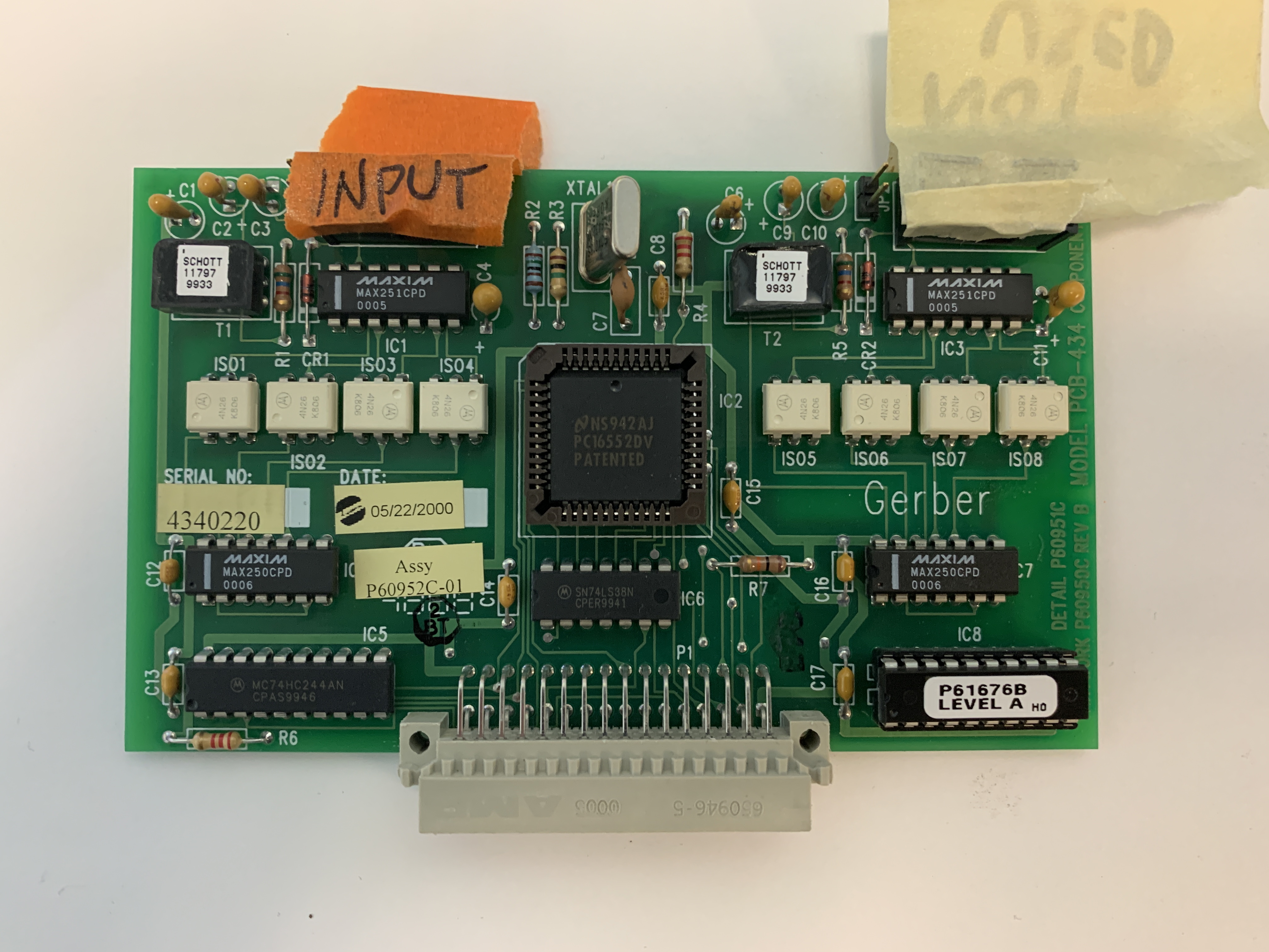

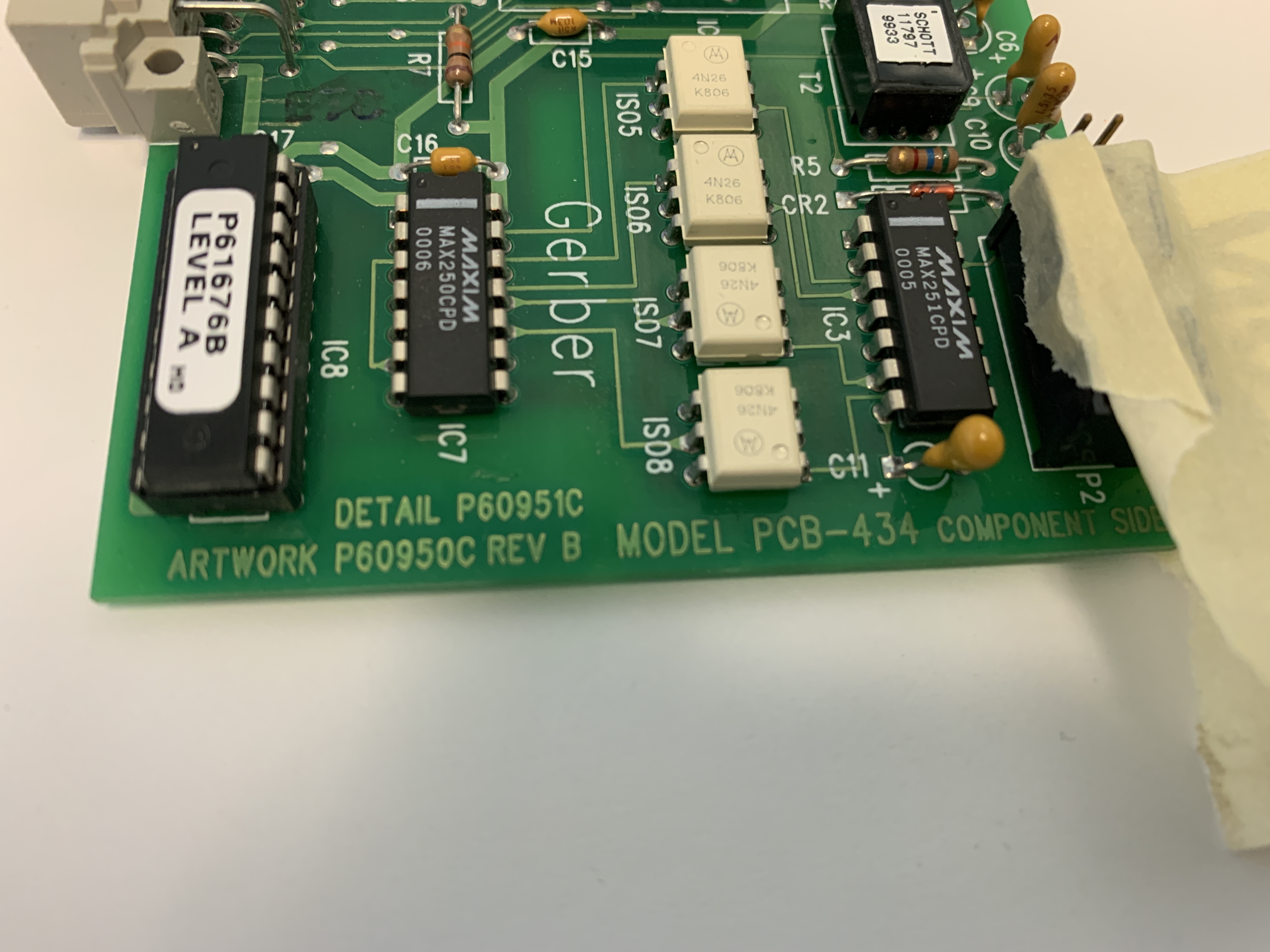

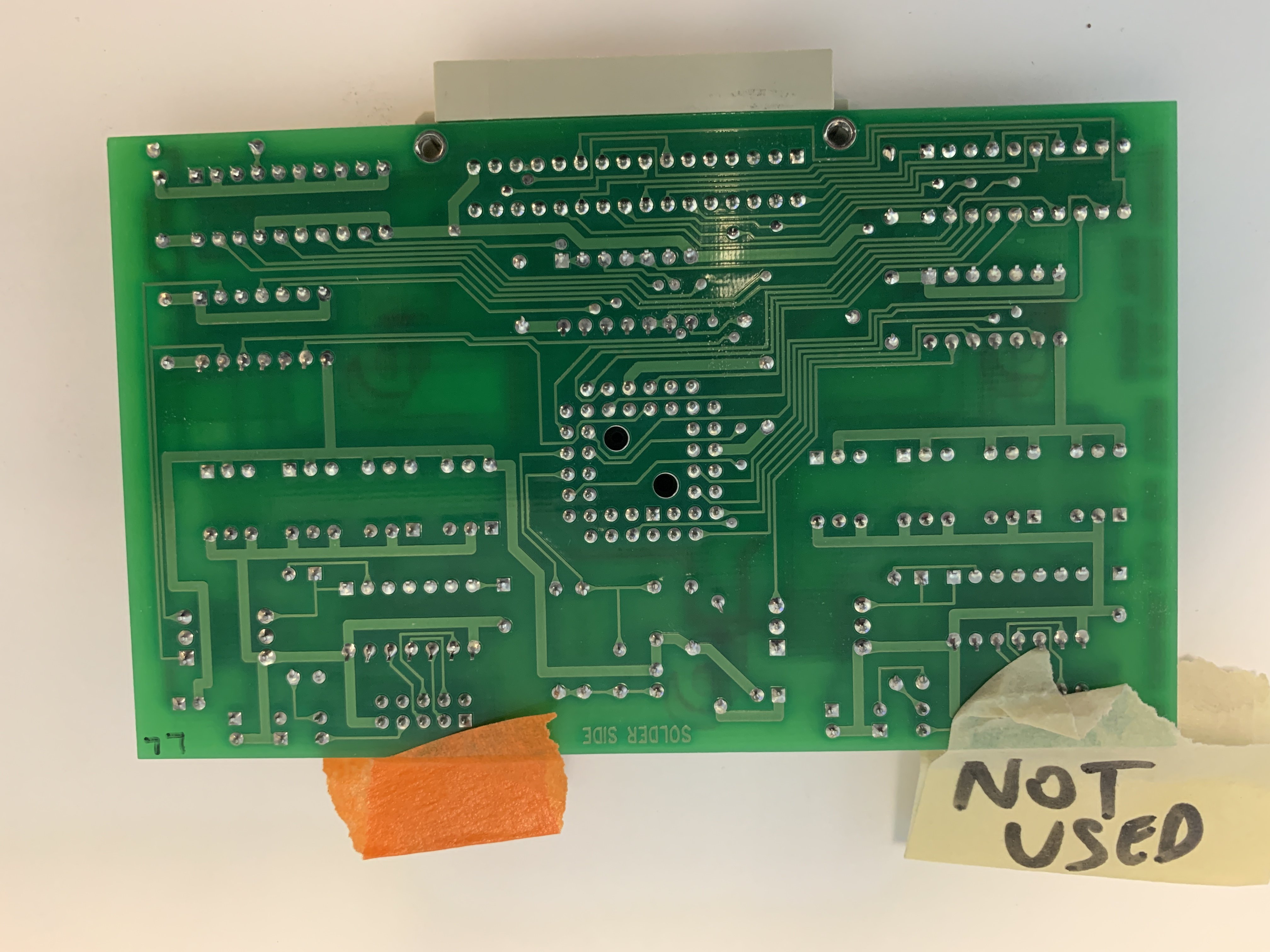

Hello, I'm a first time poster and need some technical help with our Sabre 408. We came to work last tuesday like any other day, turned on the Sabre, warmed up the spindle, but when we tried to send a job from Artpath we got no christmas lights showing on the sabre keyboard. The day before it worked just fine, no issues, and we turned it off at the end of the day like any other day. We got a technician to come and take a look and they checked the PC, software, serial/usb dongle, serial cable, visually inspected all the cards, tried their own laptop with latest software and drivers, no error codes, the spindle moves (manually using keyboard), but nothing helped. They called around and another technician advised that due to the cold weather in Canada and all the furnaces starting to work, there is a high chance that low humidity caused a static discharge and damaged a particular PCB board (shown below). Tech called Gerber and they said this is very common, they had 3 fails this season, and Gerber has non on hand until January 2022. This card visually looks in great shape (see photos).
Has anyone here experienced a similar problem? Could it be anything else that we have not thought of ?
Can anyone recommend a place that might have these cards in stock, new or refurbished ?

Adam.Foster
P60952C is the DUart card - Comm between E-box and spindle controller & ATC if the machine has one
P60947C is the Uart card Comm between the PC and the E-box, this card is on backorder.

P60947C is the card that has to be replaced here. The tech just pointed out to the wrong one inside the box, but quoted on the correct part that needed replacement.
SOLVED!!! just wanted to let everyone here know that in case this happens to anyone else there is a tech in Edmonton that could potentially repair the card. This technician also pointed out that this could happen again. It order to minimize the chances he recommended keeping the humidity up in the cnc room with an ionizing humidifier, grounding ourselves to eliminate any static discharge before touching the equipment, properly grounding the cnc and dust collection system.
I do not want to publicly post his information here but if anyone needs it please privately message me.
