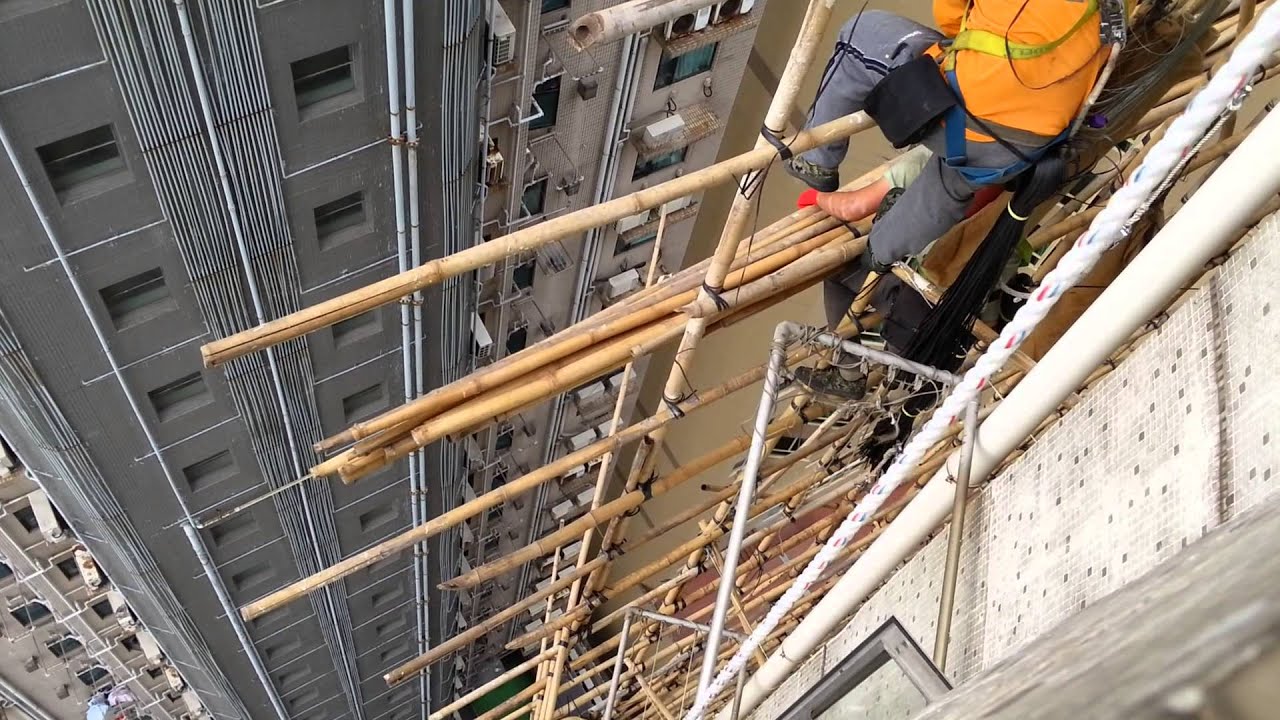

If you're scared, call these guys
petepaz
Yeah, but can you do that over 20' in the air ?? I wouldn't want to. I have several of those aluminum walk planks and 3 sets of those ladders, but I ain't doing it 25' up there. Hmmmm... maybe if I was younger, but not anymore.
i offer solutions not safety ;)

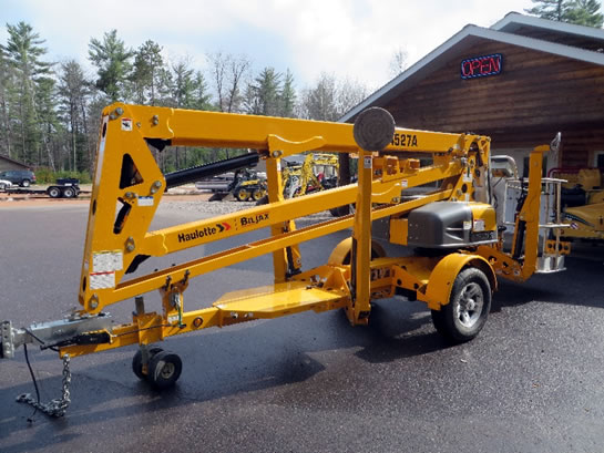

I rented one of these small towawable MEWPs this spring to install dimensional lettering. You simply un-hitch it from your truck and roll it right in the showroom.
They have pneumatic tires and you can put carpet samples under the stabilizers. They're extremely "floor friendly" and fun to use. Around here, a fuzz over $200 will get you an 8-hour day and the security of not having to mess with a ladder or scaffolding.

Around $300 in my area. Great rate.

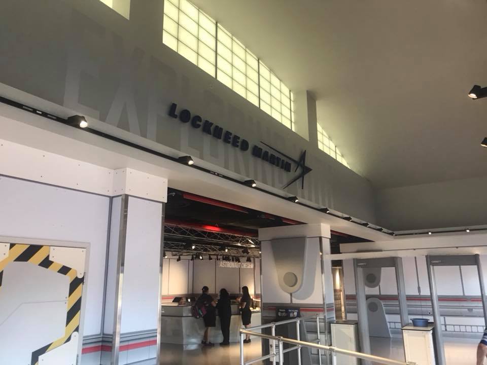

You need a single man vertical lift.
It will take a bit of getting used to how to use its small footprint in the space, especially at such a height, but it is totally doable and much preferred over setting up scaffolding or old ladder and planks.
They do have them available that do not need the massive outriggers. The ones I have rented from United Rentals have been Genies.....
Due to a similar issue with flooring and available door openings in this space, I had to use one for this project last year. Even with the 4' "soffit" popping out just below the wall, the one man lift gave me enough stability to lean and touch the surface. I also used one for a 35'-45' ceiling atrium wall wrap......on a concave wall surface.... You just have to get comfy with the movements as you go along. Have to lower the height down below their "safety height" to move it, then bring it back up again.

Thanks! I don't like scaffolding and I have used these before in a school and it did just fine.
