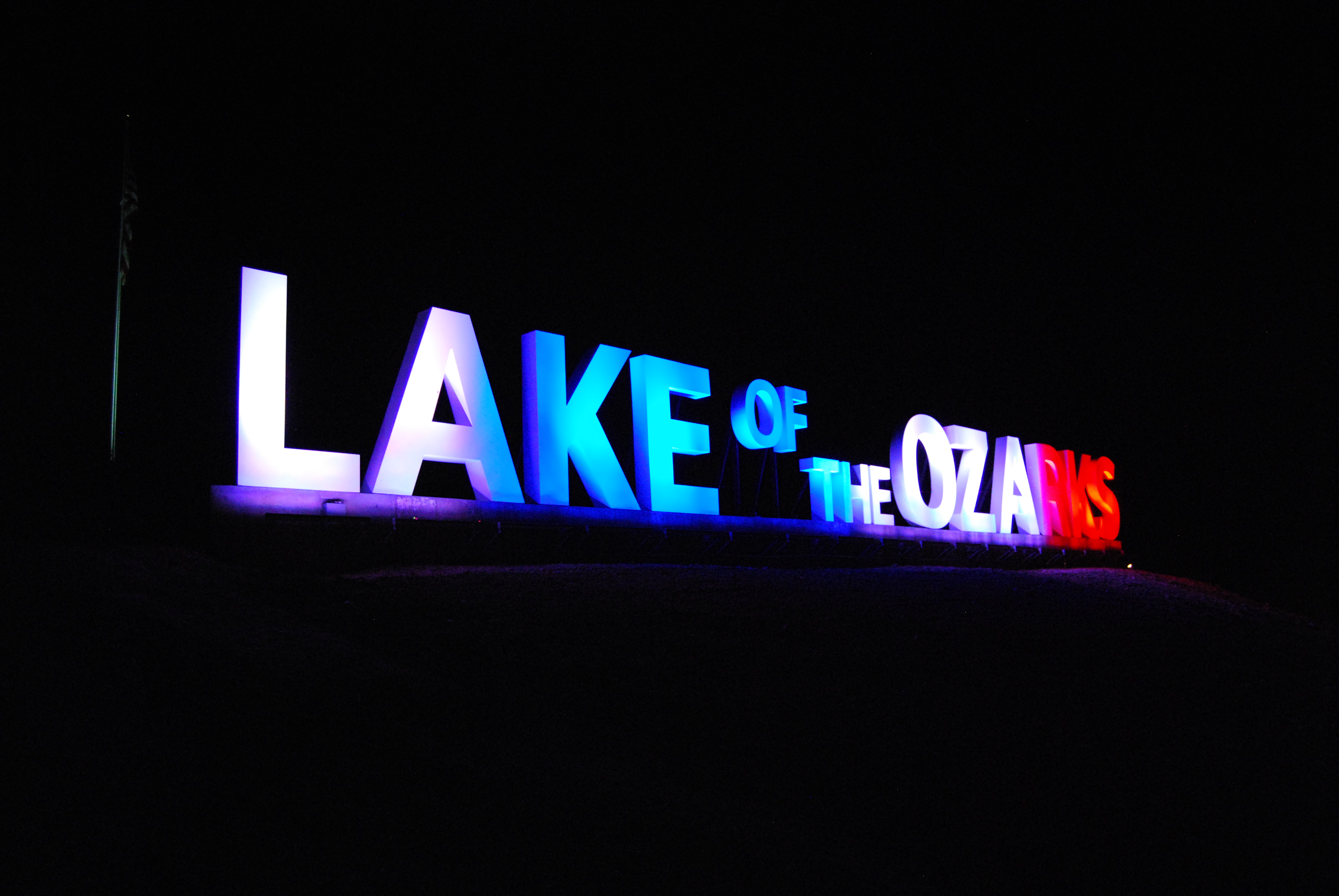

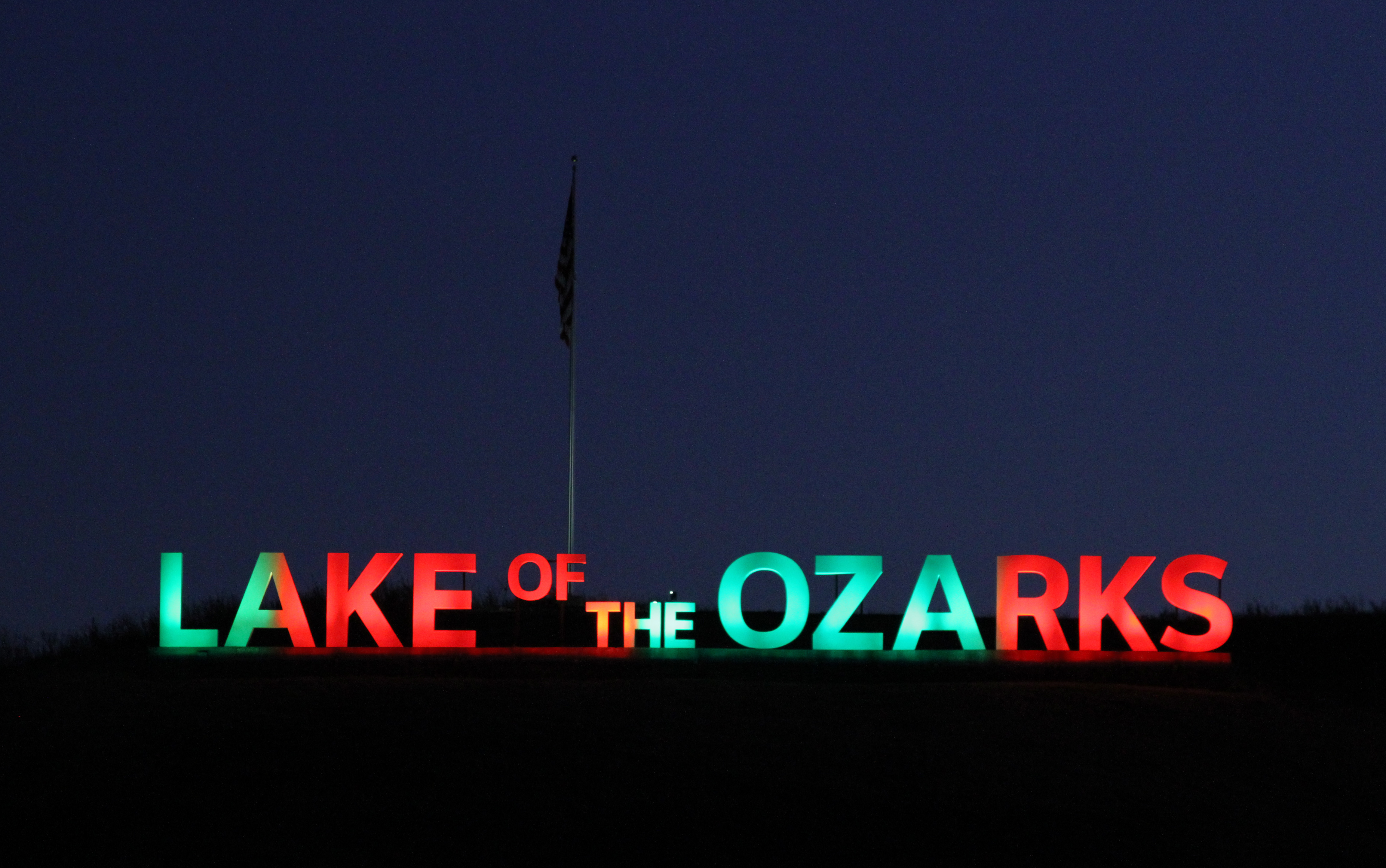

When we did these for our town/area we made them from .125" aluminum. But they are 8' letters installed on a hill and they aren't for people to climb on.
