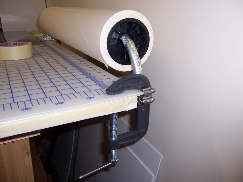

application tape on rollers mounted to the table... i can mask the whole length of my 16' workbench with 48", and there's room under the rollers to slide already masked sheets... and keep the web going, if necessary! Longest ever has been 48"x 30', solo, but now I just use my laminator to mask large jobs like that.

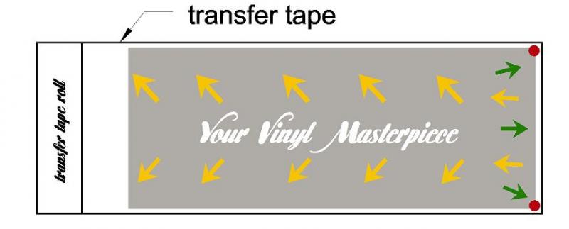

Okay this is what i do and it works very well. I get a wrinkle sometimes, it happens, but about 95% of the time none. heres some directions to this quick sketch. Start by pulling out the Ttape to the edge of the graphic being carefull you dont touch the graphic yet. set it down in the corners and press with your thumbs (red circles) making sure you touch the graphic and the table with the tape. now you should have a nice tight Ttape sitting above the graphic. start with the green arrows and get about 6-8" down. The Ttape should overlap the graphic at least an 1". if not you wilhave to put your hand down and hold firm so the whole thing doesnt slip away and you have an aww sh&&. Then go the other direction working from the center outwards in a diagonal direction (yellow arrows). continue this all the way to the end. its take practice for perfect. but youll get it. I never tried the big squeegee, sounds good but i guess i never really felt the need. I just did 2 24"x60" graphics this way with no wrinkles in less than 10 minutes with weeding. Hope this helps, a vid would be better.

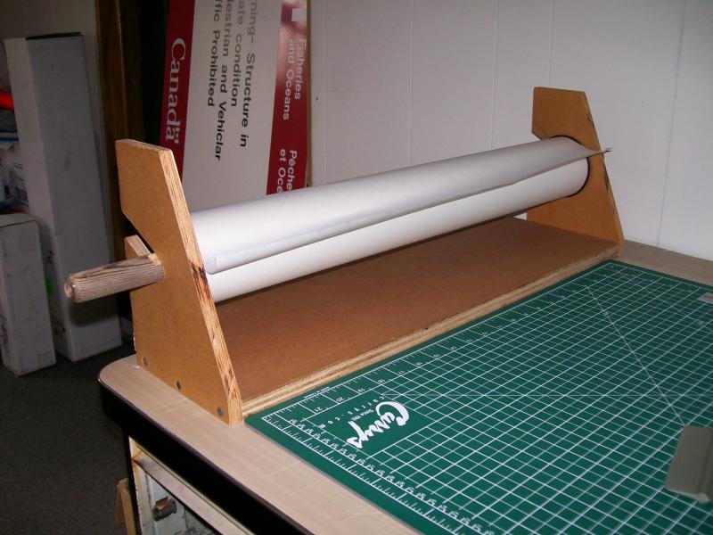

Very similar to others. 1/2" mdo for sides and 3/4" mdo for base... easy as pie!
